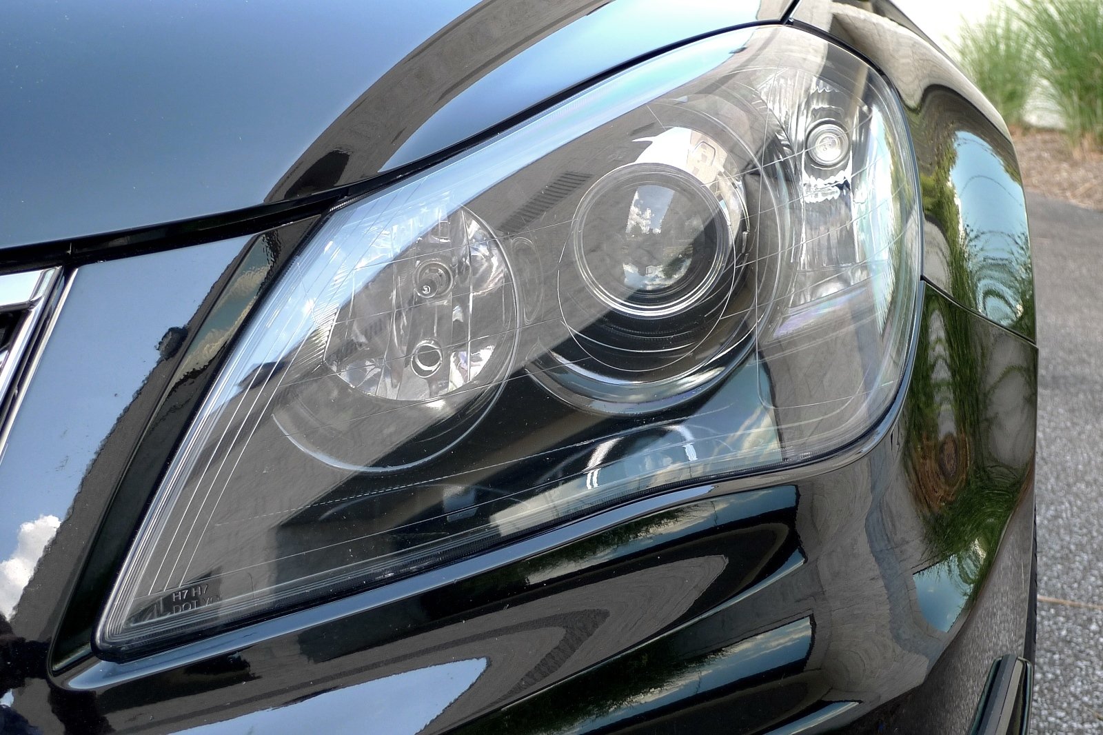

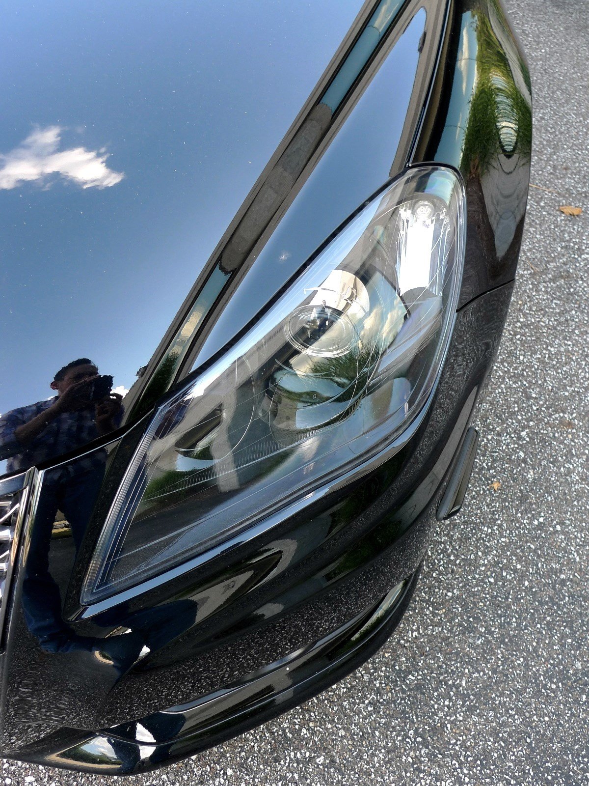

I just completed a DIY headlight project with and HID retrofit. Did the whole 'shake and bake' process to get the lights apart and shoot the bezels in black. (I left the reflector bowls chrome for function). They came out well (used high temp paint with 2K glosscoat) and I think they look phenomenal on a black car.
Wondering who'd be interested in the set, including the Morimoto XB35 (5000K) retrofit. Given the price of OE lights for this car, I'd have to get some solid dough. I don't know of a way to get blacked out lights unless you're willing to do this yourself, so it seems justifiable. There's about 20K miles on this set of lights, but they look fairly new.
I'll snap pics of the lights if any interest is generated. I don't even know where to begin the price, but I'm thinking something along the lines of a new set ($450). I've yet to even find used ones for less than $250 a side, but I'm sure I'm not looking in the right places. Between the custom work and the $170 in Morimoto gear, it seems a fair starting point. If I had the option to buy them for the cost of new lights .. I'd have jumped on it.

Looks great. However, I'll have to say the, "technically..." comment.
Technically, this is not an HID "retrofit", but an HID kit installation. A true "retrofit" is where you get proper HID-specific projectors and install them into the Kizashi's halogen-intended headlights. The projectors in there right now work with an HID kit, but are actually designed for halogen bulbs, not HID. A true retrofit will take the projector lens from a HID headlight and install it into a halogen headlight. The result is the optimal light throw for an HID bulb which is far crisper and sharper than a HID bulb in a halogen projector. The Retrofit Source (the retailer of Morimoto HID kits) sells components for a retrofit project.
Also, can you specify what you mean with the "LED/DRL"? I'm thinking you mean like a LED strip or cluster within the headlight. The reason I want to clarify is because the Kizashi's factory DRL set-up is to use the halogen high beam bulbs at low wattage. I've once experimented with a LED conversion kit to change the high beam bulbs from halogen to LED. While they were bright and all for both high beam and DRL use, they didn't reflect the light properly in the headlight to throw the beam adequately to serve as a useful high beam.
All that being said, I think a black-out headlight with a HID installation for $450 is a very decent price. The baking process and even the HID installation takes considerable time and effort yet you're offering a plug-and-play set-up for a purchaser.

Yeah, retrofit is a loose/incorrect term. As you noted, I simply threw the 35W morimoto kit into the low-beams when I had them apart as that action circumvented the hassle associated with manipulating those damn retainer clips helping to justify the expense. I'm glad I did. I couldn't be happier with the output, and I had no issues with the hookup. Only been rolling 'em for two weeks, so I can't comment on durability.

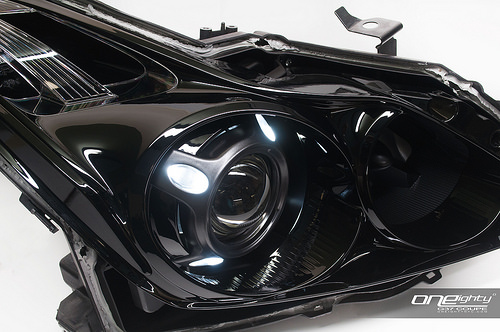

Man, I'm so enamored by what those guys at one-eighty are turning out ..

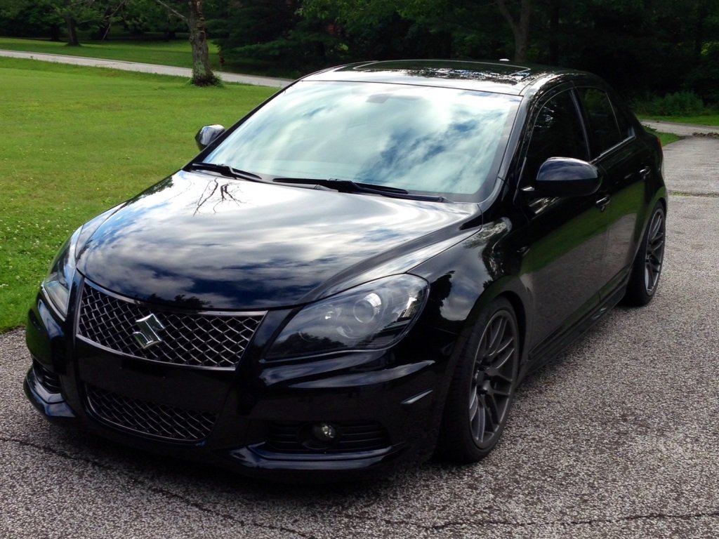

Well, I've got the Morimoto XB35 5000Ks in my Kizashi for about 1.5 years and they've been solid. I didn't bother with a projector lens retrofit and simply put the kit into the headlight as is. It's still a good set-up and the output is impressive. The only issues I've had are very minor; You can see a small return wire shadow if you look really carefully and my HIDs flickered slightly with my old dying battery. With a new Interstate battery in, my HIDs are totally solid again at idle.

Also, your wheels look dope. Your car is like a murdered-out version of mine.
Seriously! Love the whole car. I always wondered what a sport would look like without the chrome--just mean!
