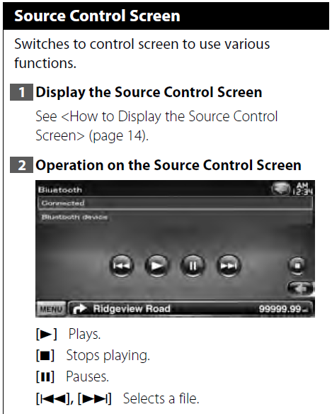

Proud new owner of a 2012 Kizashi and I have a quick question. What i'm trying to do is play music using Pandora from my android phone to the Kenwood unit via bluetooth. The phone is synced up and I can make phone calls just fine. The problem I seem to have is that I don't have an option to select "Bluetooth" as a source for audio. My source select screen has 9 options, none of which are bluetooth, and doesn't have a second page.
I guess i'm trying to figure out how to add bluetooth as a source, and possibly remove some of the unnecessary sources. I've checked the user manual for the Kenwood DNX6160 as well as the usual googling, but for some reason i've had no luck. This would seem to be a very simple setting change, so maybe someone can point me in the right direction. Thank you!
This is all the user manual says

No luck with that either. The 9 options I have are: Video, Nav, Standby, Tuner, iPod, DVD, Sirius, XM, USB
I tried each of them separately just out of curiousity but that didn't work either. I was actually able to get a bluetooth option when I went into the manufacturer menu (holding func & eject and then pressing reset). I have no idea why that doesn't show up in my normal menu. Unfortunately, the phone audio still doesn't go through the speakers. I've never had any trouble doing this on other (cheaper) bluetooth units, I have no idea why it's not a simple process using this higher end head unit.
