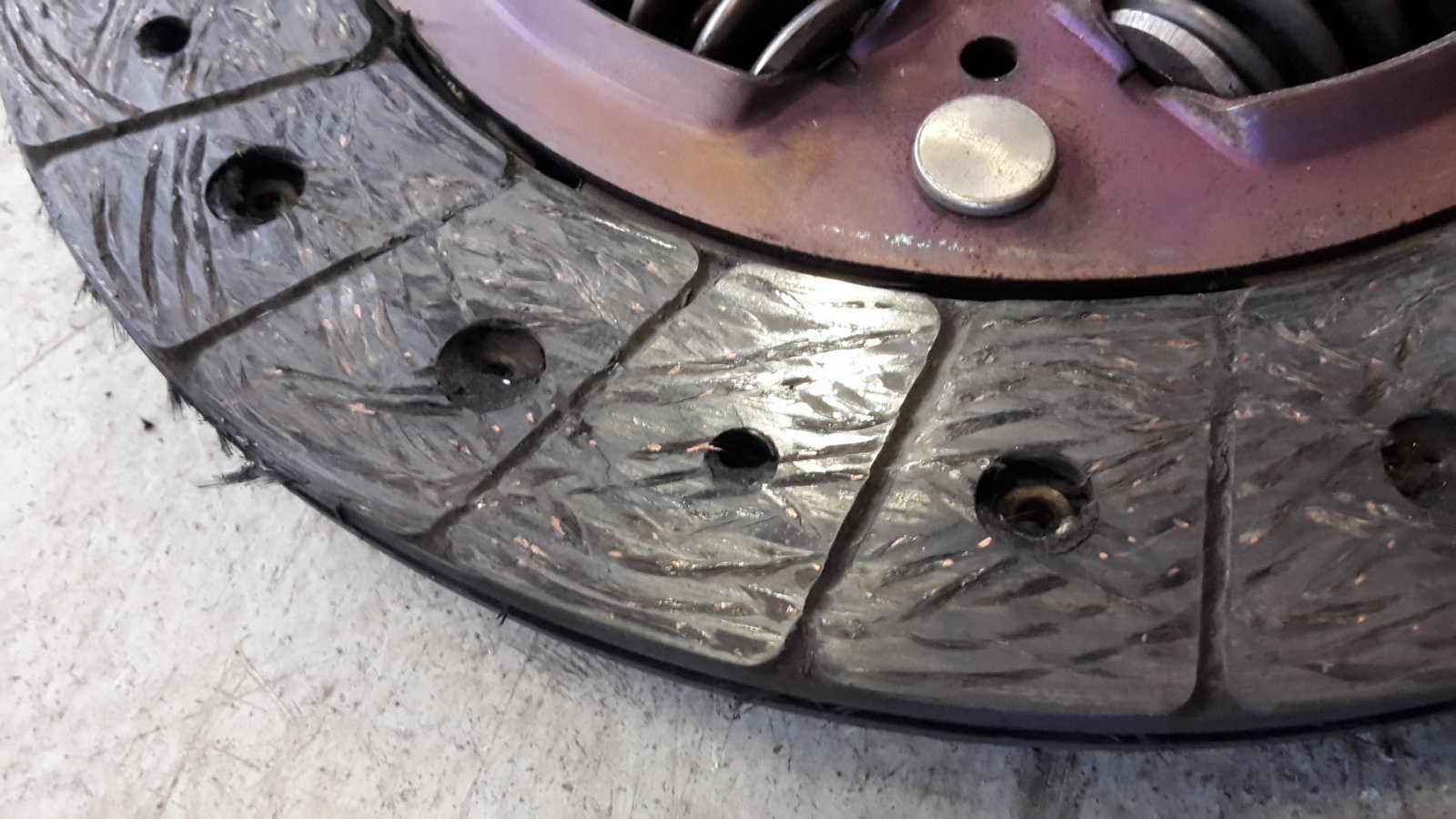

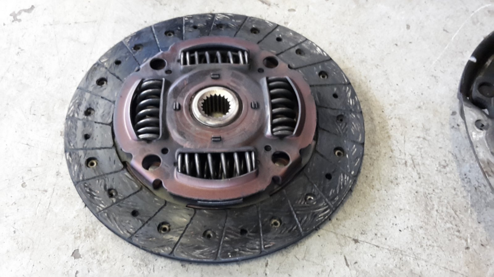

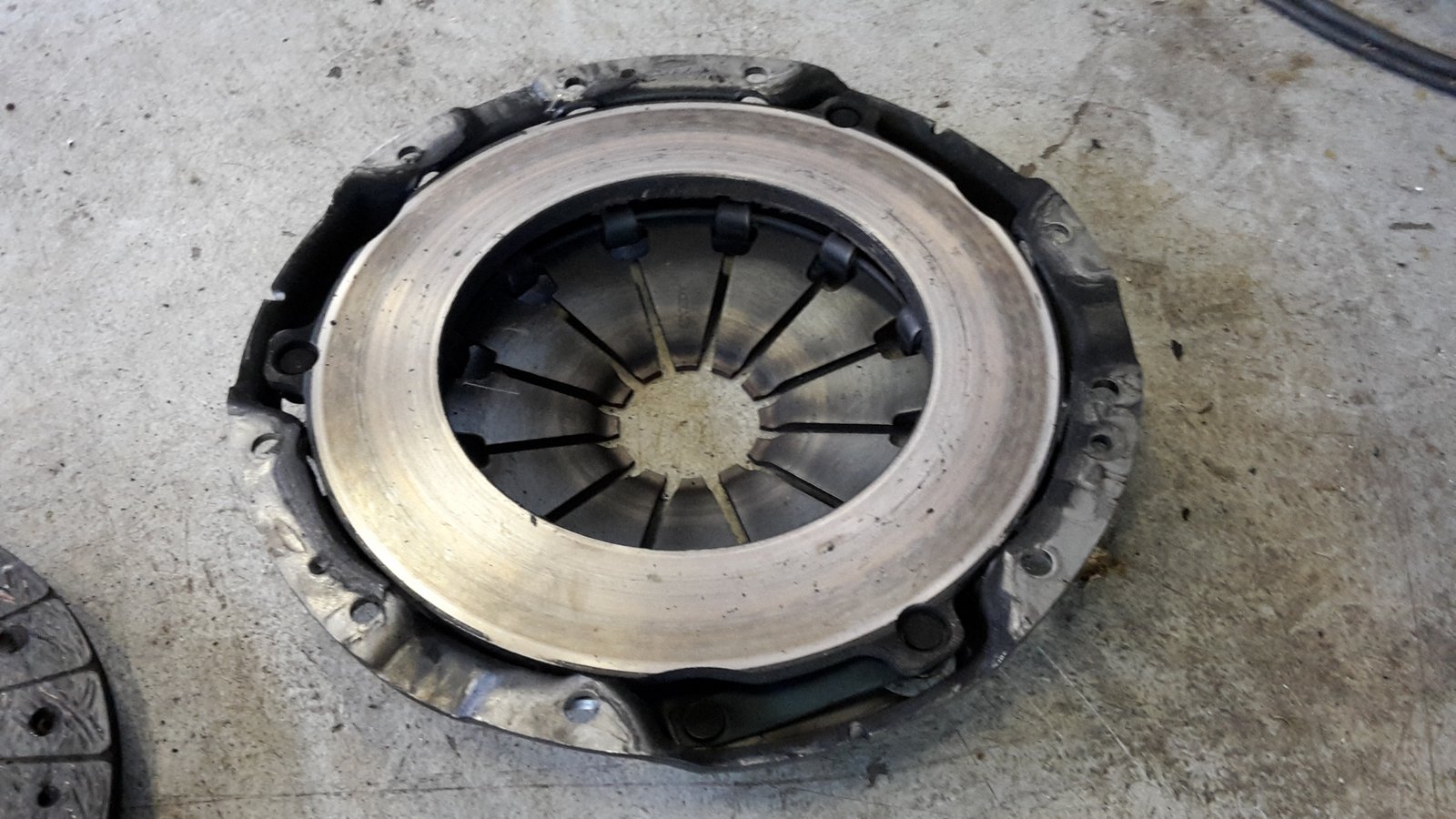

I took the car to 104.000 km before finally deciding to have the clutch investigated. It did not get substantially worse in the meantime, but clutch pedal stroke was very few in the end.
It turned out that the gearbox prise shaft sealing had failed, spilling transmission oil on the clutch(plates).
As it is a full set, clutch plates, pressure bearing and pressure group have all been replaced. And the seal of course.
