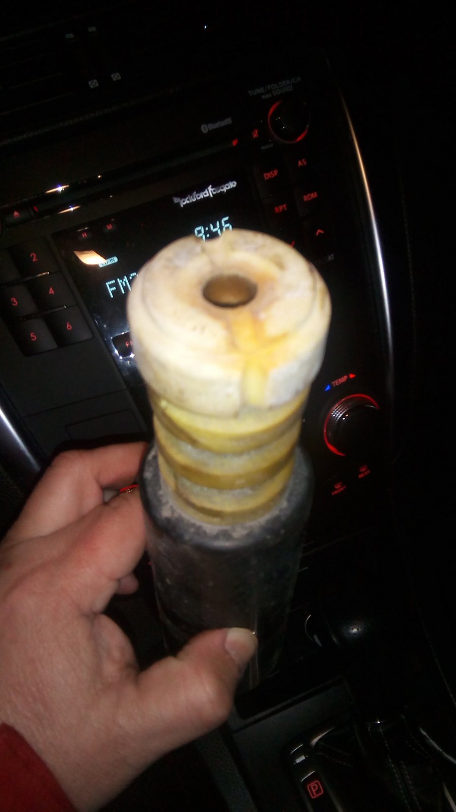

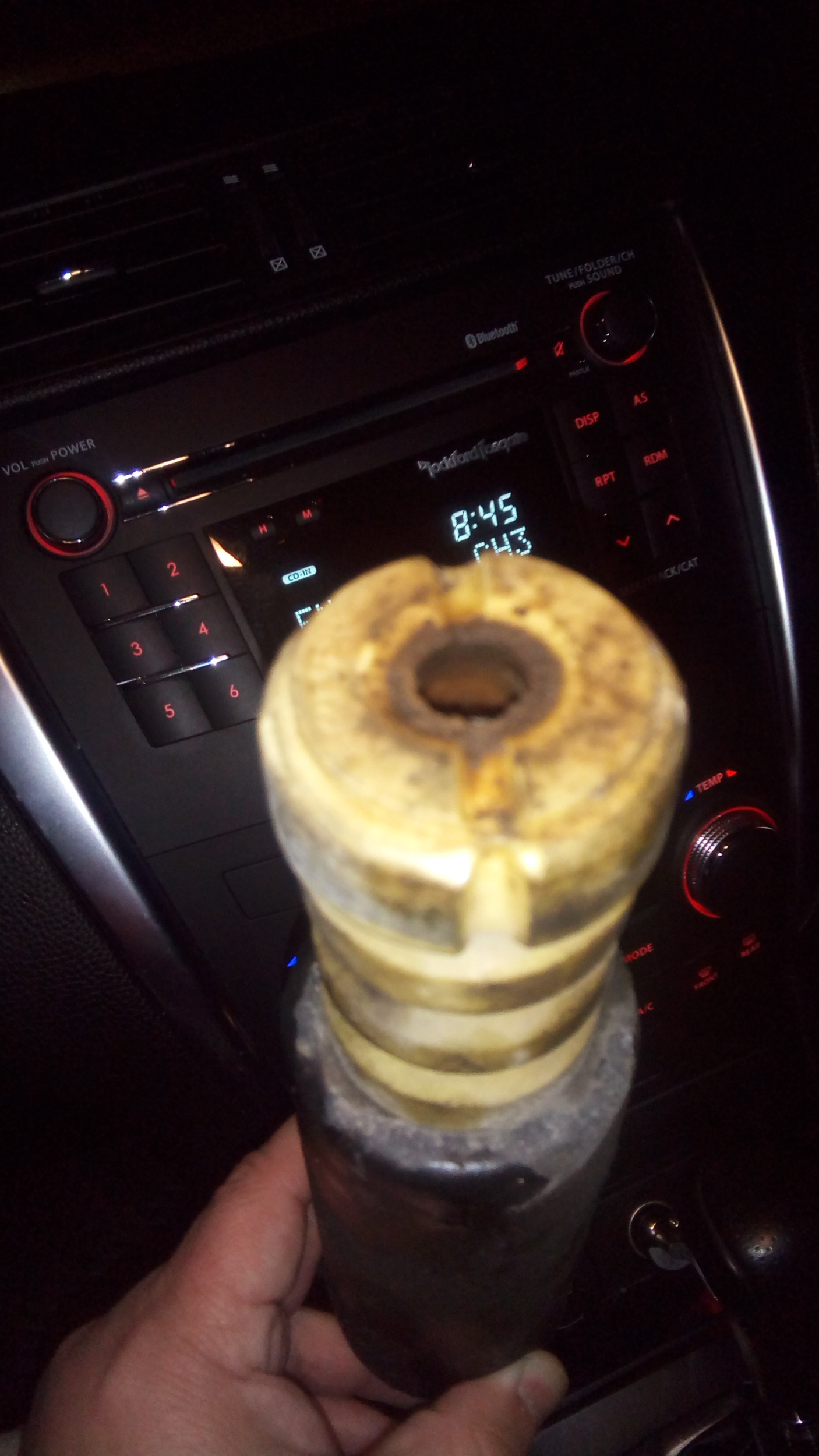

So I finally replaced the rear shocks and bump stoppers. Turns out mechanic did replace the old bump stoppers with the redesigned ones and the shocks STILL went bad after a year and a half!! I'm bracing myself to accept the fact that this will be a common reoccurrence just like the headlights. Only the drivers side rear shock went bad. The rear passenger was still in good shape.
Rear passenger still ok.
Corroded Bump stopper
