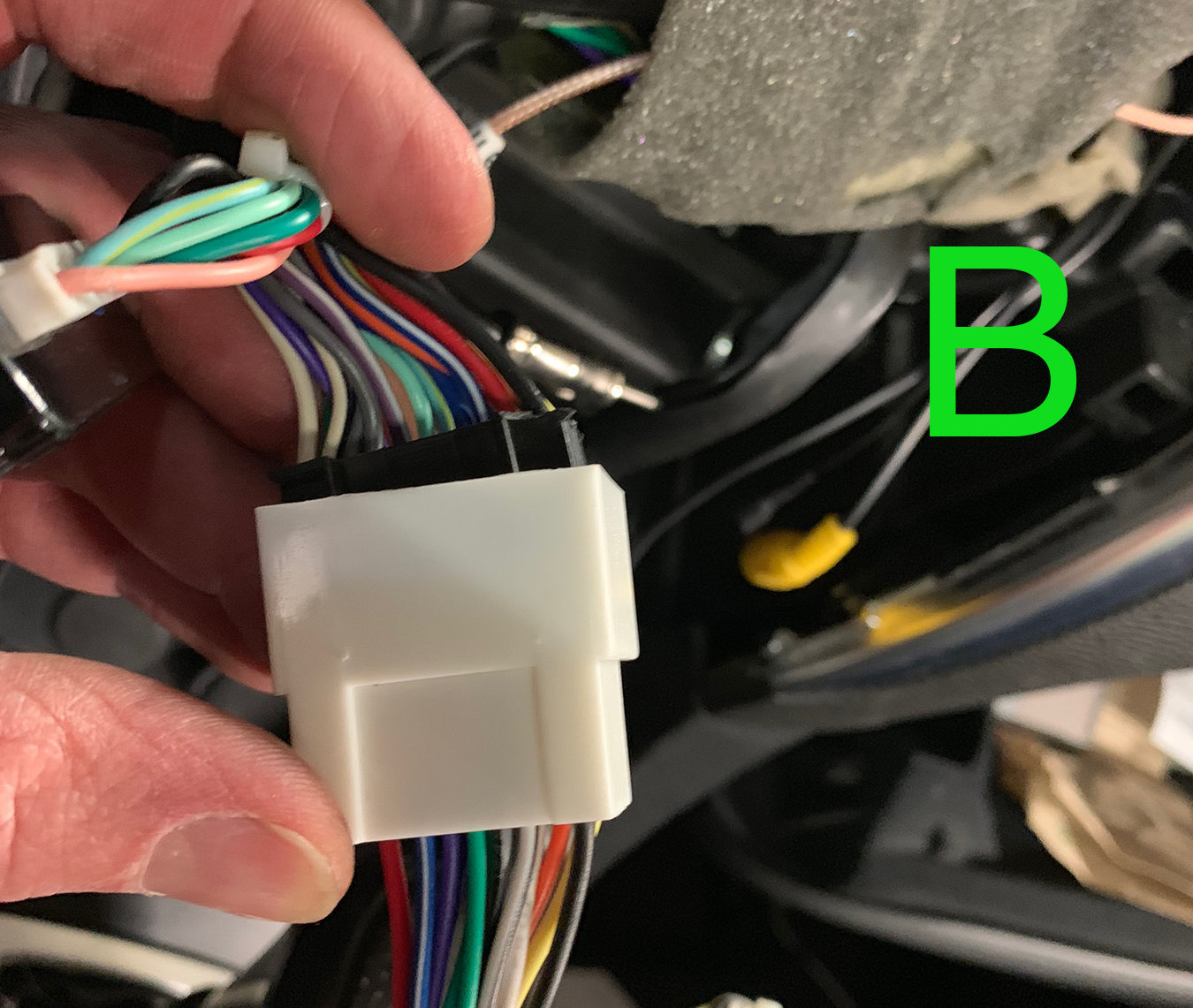

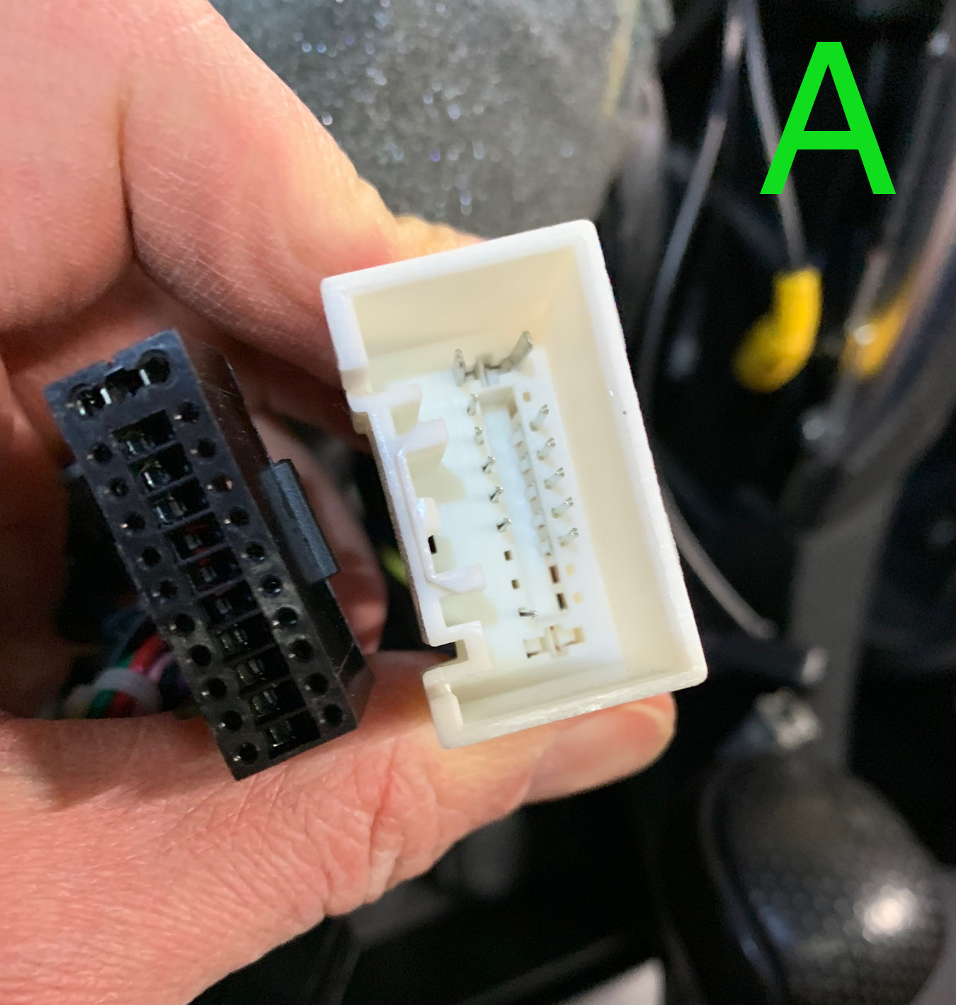

I followed the instructions provided by Crutchfield and pulled the Kenwood out. However, the Scosche wiring adapter (#3 above) does not fit the factory plug. In attached pictures A and B below, the white plug is the Scosche provided by Crutchfield and the black plug is the factory end (that plugged directly into the Kenwood). The holes of the black plug do not line up with the pins in white plug (none of the pins are bent, the adapters just are not the same).
Did Crutchfield send the wrong wiring adapter? Is there a better one that I should use? I really, REALLY want to avoid cutting the factory plug out to directly splice into the wires...

I am not sure but I think:
Black connector is not factory end it is adapter to connect Kenwood HU to OEM connector follow black connector there must be Blue connector unplug it and you see will find mating connector for your new harness adapter.

You were right!! I traced the wires from the black harness and sure enough, there was a white plug hidden by a bunch of foam tape. I disconnected the plug and it fits into the Scosche provided by Crutchfield.
