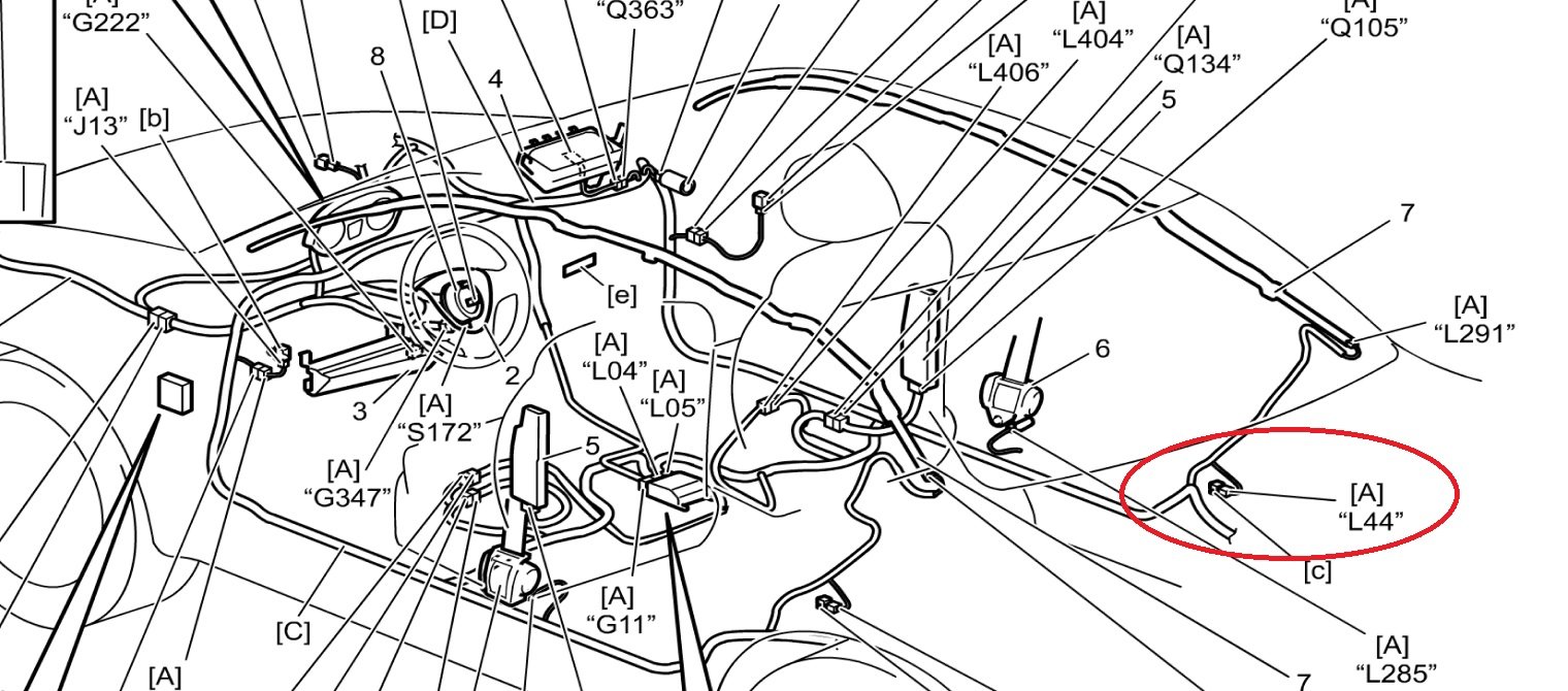

Hello.
Ive got airbag light lit on the dashboard, OBD says B1395 fault code and its side rear impact sensor, but couldn’t find it.
Do you guys know where it is located? It is not under the rear seat, not in the B pillar.
Thank you in advance.

Yes B1395 : Passenger-side air bag
I think you should remove the back seat Cushion and look for L44 connector
