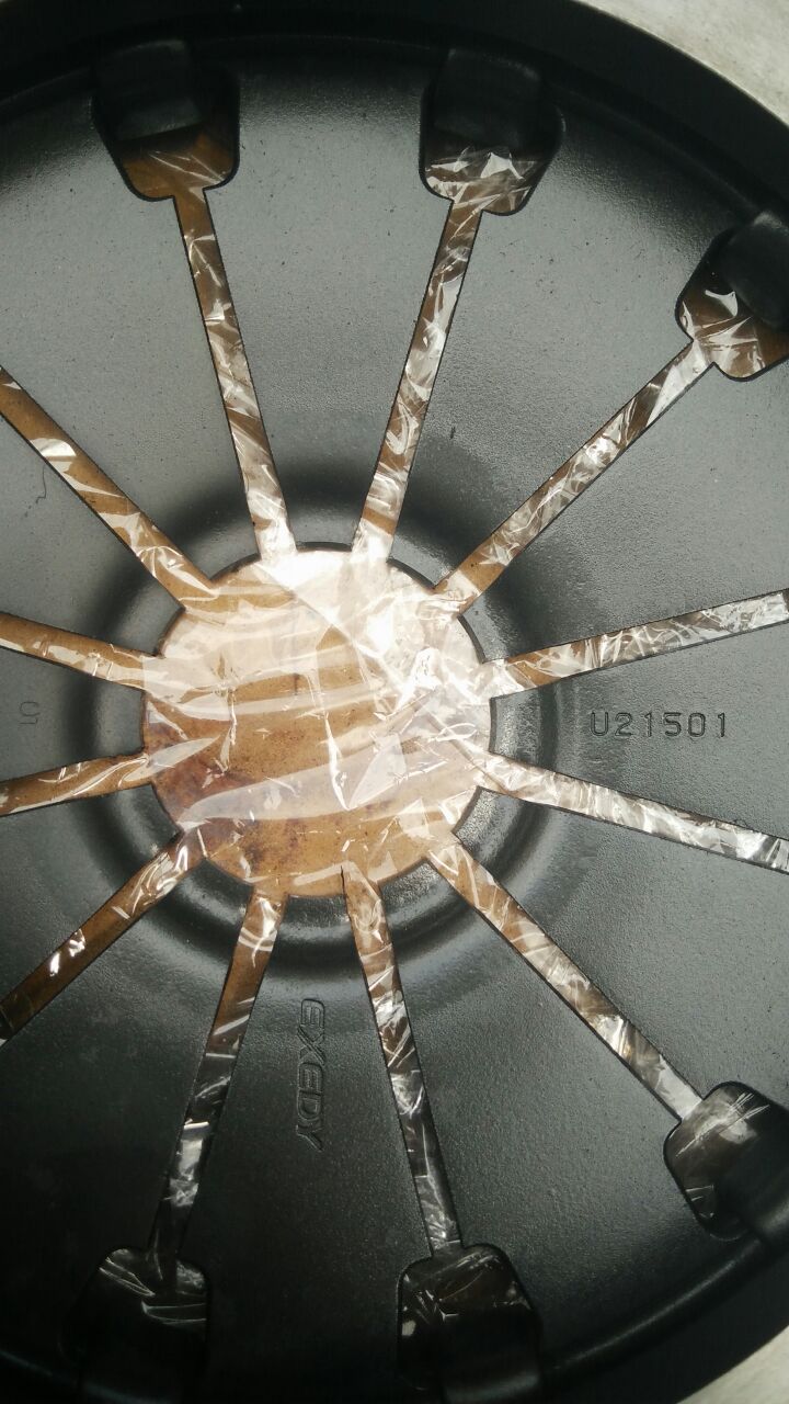

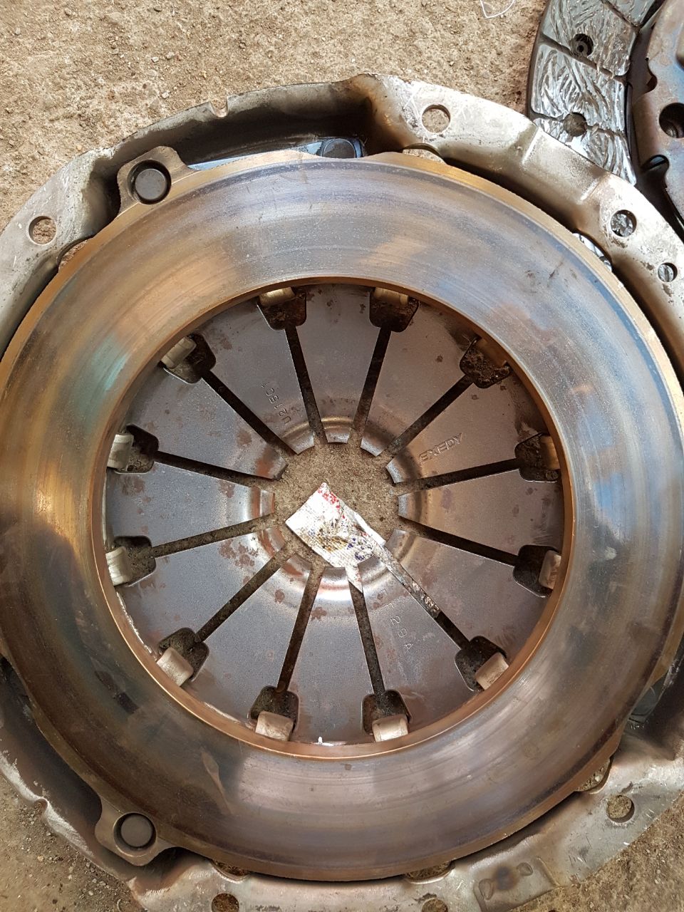

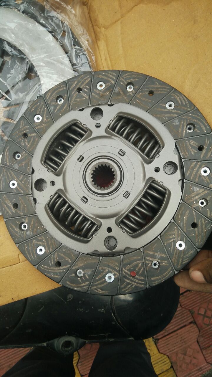

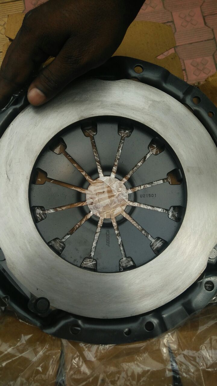

Attaching clutch plate pictures for reference. I could not manage to click pictures of the pedal(which is more crucial) since it was welded in place without full disassembly, and it was dark.

- CP new2.jpeg (154.99 KiB) Viewed 26680 times
- New Clutch plate and pressure plate
- CP new.jpeg (148.04 KiB) Viewed 26681 times
- CP new 1.jpeg (116.87 KiB) Viewed 26681 times
- CP old.jpeg (254.92 KiB) Viewed 26681 times
- Old Clutch and pressure plate
- CP old 2.jpeg (347.48 KiB) Viewed 26681 times
- You can see the extent to which its worn out
- CP old 1.jpeg (351.79 KiB) Viewed 26681 times

Can you state your location and where you got your clutch and pressure plate? They seem to be OEM parts given the new pressure plate has "Exedy" stamped on it. Exedy is the OEM for the Kizashi's original clutch and pressure plate.
While I'm glad that the issue was resolved, I must say I don't think your clutch had much to do with the pedal box breaking. The clutch pedal actually releases the clutch, not engage it, therefore stepping on the pedal disconnects the clutch from the flywheel rather than put pressure on it. The breakage of the pedal box was likely due to the poor welding, not the clutch, and caused by the force of your leg. Let me know if I'm wrong, but you likely have a Right Hand Drive model where this weld problem is prevalent. Others with RHD models have had the clutch pedal box break and got it fixed yet kept their original clutch and pressure plate.
I think your mechanic simply replaced the clutch and pressure plate given he did the work to take the old clutch and the pressure plate off. You stated that you only had 58,000 km which is about 36,000 miles. For a clutch to wear out this fast, there's something abnormal going on and it's often on the part of the driver. You claim that the repairs brought about the improvements you listed which are all associated with a new clutch so perhaps it was a good call to replace the clutch and pressure plate anyway. Hopefully, they last longer this time.

I'm not seeing much difference between the old and new except that one is dirty.

I was thinking, looks typical until I saw the pic with your hand in there as a reference. Man that is one tiny clutch! A Samurai's clutch plate is nearly double the diameter with far less hp (66hp) than the Kizashi.
sold)
I think it's pretty standard for a FF (Front Engine/Front Wheel Drive) sedan. I think the reason why the Samurai's clutch was larger was due to the FR (Front Engine/Rear Wheel/4x4) layout, allowing much more space for the transmission components due to the longitudinal layout.Ronzuki wrote:I was thinking, looks typical until I saw the pic with your hand in there as a reference. Man that is one tiny clutch! A Samurai's clutch plate is nearly double the diameter with far less hp (66hp) than the Kizashi.
