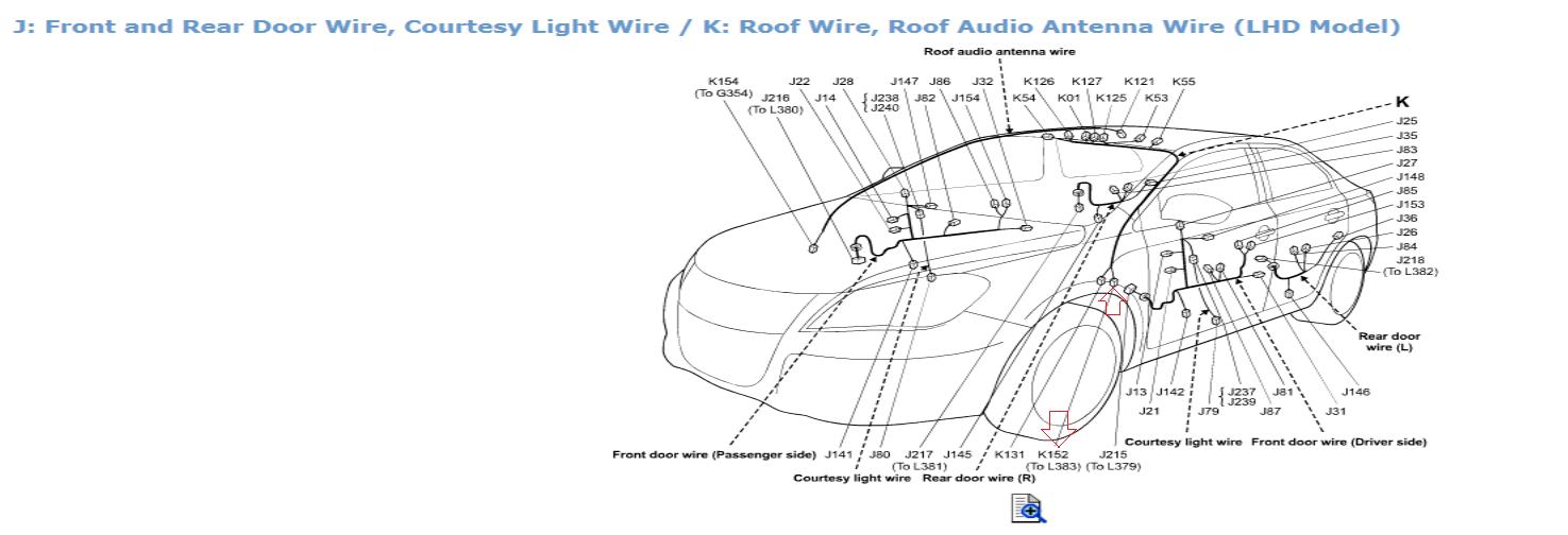

I checked the wiring diagram it seems Mic, Auto light data bus wires, and head roof console share the same connector K152(10-pin connector) most likely this connector is loose or the harness is broken.
Unfortunately, I can not find the exact location of this connector but my guess would be somewhere around the fuse box

SAEED_KIZZY wrote: Thu May 04, 2023 2:07 pm I checked the wiring diagram it seems Mic, Auto light data bus wires, and head roof console share the same connector K152(10-pin connector) most likely this connector is loose or the harness is broken.
You're an absolute hero! They forgot to connect 1 connector exactly at the spot you suggested it might be, the fuse box under the steering wheel.
I reconnected it and now everything works fine again. Thank you very much for your time and help! I would not have been able to fix this without your help :D
