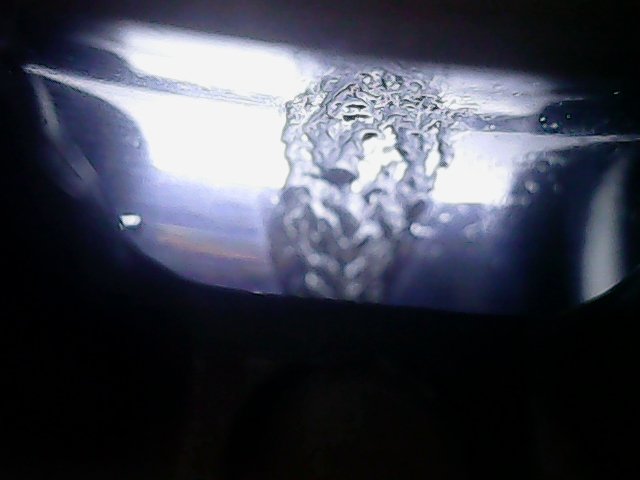

Up date on ticking issue CVT looks like it has 5-10 K miles on it! very clean inside no obvious reason for ticking noise. What I found was the output pulley outer bearing had a bad spot on it on the inner race. Had I known that was making the noise the CVT would still be in the car!
