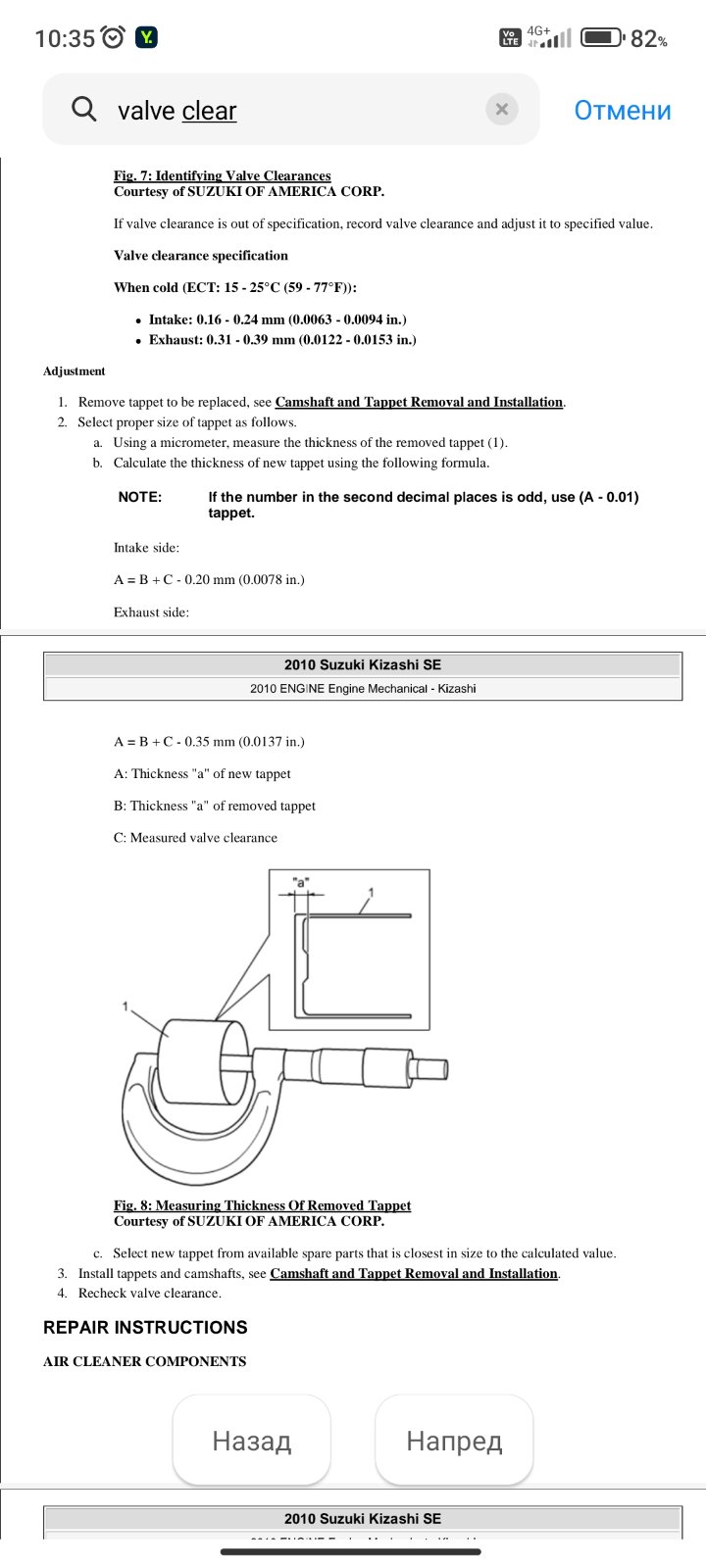

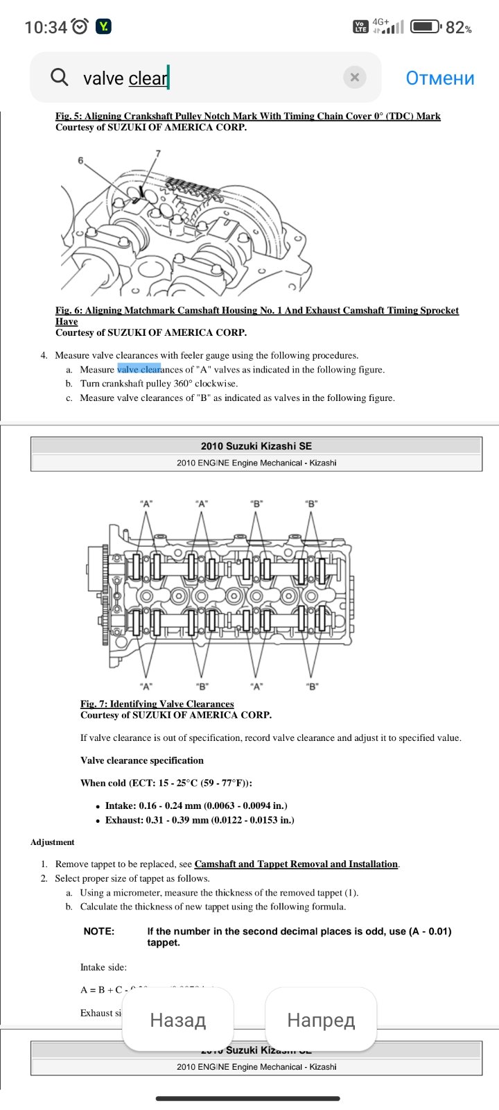

I don't know if it makes a difference for an automatic transmission or a manual, but that's what it says in the manual.
