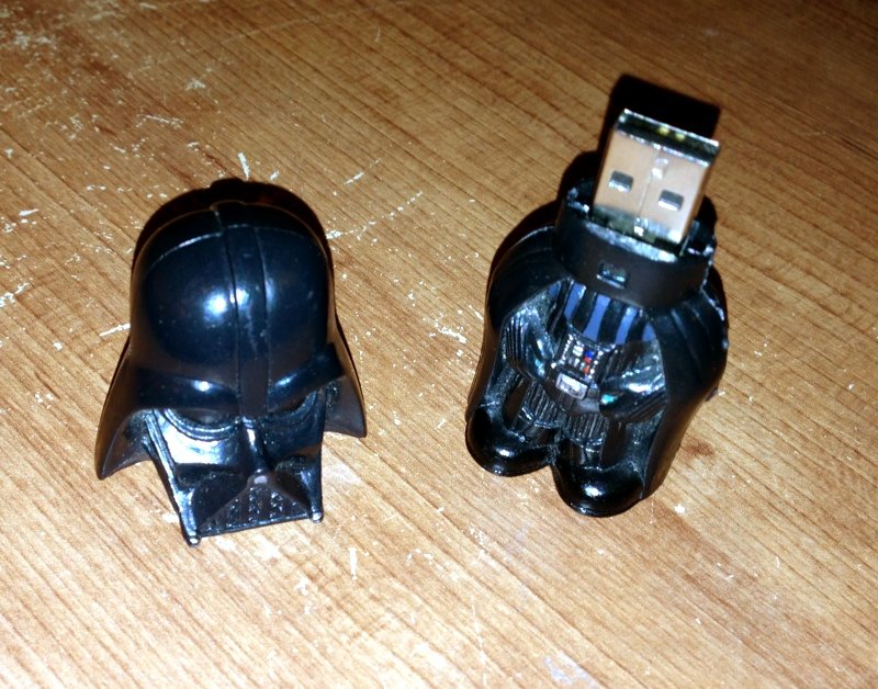

Found a USB stick lying around the office that works. Works fine, not problems. 4 Gigs.
Attaching picture. Make of it what you will, this is the truth, no word of a lie.
