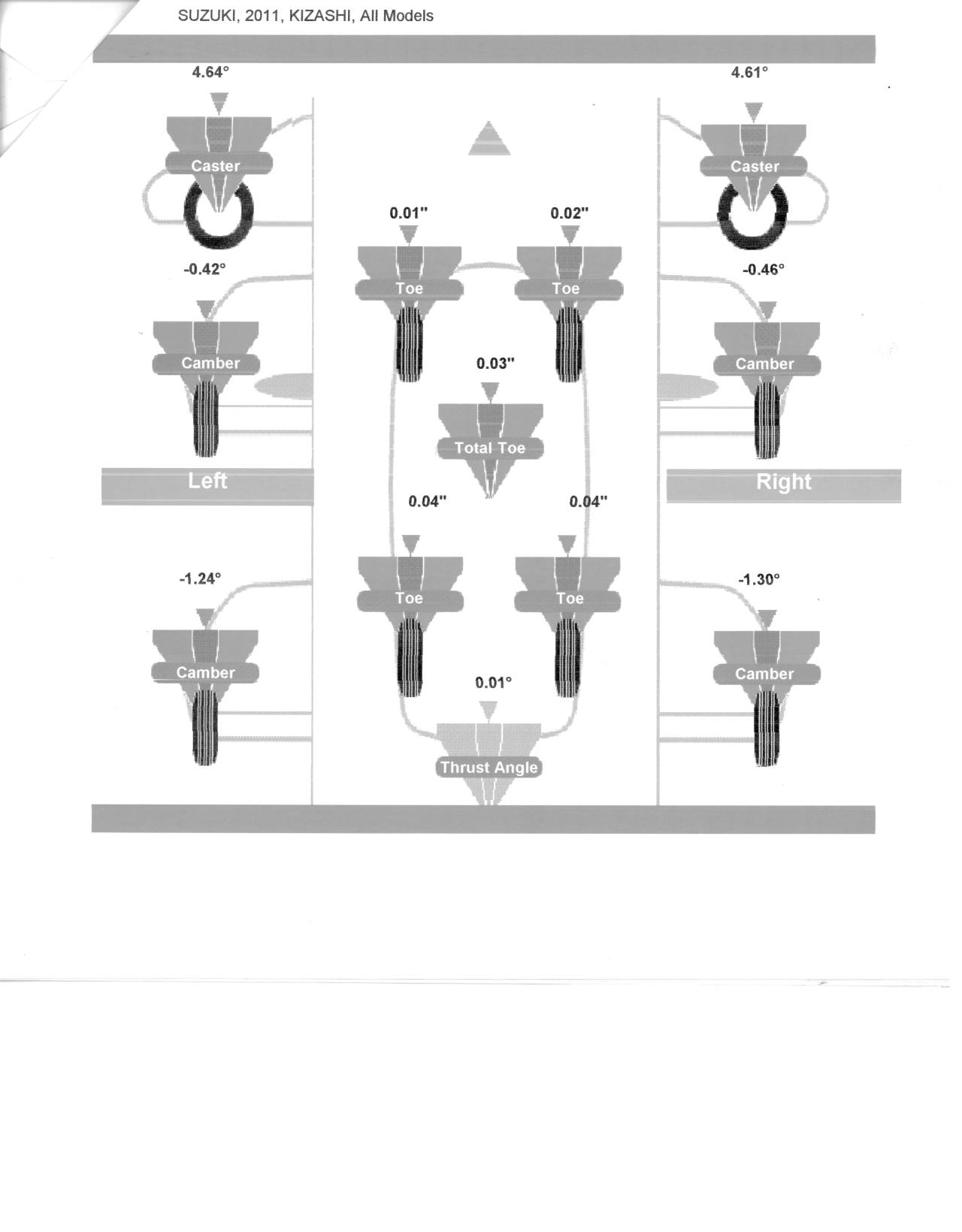

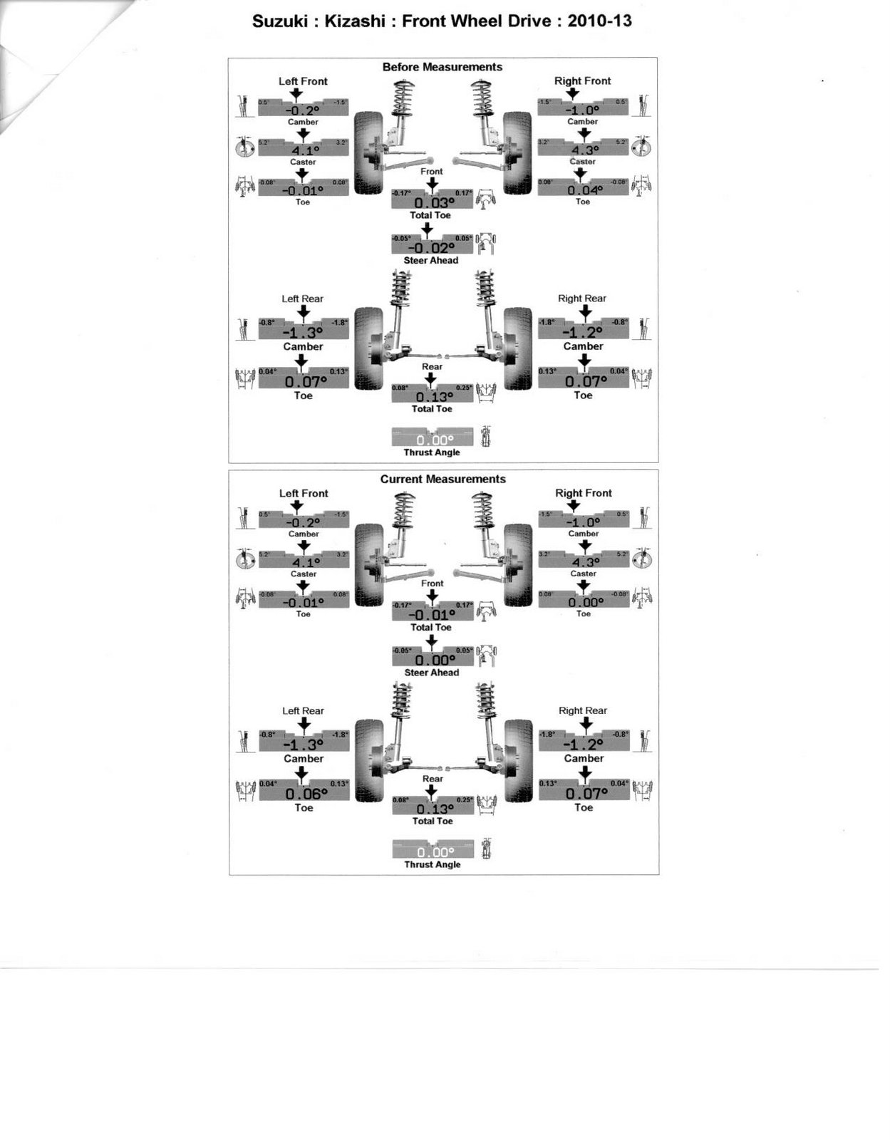

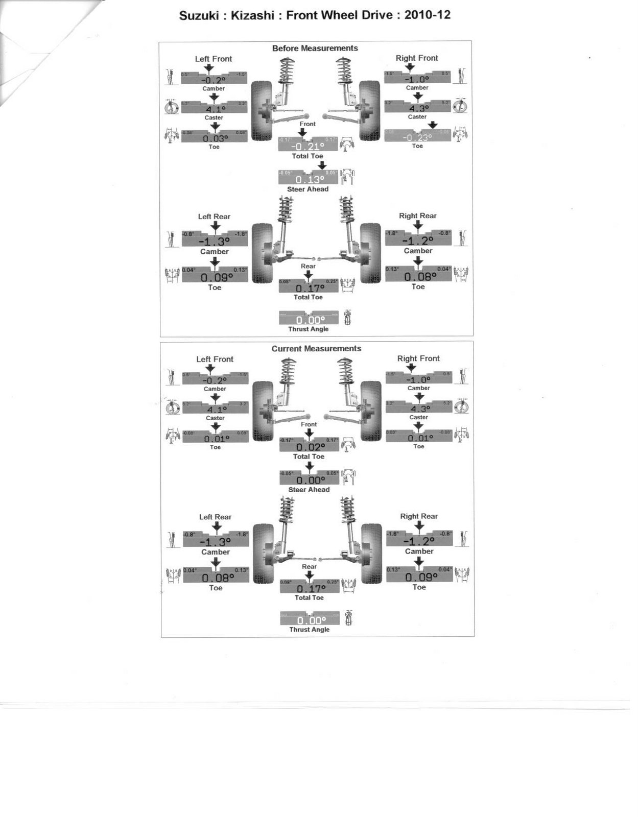

Alright, I finally got around to scanning my alignment specs. I'm including numbers from all three alignments so you guys can get a picture of what the changes have been from one to the other. You'll notice however, that the first two show both before and after measurements, whereas the third scan only shows the after measurements.
Looking at the numbers though, I can't see any big changes...or at least, not changes big enough to where I would think that the car would drive differently (or so I think, at least). So I'm stumped...
I'm actually beginning to think that maybe my steering issue is not related to the alignment at all, but something else. One thing I've also noticed is that the steering is "lighter" even at low speeds, whether driving around a parking lot or parking the car. Even just maneuvering the car into my garage requires less steering effort than before. So maybe it has something to do with the electric power steering? Maybe the dealer made some adjustment to it that I don't know of?
