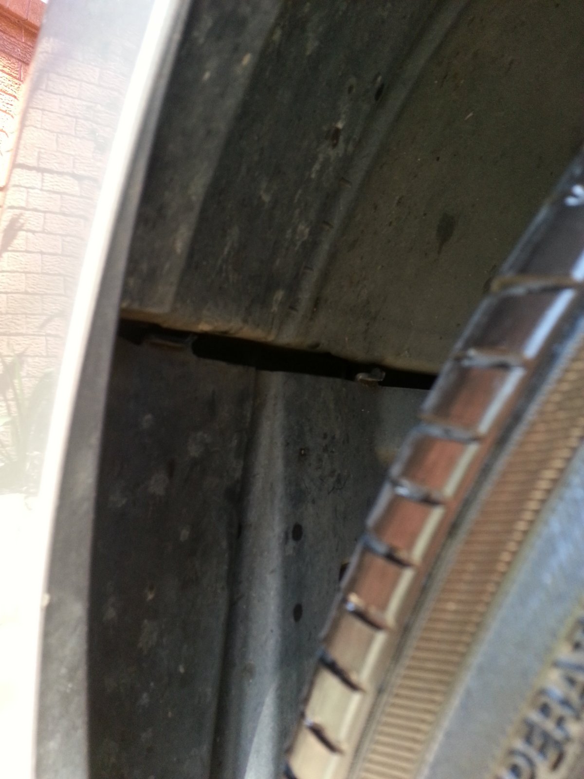

I found today that one of the lining guards of the wheel arch has become unclipped and warped out of shape so its sitting in loosely. I wouldn't have noticed it other than I heard it rattle when I closed my bonnet today.
