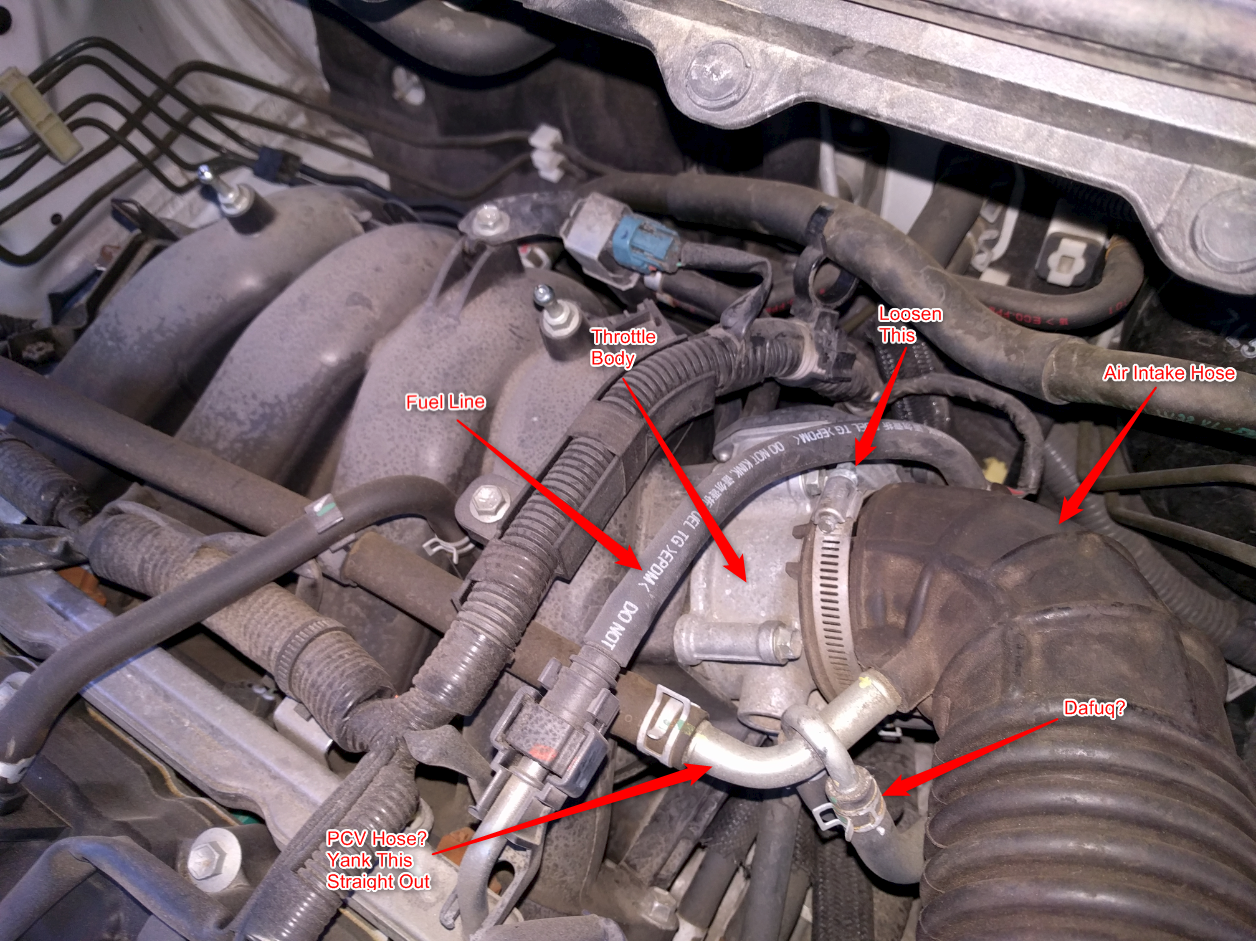

There's a weird hose that loops around what I think is the PCV hose (someone please confirm) and connects to the throttle body (see "Dafuq" below).
Yank the metal part of the PCV hose straight out of the air intake hose, there's no connectors or anything.

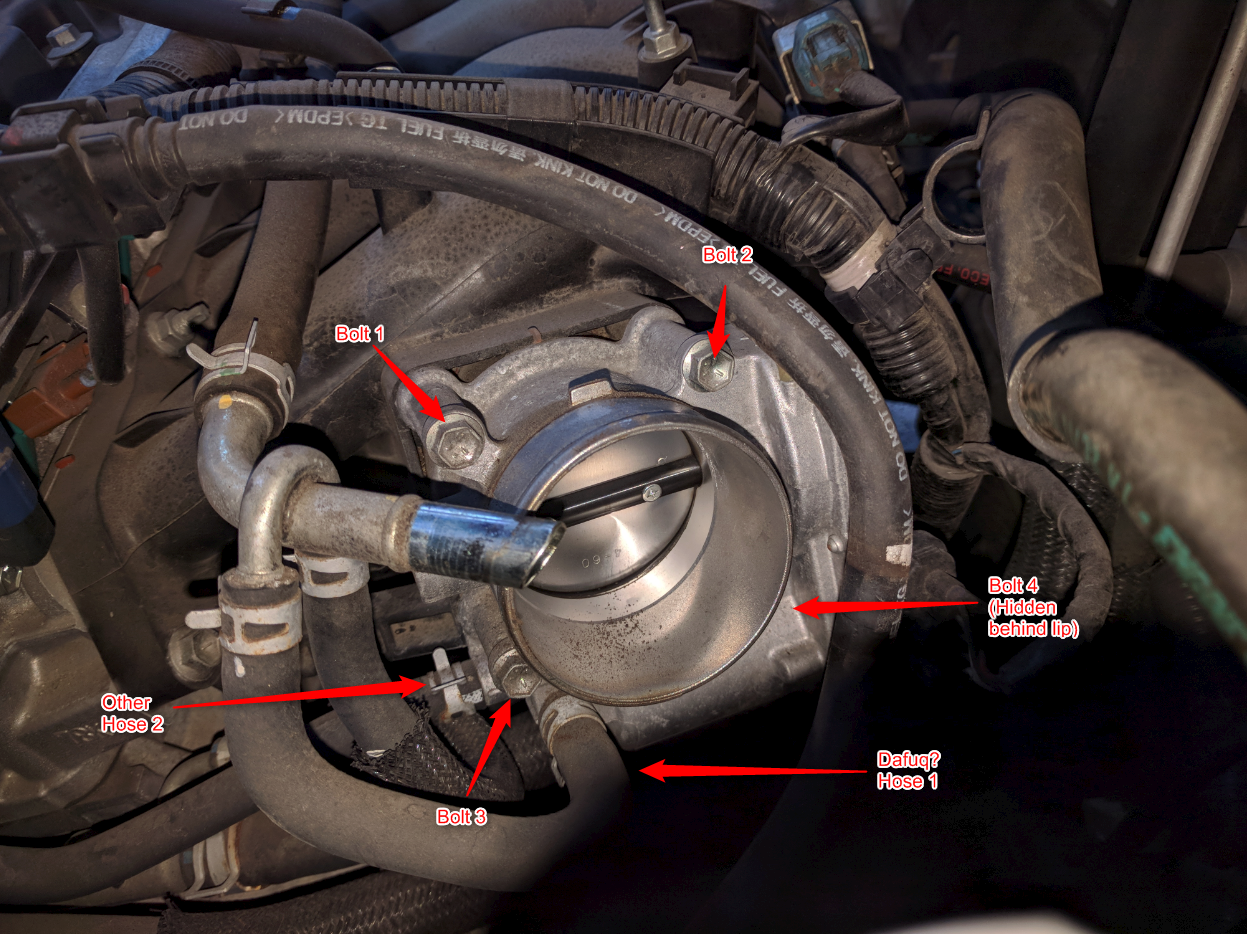

I tried to removing the throttle body today, but I couldn't figure out how to disconnect the electrical plug from the throttle body and I couldn't get Dafuq Hose 1 and Other Hose 2 undone either (see pic below). Not sure if I have a significant amount of carbon buildup on the butterfly valve. I blew the crumbs out of the housing.

That's not the PCV hose. It's called the breather hose. The PCV valve is located just to the right of the center of the valve cover about 8 inches from the breather hose.
Just don't disconnect the fuel line... (talking experience here)
And it looks like the carbon buildup ring is there which is the rough idle and stumbling culprit.
And now that I think about it, there were coolant hoses but the coolant loss was minimal.

That hose is the other end of the PCV system. At low throttle openings the PCV has a lot of vacuum on it without much blowby in the crankcase, so it sucks fresh air through that hose, through the valve cover, out the PCV, and into the intake manifold. Dafuk? is hot coolant to keep that breather hose from freezing solid when it's cold and humid.

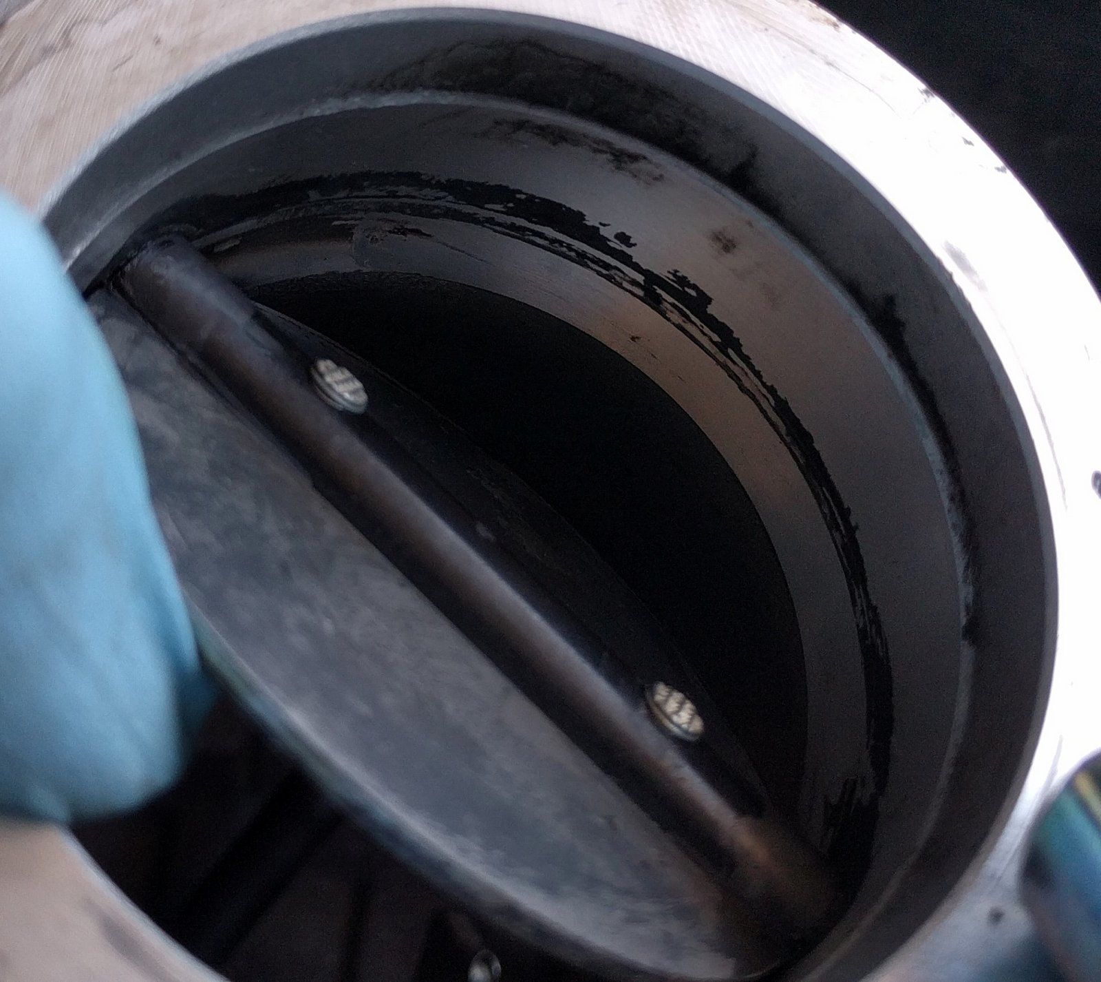

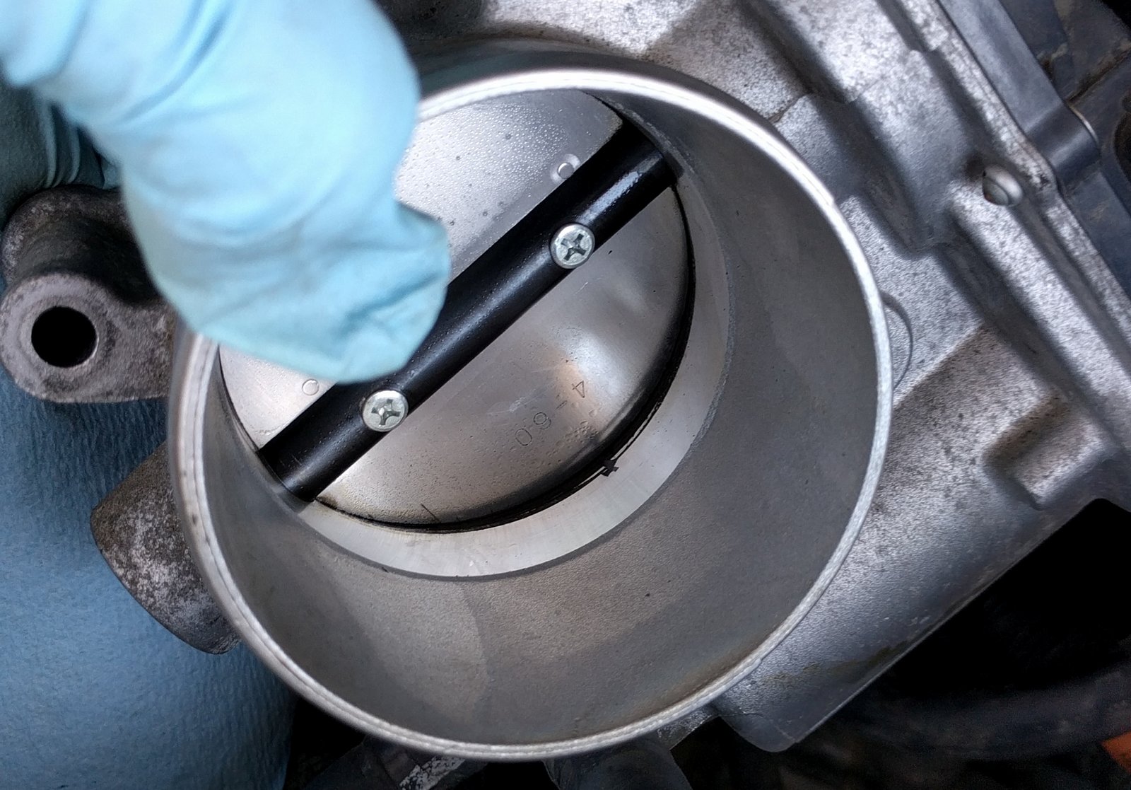

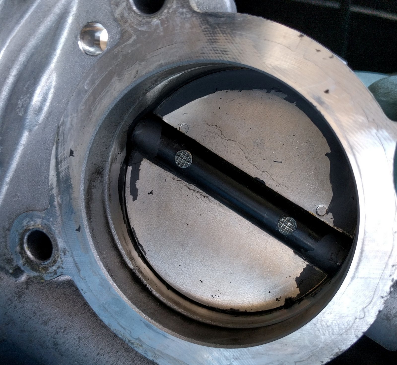

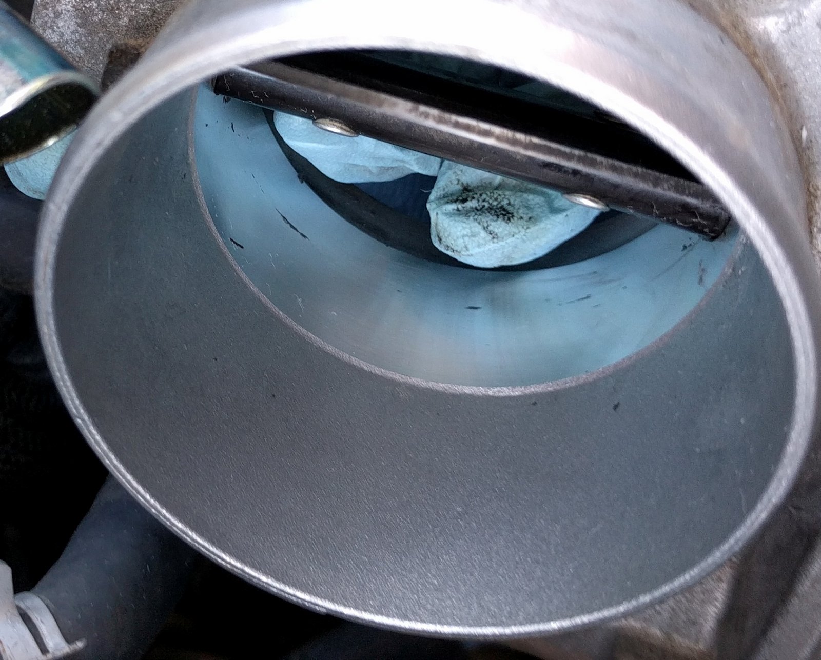

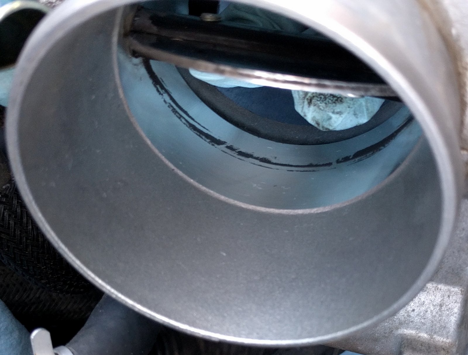

I have some pics for reference for anyone who wonders what "carbon buildup" looks like:
Back-side before cleaning:
Front-side before cleaning:
Front-side mid-cleaning:
Back-side mid-cleaning:

Great pics and I'm sure you'll feel the improvement right away. The first couple times I did mine I left it on and propped it open with a screw driver. While cleaning, I released the spring tension holding the screw driver and it fell into the intake manifold. Let me tell you it was no fun getting it out. It almost would have been easier to turn the car on its side and shake it!
