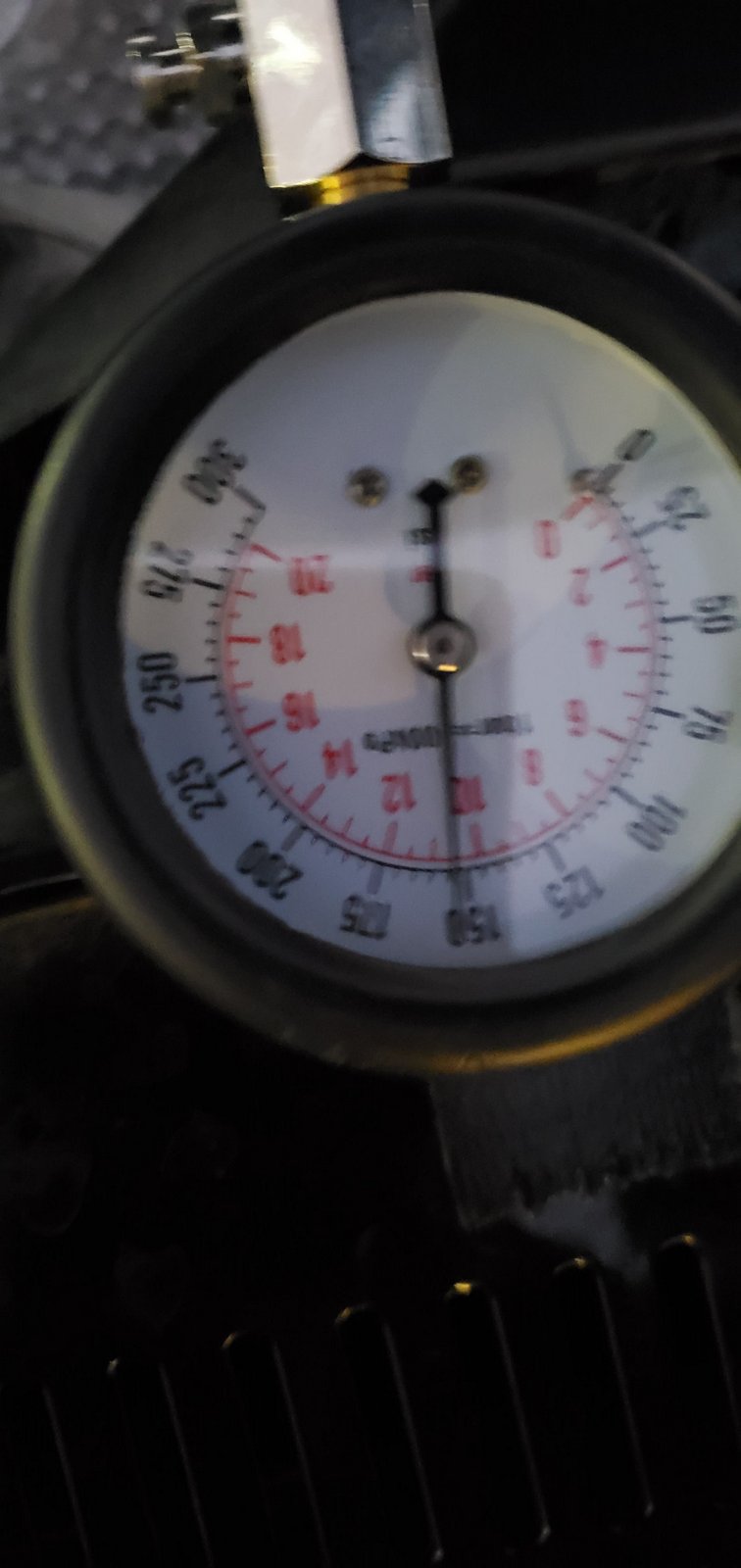

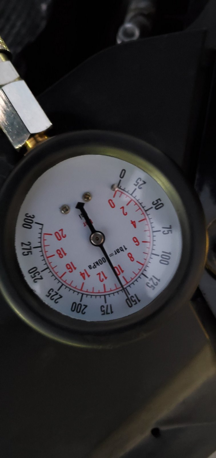

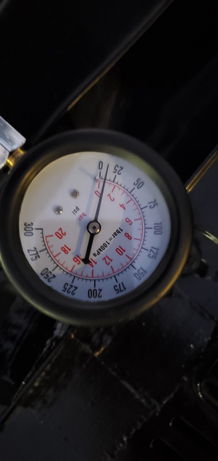

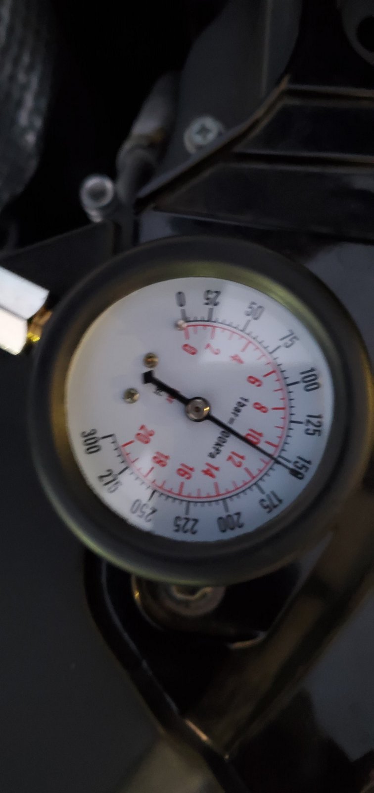

Thank you so much for your help so far regarding my issue in the car. I did a compression test yesterday as per suggestions and the results don't look it. Please advise me to go forward from here on, I will really appreciate it.
Engine Compression Test Results (Performed Twice)
The compression was performed after I drove car for 6 to 7 minutes.
Cylinder 1: 150 psi (1st Time Reading) 150 psi (2nd Time Reading)
Cylinder 2: 148 psi (1st Time Reading) 149 psi (2nd Time Reading)
Cylinder 3: 154 psi (1st Time Reading) 151 psi (2nd Time Reading)
Cylinder 4: 10 psi (1st Time Reading) 10 psi (2nd Time Reading)
I have attached image of the compression test.
The cylinder 4 has 10 PSI which is very very low. What might be the issue and is it worth fixing it?
Also, can I drive the car without fixing it? I know it will cause an issue on the catalytic converter later on because of the gas but I am thinking about disconnecting the power to the 4th fuel injector so that no fuel gets sent to the forth cylinder and drive the car till its end.
Any suggestions will be highly appreciated.

Air, fuel, spark; those are the components needed for combustion. Sounds like you got the spark part covered with new parts and the problem persisted. Time to move onto fuel. Have you tested the fuel injector for Cylinder 4? It shouldn't be too hard and I think any auto shop could diagnose it for you. Check the wiring. I once had to fix a Toyota Sienna that misfired due to mice literally chewing through the fuel injector control wire.
The worse cause would be with air as that would mean bad valves but I think you really should rule out a bad fuel injector first.
I can't imagine running only 3 cylinders on a 4 banger is a good idea. When I had a misfire due to a failed coil a little while back, the engine was unnervingly rough at idle. Let's hope to fix it properly and have the engine running as it should.
Good luck!
Good luck!
10 pounds, sheesh that's all but zero...there's a valve closure problem, or, a completely toasted set of rings on piston #4 (hard to imagine that). hard to believe the head gasket is the culprit either. Did you add oil to the cylinder and run the compression test again to rule out the rings?
