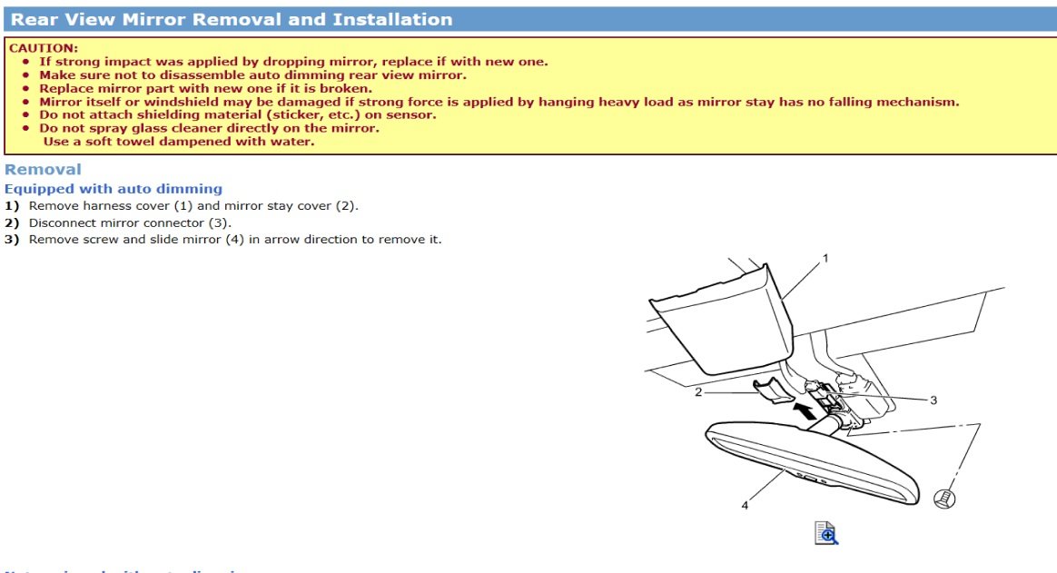

Can you please describe how to take off the mirror? I'd like to take a look behind. Maybe it's a matter of dust or something - like I said, all worked well right after the windshield was replaced earlier this year.

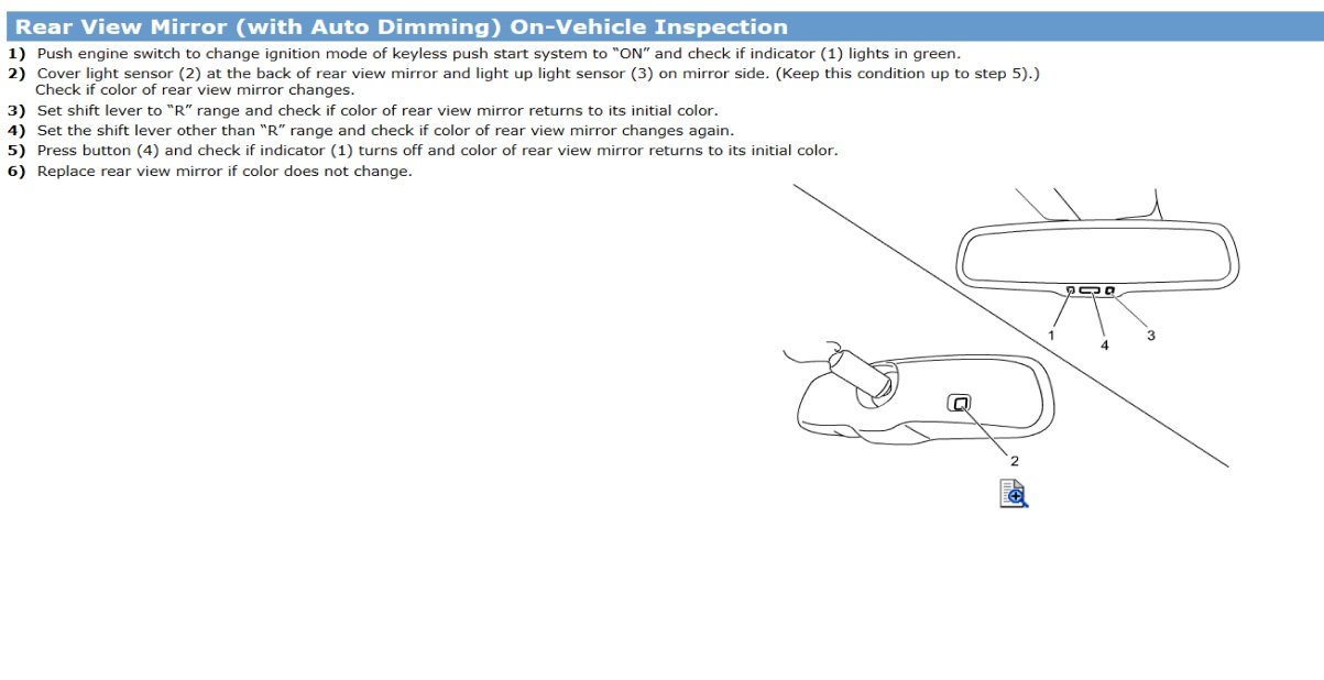

If you push the engine start switch to “ON” and mirror indicator lights turn on to green your connection is good.
here instruction to open mirror and check sensor

if the mirror indicator lights turn on to green your connection is good
Are these the turning lights? Or was the mirror anti-dim active green square meant? Or, what are the mirror indicator lights?
I think the best way to describe is to quote from the service manual

Around lunch today I headed out to a Dr. appointment. I didn't have time to start fiddling with Suzuki's strange video-game-like Indiana-Jones-like hidden levers and buttons combinations, but I did follow all the steps in the rearview mirror inspection procedure uploaded by SAEED_KIZZY (see previous post). All rearview mirror functions worked perfectly.
