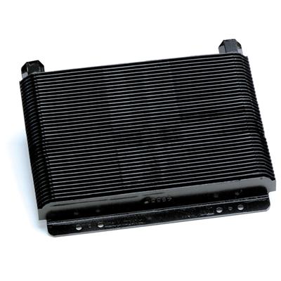

B&M SuperCoolers are 100% aluminum construction and use stamped plates
bdleonard
Posts: 274
bootymac wrote:Also, I don't have the exact measurements of the stock cooler (looks like ~4x20"?) but I don't think the RRM cooler will be an improvement.
The surface area of both coolers appear to be very similar. However, the stock cooler has the advantage of greater frontal area. Also, I believe longer tubes are more efficient.
I could be wrong though!
I took a quick rough measurement before. The stock CVT cooler on my 2013 is roughly 24" x 3" x 1", and sits nearly entirely in the lower grille. Airflow there should be excellent. I meant to take a more precise measurement when I had the bumper off to replace the headlights, but I forgot.
On the Kizashi, the standalone cooler and the in-radiator cooler appear to be connected in series. To my eye, it looks like it flows through the oil cooler first, followed by the radiator. If that is correct, it is possible that people having overheating issues might benefit from changing the routing of the hoses so that the fluid flows through the radiator first, then the standalone cooler. When conditions are very hot the radiator may actually be reheating the just cooled CVT fluid to some extent.
Has anybody identified the direction of the fluid flow through the system? Perhaps somebody has done a fluid exchange by disconnecting a cooler line?

Haha I have been highly considering adding on a aftermarket cooler. I only have about 500 miles left until I hit the 100k mark. I have until this summer to have this figured out but would like to take care of it now as I will be going on some road trips here soon. But before I drop the money on the cooler I want to make sure I'm getting the best one that's compatible. That B&M cooler doesn't seem like a bad idea either. I will be researching more over the next month. What are your guys thoughts on which CVT cooler to get? I'm no pro when it comes to this as I'm still unfamiliar with CVT's, and a large portion of the world still does not understand them. It's quite humorous at this point.

You already have a secondary CVT cooler from the factory. In my opinion you would be hard pressed to add a cooler with significantly better performance given the sizing and placement of the factory setup. If I ever get the time to figure out the proper command to get my OBD2 reader to show me the CVT temp, I plan to do some tests with the order of the two factory cooling loops swapped. I'm not sure what order the fluid flows (radiator, secondary cooler, CVT OR secondary cooler, radiator, CVT). The radiator portion will have the effect of bringing the CVT fluid to approximately the temp of the engine thermostat, so swapping the order may impact the temps.
If it was me, and I decided to add a cooler, I would probably replace the factory secondary cooler entirely rather then try to fit in a third cooler. It should make mounting and plumbing much easier. If you do decide to upgrade the cooler, it would be great if you could take some temperature readings before and after. Maybe of the CVT oil pan, following a common driving cycle, if you have access to an IR thermometer.
