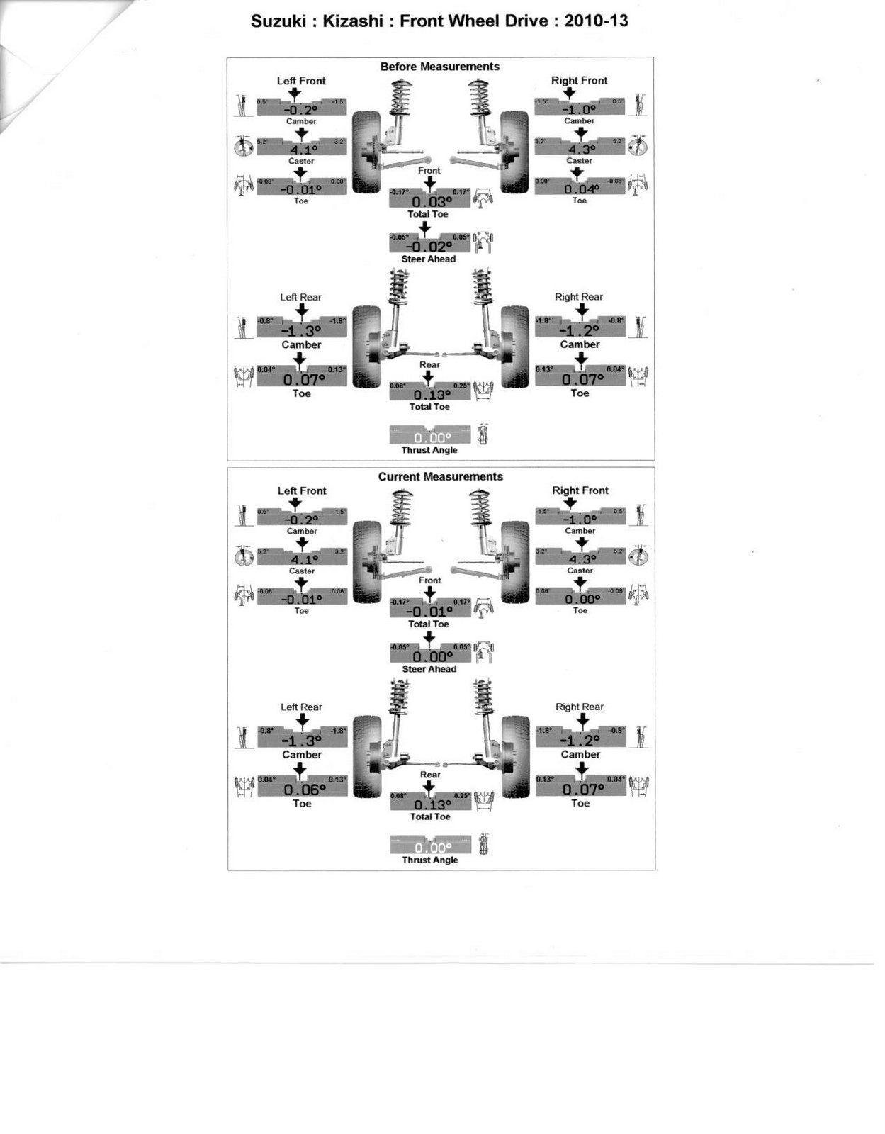

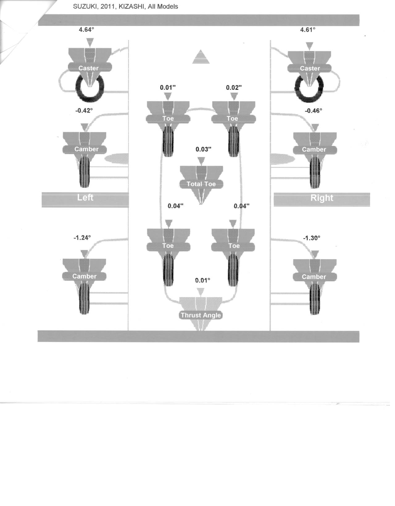

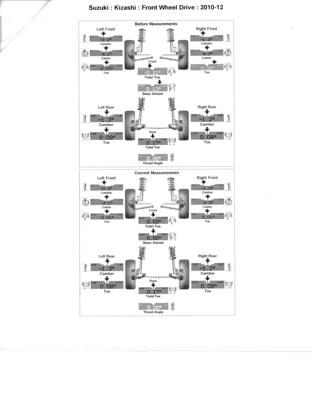

FWIW, I'm attaching the specs from the three alignments I've had done on the car--the car still drove fine after the first alignment, it wasn't until the second alignment that the handling changed.
Like I mentioned in the thread from months ago, if you look at the specs, it doesn't seems like there were any drastic changes made, so I have no idea why the handling would have changed when the second alignment was done. The third alignment seemed to help for a short while, but then soon after went back to feeling "loose".

- First Alignment
- scan__0812.jpg (136.99 KiB) Viewed 7264 times
- Second Alignment
- scan_0113.jpg (142.21 KiB) Viewed 7264 times
- Third Alignment
- scan_.jpg (83.51 KiB) Viewed 7264 times
I didn't see anything too far off except that in the last alignment (if that's the after), the caster is much more than it has been in previous alignments, and with an almost zero toe, that will cause the bump steer.

Despite being 'within spec' I'd get the front toe dialed in better. My last alignment, 3rd one a few thousand miles ago, I had all specs dialed in to dead center of range and thus far it has been the best feeling, and, I am finally seeing no adverse tire wear on the front. My front toe specs looked similar to yours from the alignment by the zuk dealer after I put new tires on. Several thousand miles later I was starting to see feathering on my brand new tires. Back to a different shop that had a brand new rack. Before hand I told the mechanic I wanted everything adjusted to the exact middle of the range. He showed me all was 'in-spec' before he started adjustments however, he did as I had requested. It took him a while, but he got it.
