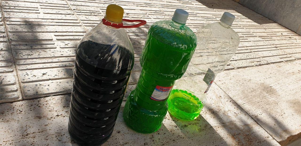

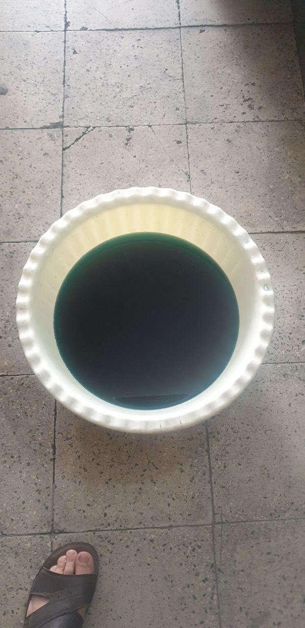

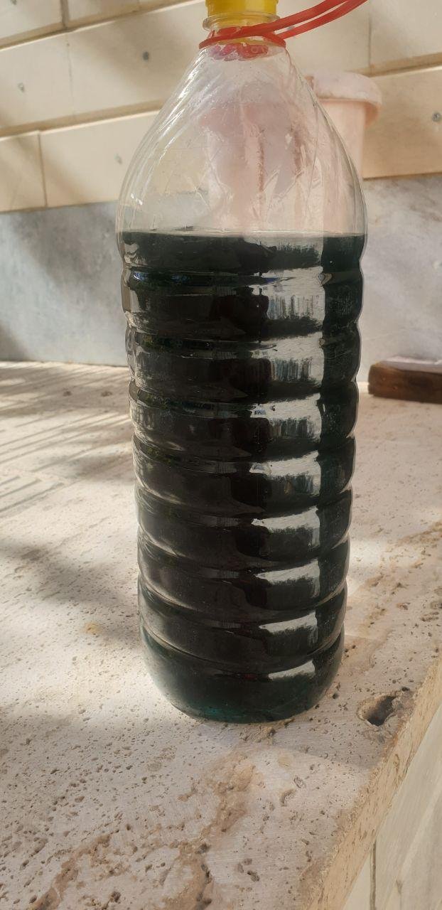

Ok time is come to change kizashi coolant after 9 years(150,000Km) still original coolant from factory. :facepalm:
I decided to change with SLLC Toyota red coolant just before that 2 time flush with radiator water(green) and some photos off course ;)
