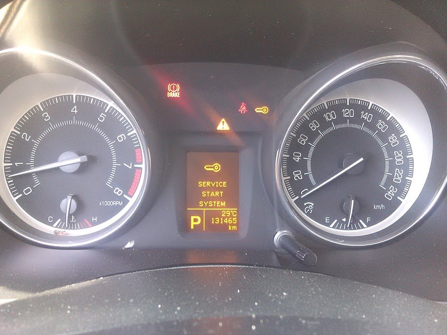

Hi, guys
I've same problem (Service Start System) but when i put gear lever from D to N, the N doesn't show in display and Service Start System show's up. When i put to D it goes, I took it to dealer many times and they saying that they didn't found the problem, and I'm still getting this problem

- IMG_20170131_120536.jpg (120.15 KiB) Viewed 10981 times
Have you tried the door lock/unlock solution?Motasem wrote:Hi, guys
I've same problem (Service Start System) but when i put gear lever from D to N, the N doesn't show in display and Service Start System show's up. When i put to D it goes, I took it to dealer many times and they saying that they didn't found the problem, and I'm still getting this problem.
https://goo.gl/photos/9SpD9SFJ6yWoHdqA8
Check the link
You get out of your car, lock the car, unlock the car, and try it again. For many, this was a solution to intermittent service start issues.
