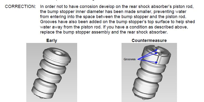

Can you not order the newer style bump stop? That would be best since you'll have everything out of the car.

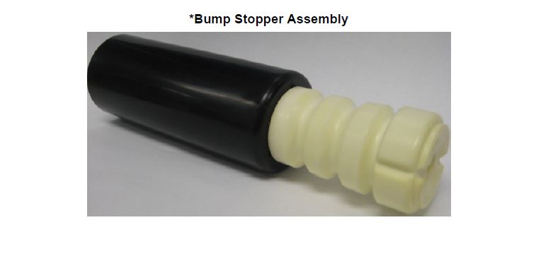

I assume it's only item number 4 in the below diagram that is replaced?
I don't supposed anyone has pictures of the newer design bump stop- perhaps cutting some slots in the old one might work? But it may cause it to prematurely fail too?
Yup, it's #4. Looks like the bump stop and dust sleeve are combined
A lot of info is in the Technical Service Bulletin that was posted earlier in the thread in a PDF file. Both are images I cut out from it to paste here for convenience.

Looks like it's more than the grooves - the ID is smaller also
Thanks KurroNekko - I'm sure I looked at the TSB when it was posted, but I didn't recall pics. Oops.
So it's a tighter (water tight) fit on the shock absorber piston and has the drain grooves.
Right. So the countermeasure part has a smaller inner diameter and it has grooves on the outer part to vacate water. Honestly, if one was to do all the work to remedy or prevent this issue, it may be worth it to get this new bumper stopper. I know it may be hard to find, but it's what Suzuki is making to fit the issue. This also means that any new Kizashis should have this new part.
The countermeasure part number is 42250-57L03.
