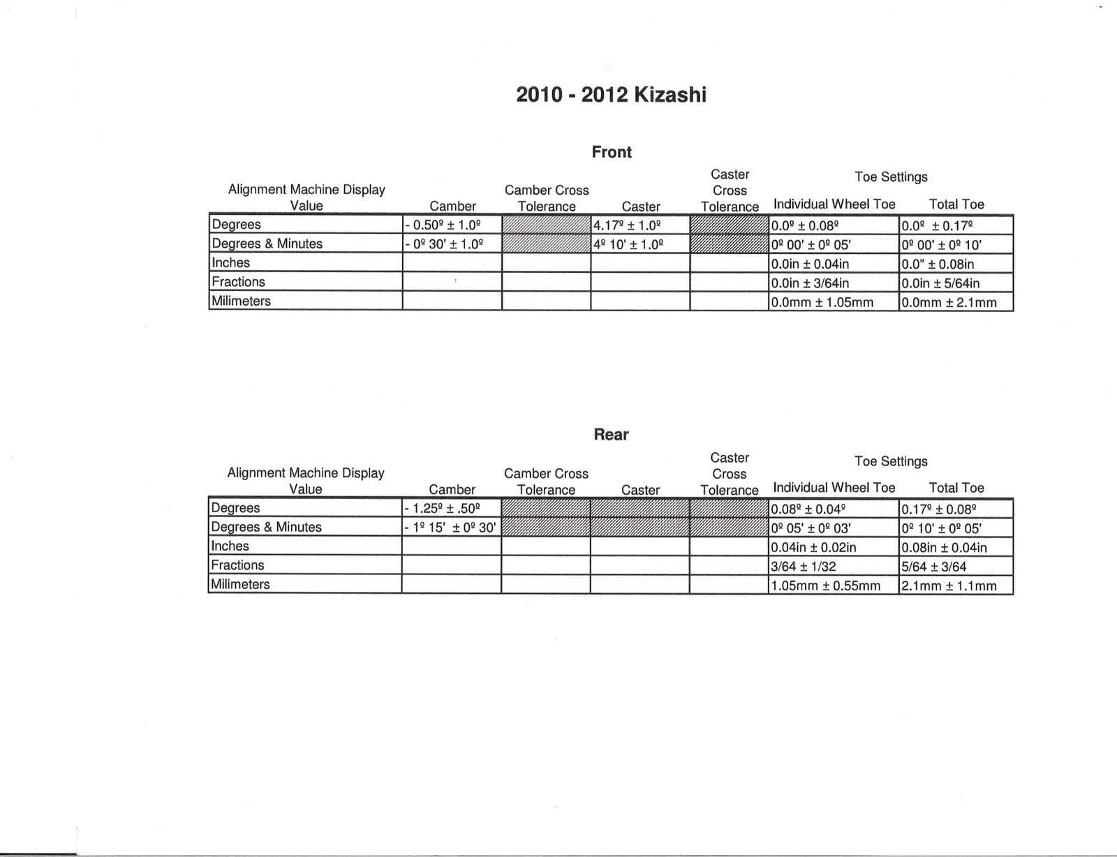

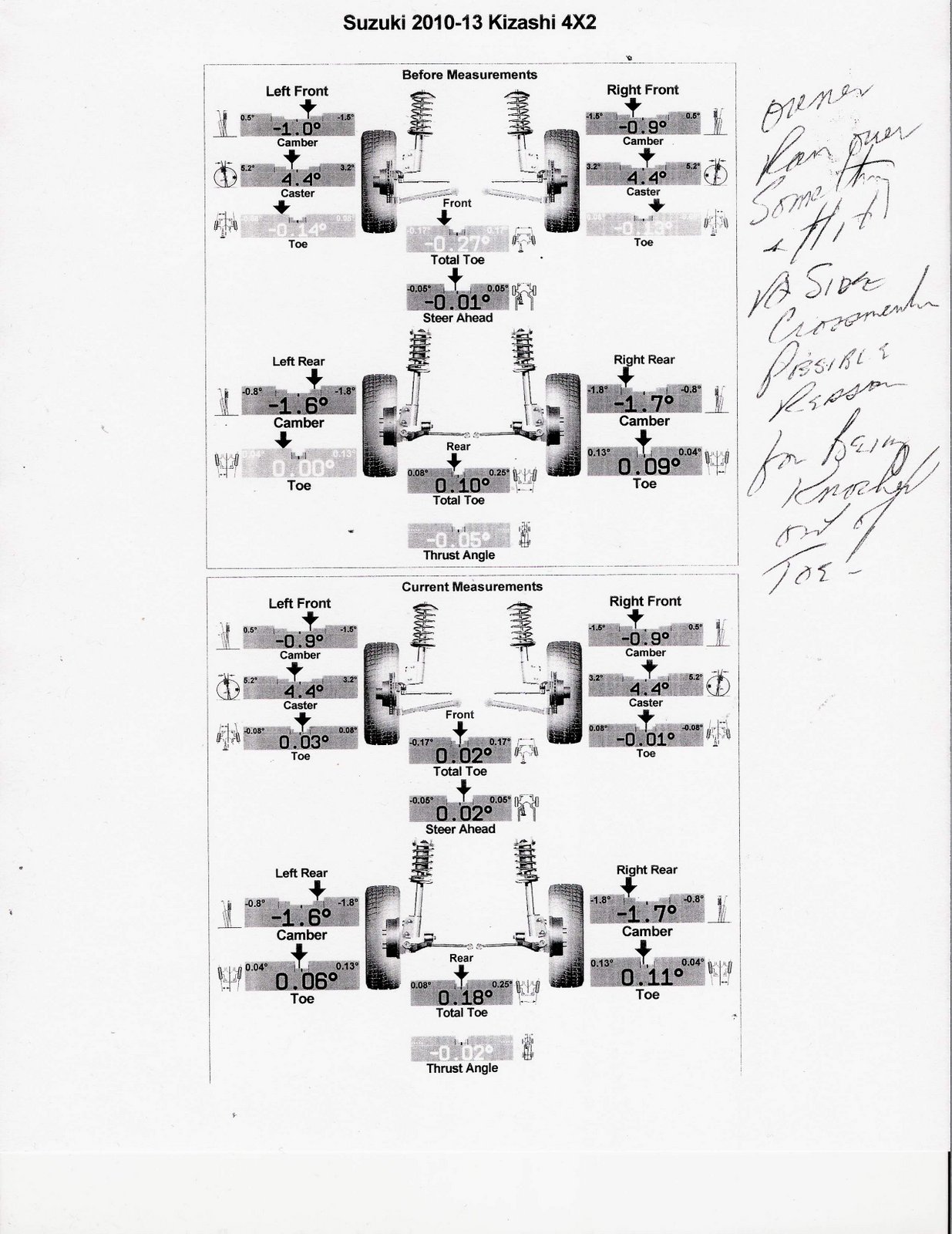

Sorry for the delay on scanning in the documents.
Below is my alignment data sheet and the Suzuki Info Bulletin specs.
The mechanic wrote on the sheet that he thought maybe the damage under the car to the cross-member put the car out of alignment (from when I ran over a parking block hidden under the snow), but my alignment issue and uneven tire wear long preexisted the damage because of the incorrect factory alignment.
Looks like the specs on their system are correct (as expected)
bootymac wrote:Looks like the specs on their system are correct (as expected)
Yup. Glad they were.
It looks like the alignment issue is really with the toe angle of the front wheels.
The corrected toe will help with handling a lot. I'm curious if it was like that from the factory, or if the parking block knocked it out of spec.
Camber seems a bit excessive but still within specs...

I'm sure this is because of the factory setting. Nearly everyone with the alignment issue states their front wheels wear excessively on the insides. If you see them on the rear, it was probably from tire rotation (in my case and noted by a few others).
I hit the parking block only about 2 months ago, but noticed the uneven wear starting long before.
It would be good if others who get their alignment fixed ask for the print-out and scan it in here.
The handling is better now with the alignment corrected.
