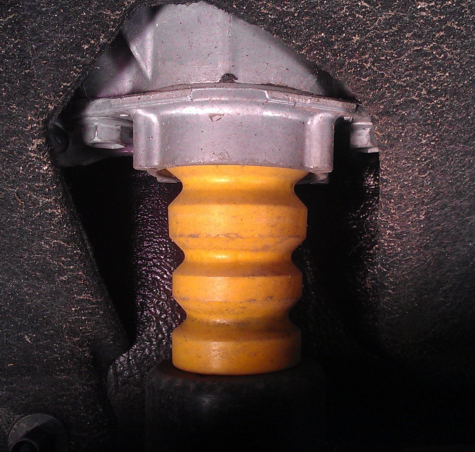

Sorry it took me this long, but here's a close up of what the countermeasure bump stopper looks like. Note the visible grooves cut into it.

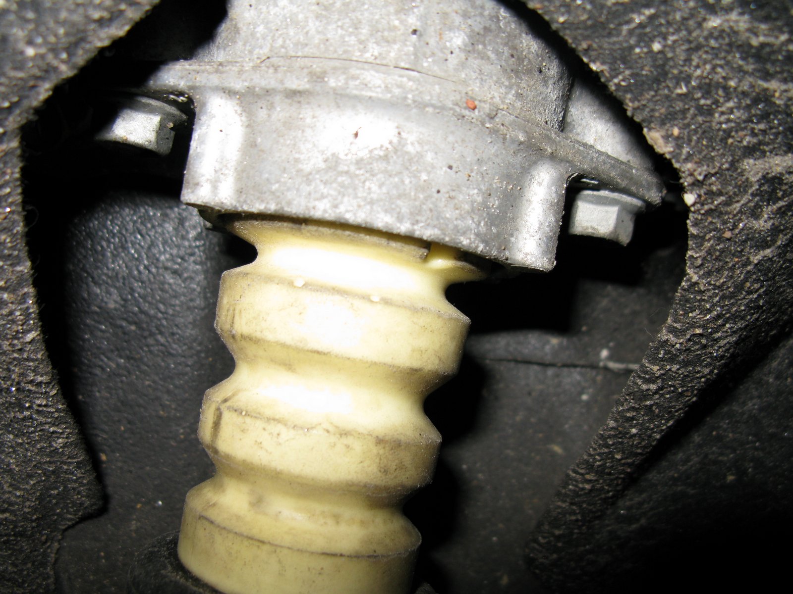

I am also uploading a pic murcod took to show the original part on his car. Note that it does not have the grooves.
Comparing the grooves is the best way to know if you have the countermeasure part or not. Color also tends to be an indicator. My old ones were the same color as murcod's. My new ones are the same color as the countermeasure display in the TSB.
KuroNekko's countermeasure bump stopper:

Murcod's original bump stopper:
