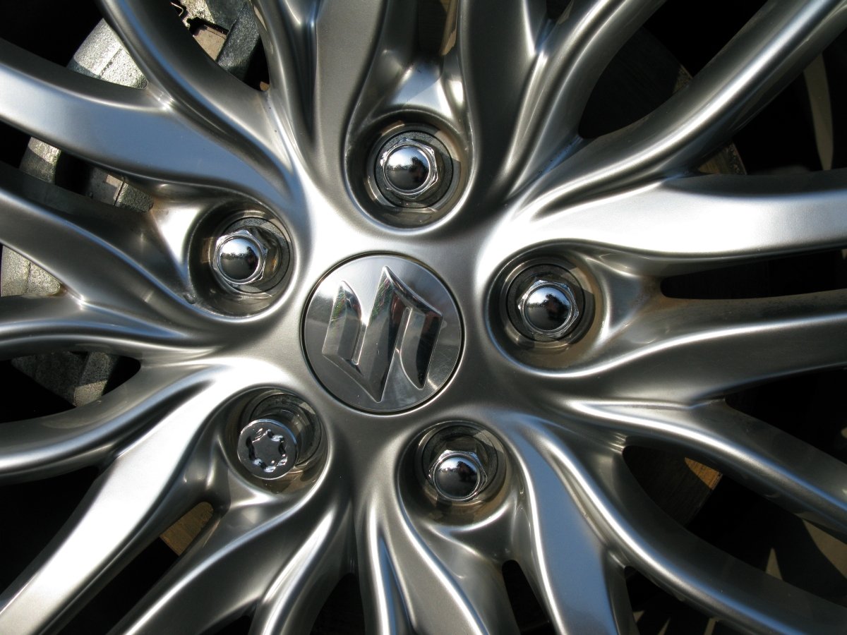

Finally ordered and installed wheel locks for the car. The correct size is indeed 12 x 1.25. In case anyone is interested in wheel locks, I got McGard wheel locks (acorn type) which fit nicely on the wheels. There is also enough clearance on the 18 inch factory wheels for the key. McGard makes most OEM wheel locks as well though mine were a aftermarket purchase.
