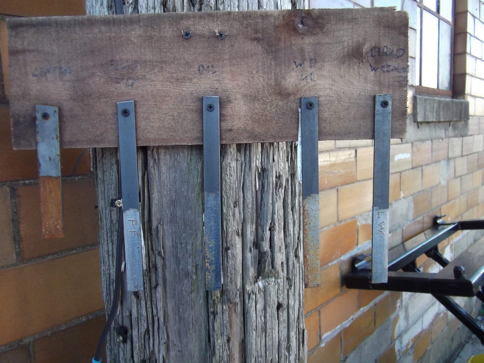

Here's a test comparing various rust inhibitors: http://www.tractorbynet.com/forums/oil- ... rison.html
Summary: LW lasted just as long as FF at preventing rust on bare metal that was exposed to the elements over 3.5 weeks

bootymac wrote:Here's a test comparing various rust inhibitors: http://www.tractorbynet.com/forums/oil- ... rison.html
Very interesting! Amazing in the second test that Liquid Wrench did better than even some dedicated rust-preventatives!
