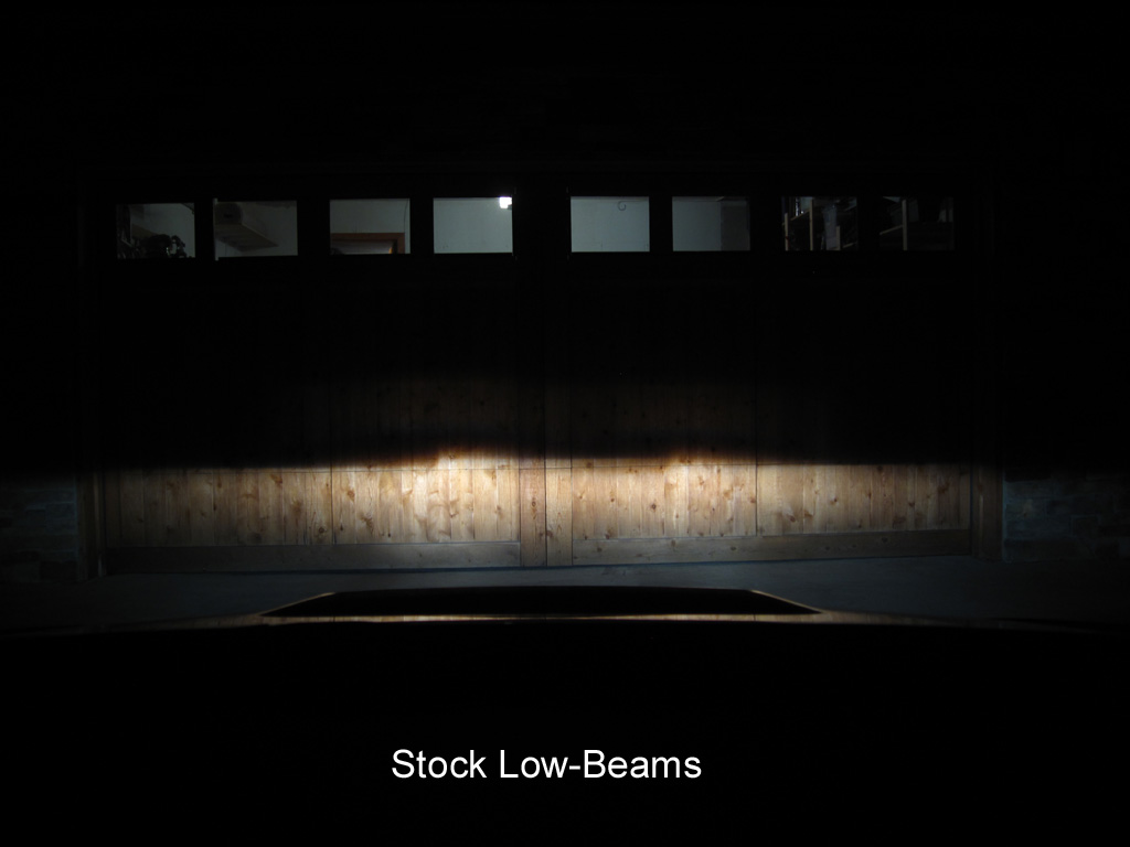

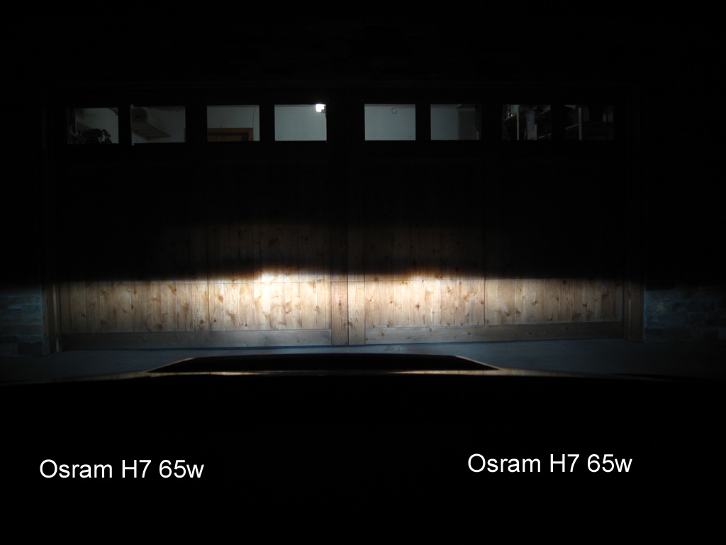

Here are some comparison photos with the Osram 65w bulbs:
http://legacygt.com/forums/showthread.p ... b0b7aeab7a&
They don't seem to be much brighter

I'm more impressed with the Toshiba HIR bulbs. I've heard about HIRs but never owned them. That being said, HIDs outperform HIRs and are probably why HIRs aren't so popular, especially given the rising popularity of projector housings that take HID bulbs well.bootymac wrote:Here's some comparison photos with the Osram 65w bulbs:
