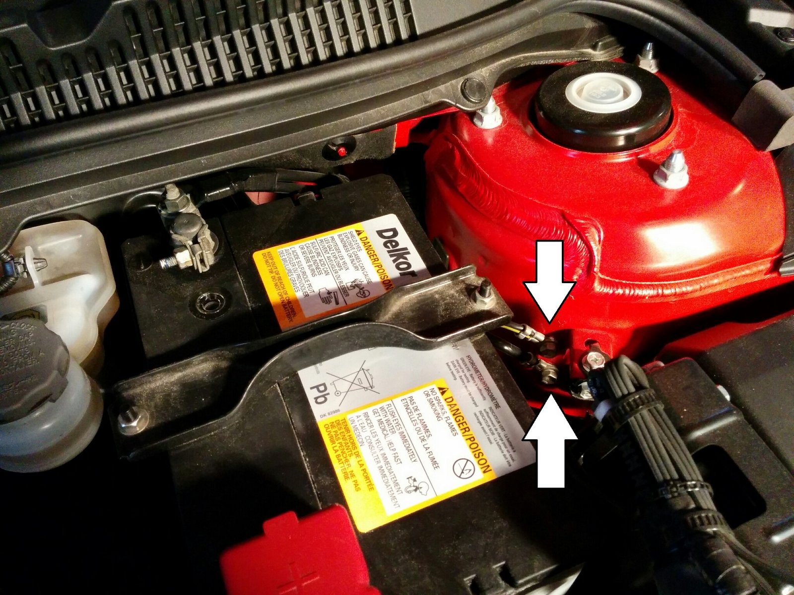

I took a quick look around the engine bay and I could only find three visible grounding points.
Two on the LHS strut tower. Both grounds appear to be coming from the battery's negative terminal:

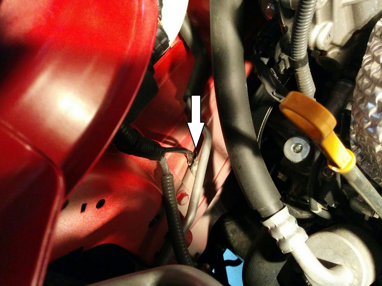

And one on the RHS:

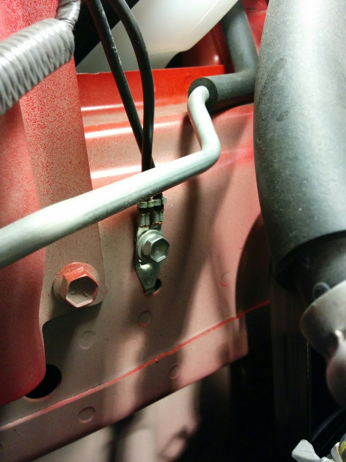

Close up:
Stock wiring looks pretty thin. Thicker wiring would probably help
