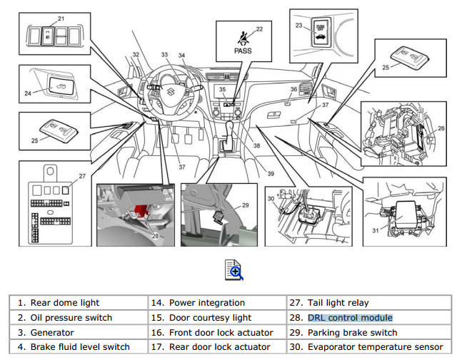

- The DRL system is controlled by the "DRL Control Module (E254)" located below the dashboard
- The DRLs turn on when the hand brake is released and the engine is on
- The high beams are also powered by the DRL Control Module
DRL Control Module Location:
DRL Control Module Location.PNG (102.82 KiB) Viewed 5287 times

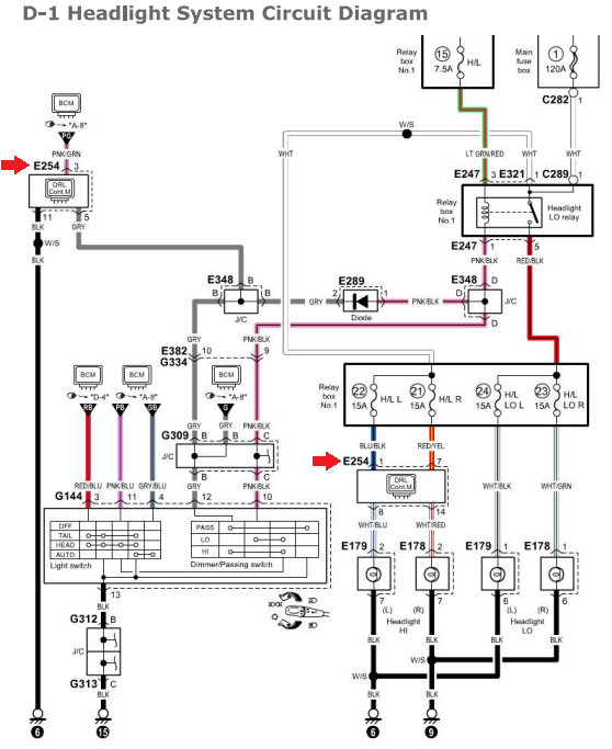

Wiring Diagram:
Headlight Circuit.PNG (76.54 KiB) Viewed 5289 times

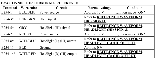

The DRL Control Module has 7 pins/wires:
DRL plug.PNG (7.26 KiB) Viewed 5289 times
DRL Control Module terminals.PNG (58.05 KiB) Viewed 5289 times
So pin 3 on the DRL control module (the pnk/grn wire from the BCM) might be the trigger that activates the DRLs. I believe that disconnecting this wire will disable the DRLs. While there isn't any information specific to the Kizashi, the following threads seem to support this theory:

Why not bypass the DRL module? eg. connect BLU/BLK to WHT/BLU and RED/YEL to WHT/RED.
It could possibly be done by unplugging E254 and using jumper wires in the plug eg. jumper pin 1 to 8 and pin 7 to 14.
Success! I've disabled the DRLs. Here's the DIY guide:
http://www.kizashiclub.com/forum/viewto ... =28&t=3012
