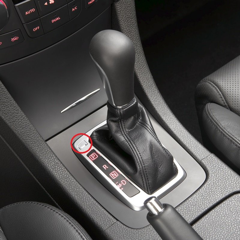

Well my wife lost our only key fob, on top of that I have to tow it an hr away to a dealership. Does anyone know how I can get the car in nuetral without a key??
I'm assuming it's an automatic. The tow truck driver will know this, but all automatics have a shift lock bypass. It's accessed by removing the small cover on the automatic's shifter. Once that cover is removed, you can use an object like a pen or screw driver to push down on a button located inside the shifter housing. This will then allow you to shift into any position without the key or engine being on.
I have circled in red the shift lock bypass access cover in the picture below.

Awesome!!!! I have just the two front wheel drive it all wheel. Than you.
