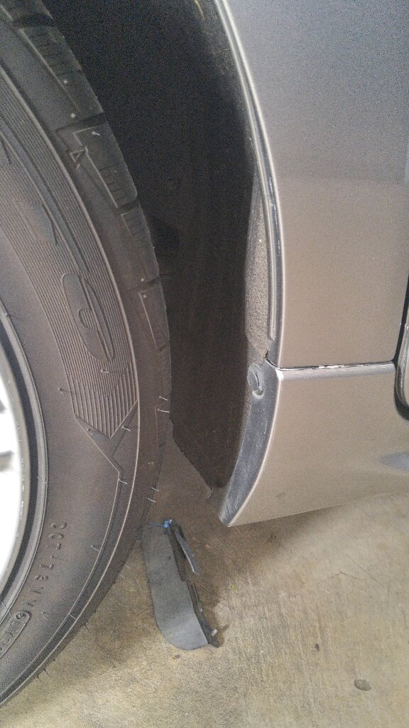

The other sad thing that I asked them about, was a tangling I had with a squirrel. I'm not sure who won on that though. The squirrel got flattened. But he got tangled up in the mini right rear mud flap. Ripped it off. Asked the dealer what I was looking at here and he said not only to replace the tiny mud flap, but the plastic it attaches to goes the whole length of the side of the car (not sure what you would call it) and, of course, would need painting. They suggested a body shop. So sometime next week I will take it in to my local body shop and see how many hundreds of dollars this will cost. Then will have to debate, whether it REALLY needs to be done. I hate squirrels!

And post a picture of the mudflap damage.
Ok. If you look you can see the mud flap laying on the ground. Above it is where it attaches to (as I just found out) the passenger side body skirt. And that is why the dealer said we are talking about paint plus the parts. I really think I am talking a few hundred dollars if I fix it.

Oh, so this is the little plastic flap located in front of the right rear wheel.
It's not a mudflap, it's actually an aerodynamic spat or strake. It helps direct airflow around the wheels to reduce noise/air turbulence/drag, etc.
I looked at the diagram and the strake is mounted separate of the side sill (the part your dealer recommendeds you replace) It appears to be held in by just one screw? I'd be surprised if you couldn't remount it by crawling under and having a look. Or just leave it alone, it's non-essential.
Actually there is two screws that hold it in place the one on the end (you can see it sticking out in the picture) and one on the other end that would screw into the plastic of the side body skirt. And that is where the problem is. That plastic is gone. So if I screwed that strake (thanks for correcting me, It sure looked like a mini mud flap) in on one side it would flop around because nothing to anchor it on the other.

Yeah...I'd say it's not worth it!! It'll be well over a grand if you get a body shop to quote the entire job, unless, you can source a salvage yard part. You may even get lucky and find one in the same color as yours to save on the painting. In which case, you could install yourself.
Epoxy the strake in place and put the one screw back in if you must have it.
