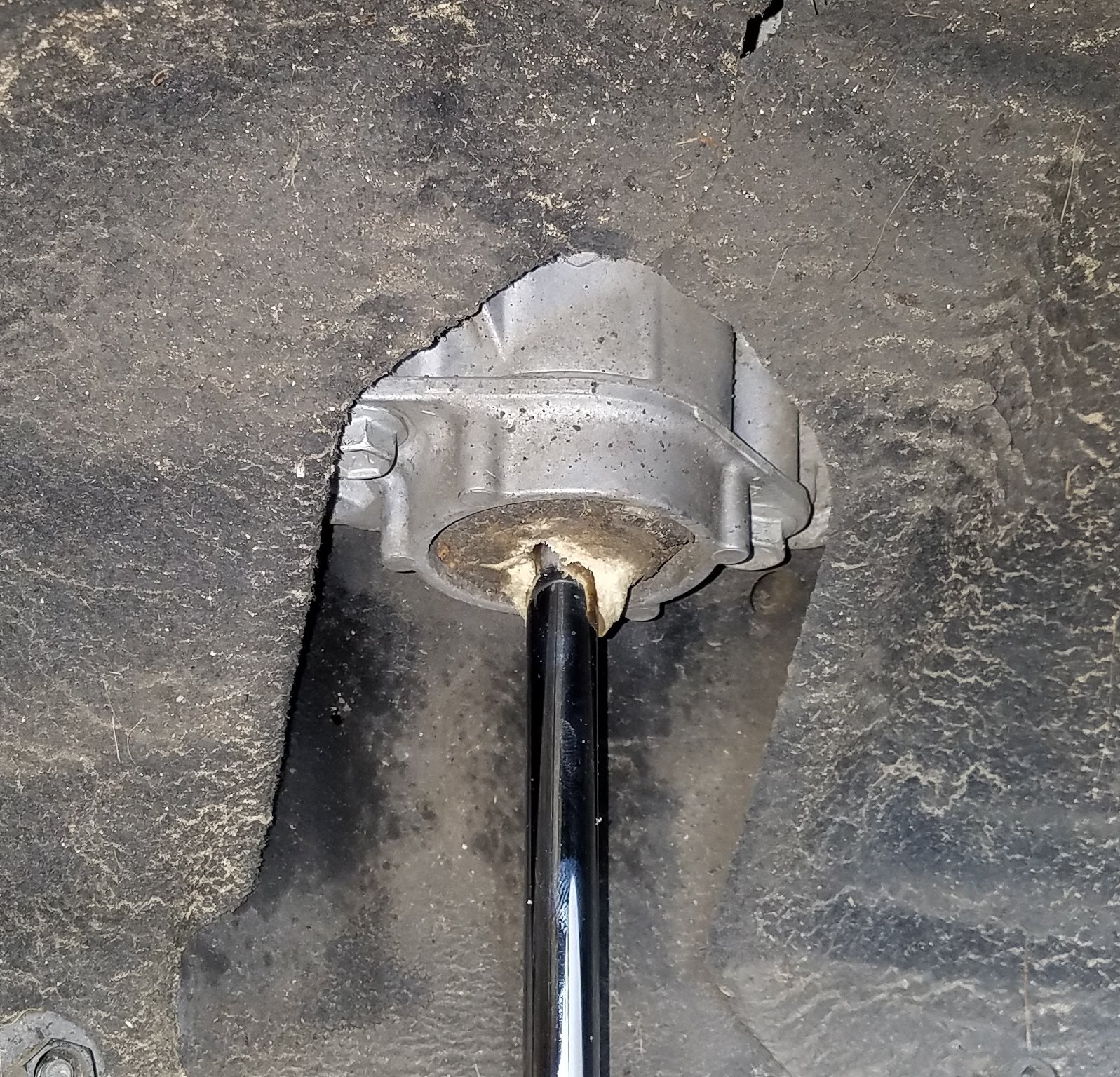

Thanks. I already purchased the rear KYB shocks. The part where tree shocks attach to appears to be broken/ chipped. I took picks butt I'm having a problem posting them. "File too big."
I'll keep trying to post the pick. (The part that is chipped looks like beige ceramic.)

This is what I was told needs to be replaced
That's the bumpstop BLyons was referring to. Not sure how it would get destroyed like yous is unless someone was jumping the car like the Dukes of Hazard. It's supposed to look like this, without the washing machine in the background:
You can either order the part # you see in that photo from an online Suzuki dealer, $32 each from here: https://suzukicarparts.com/parts/2010/S ... ent=Bumper or buy an aftermarket replacement part. Pretty sure KYB makes those too. RockAuto has the KYB replacement for $14.04 http://www.rockauto.com/en/catalog/suzu ... ellow,7592
What's nice about the pic is that the correct part number for the modified bump stop is right there. I wish I would have looked closer at the Rock Auto site before purchasing from the OE Suzuki place. The KYB SB113 from Rock Auto looks like the modified bump stop and it's only $14. They're $32 from the OE site.

Yeah, I think it was one of the dukes of hazard. Lol. Plus, the bad roads here don't help. I'll be ordering the bump stops asap.
