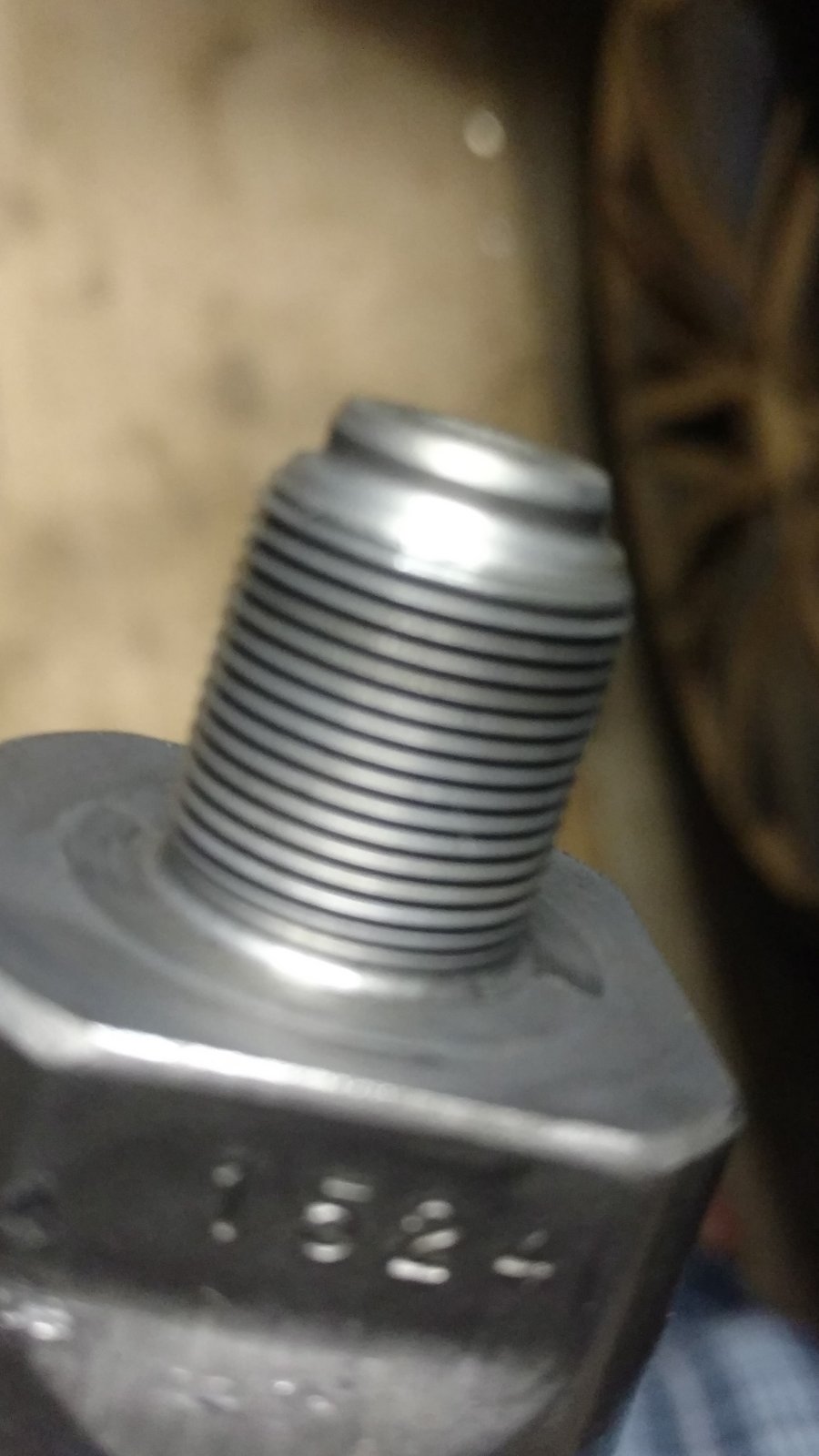

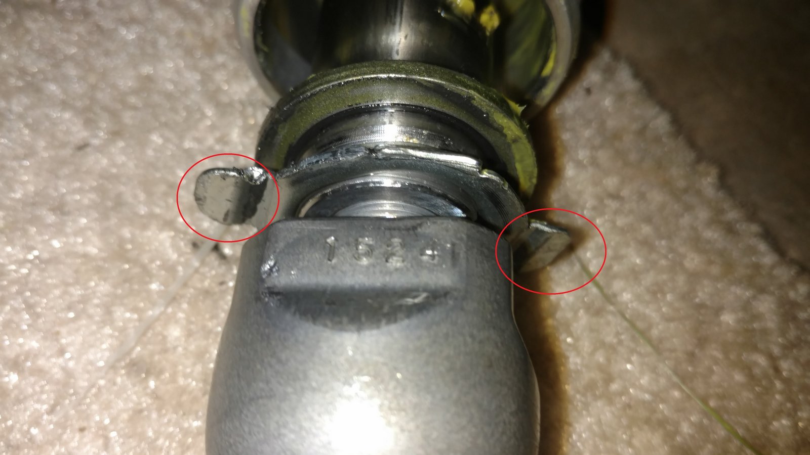

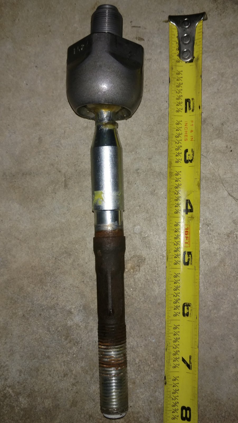

Sorry for the delayed reply been busy. I ended up buying one from ebay for $105 free shipping from NY and it's fixed now. The replacement was straightforward watched a youtube video ( chrisfix "How to Change Tie Rods" ). I rented the inner tie rod tool from an auto parts chain *free if returned within 2 days. Afew things I ran into just incase anyone else needs to do this . 1. There is a clip claming on the tie rod use a flat head and a hammer and unbend them enough to put the tool on properly . 2 after you replace it and test drive it you might get hill hold and eps disabled error. I got scared and thought I might need to replace the whole rack. I read up on how the Bosch system works and turned out it uses the steering wheel angle sensor (along with a few others) and I know it needs an alignment (Steering wheel was not straight when I was going straight ) and the so I adjusted the alignment (tow?) so the steering wheel is straight when going straight and now everything is good . Now I just need to take it in for a proper alignment. there are a few slimmer looking tie rods from moog (in the US anyways ) so incase anyone wants to try and find a replacement I put up some pics. The inner tie rod is around 7 3/4 inches . Thanks for all the suggestions .
Clip claming on the tie rod
