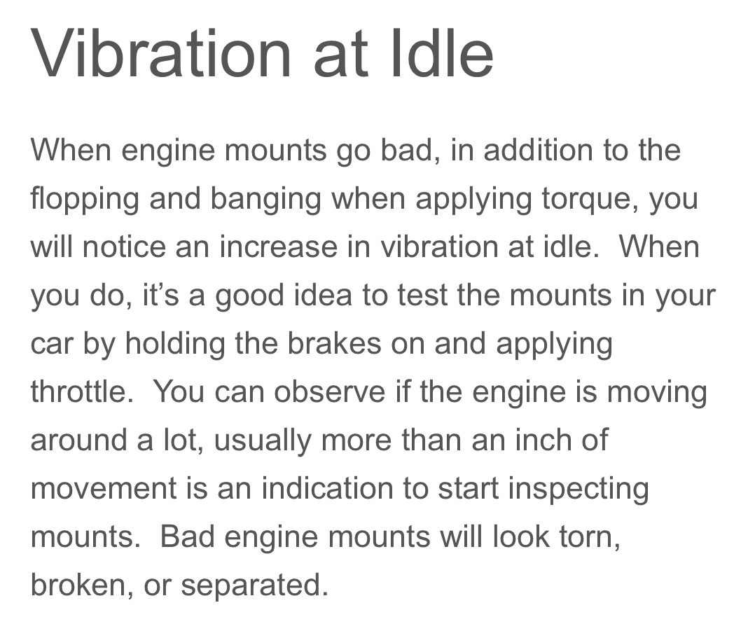

No codes? Perhaps a motor mount.
- 18C3014F-3D28-442A-B178-B05F692D8AC7.jpeg (298.09 KiB) Viewed 11513 times

Is the car supposed to be in gear with the hood up when you go to rev the engine with the brakes pushed?

Yes it should be in gear. So make sure you trust with your life whoever is in the drivers seat. But probably best to stand on the side of the car.

My previous reply looks like a great way to get hurt. So let me clarify. The reason I suggest putting it in gear is it’s the best way to put the engine under enough torque to show if there’s a bad mount. Reverse would be just as good as a forward gear. You’re not looking to make the car move. Just enough throttle to get the engine to move against the mounts.
