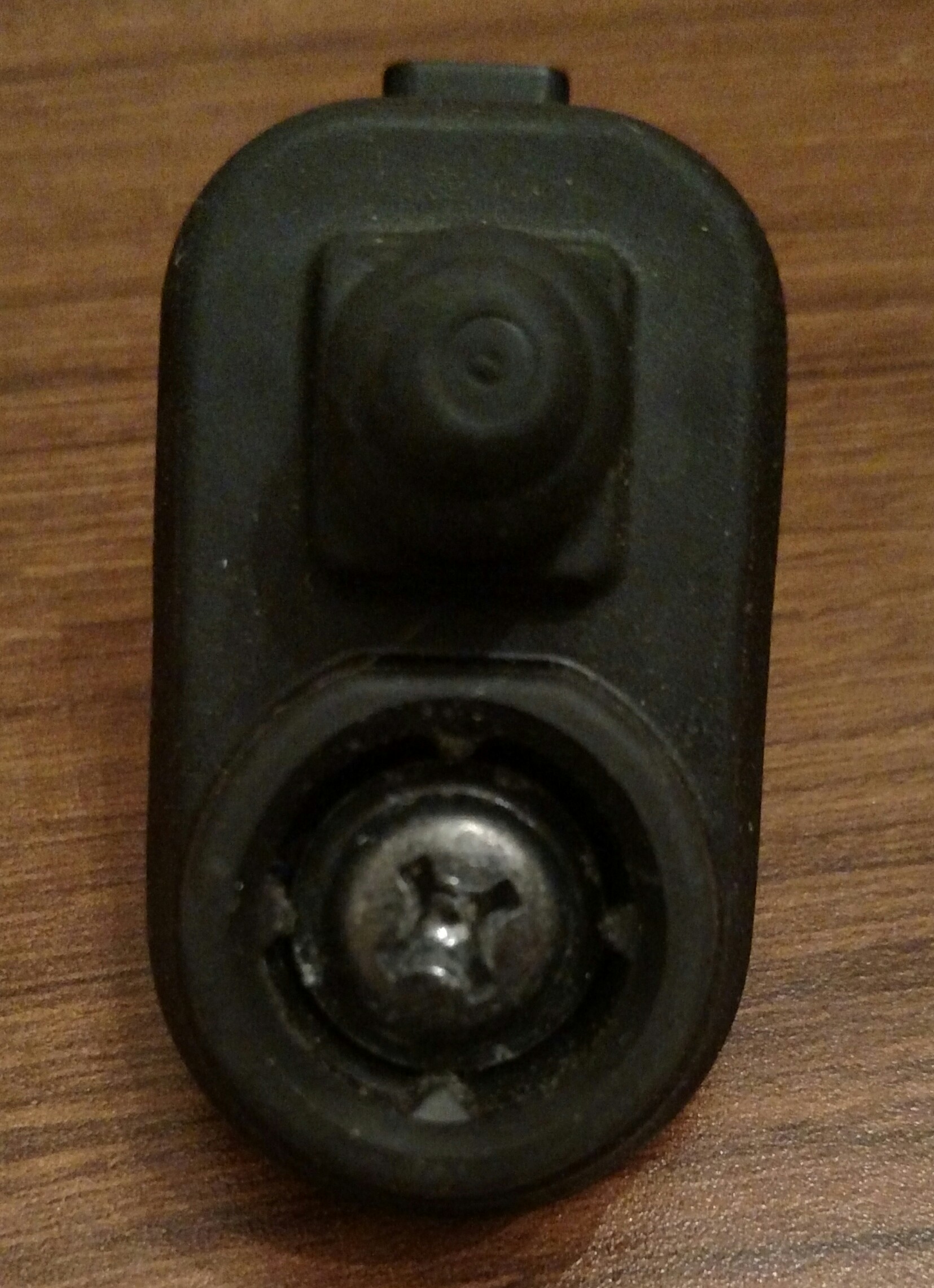

THE FIX
With the Kizashi, the wheel lock engages when you open the drivers side door after you turn the car off. You can hear it. When you open the drivers side door the open door dash light comes on. When you press the black spring loaded rubber button on the door frame while the door is open it goes away. The trick is to trick the car into thinking the drivers side door is closed so the wheel lock never engages.
Step 1 - Try to start the car even if it takes a while, do not give up. Because the error is intermittent it will eventually start. The car has to start for this to work.
Step 2 - While the car is running open the drivers side door and get out the car. On the door frame you will see the black rubber button that depresses when the door is closed and also a phillips head screw above it.
Step 3 - Unscrew the screw with a phillips head screwdriver and unplug the switch. ( Keep the button somewhere where if you ever need it again you can get to it.) When you do so you will not see the open door light on the dash.
Step 4 - That's it!!!!!!!
Now operate the car as you have been before the problem. You can lock and unlock the car with no problem. Removing the button disables the wheel lock. No wheel lock no problem.

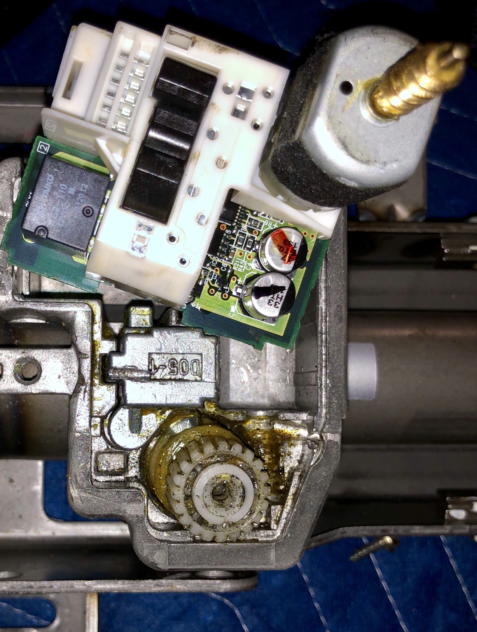

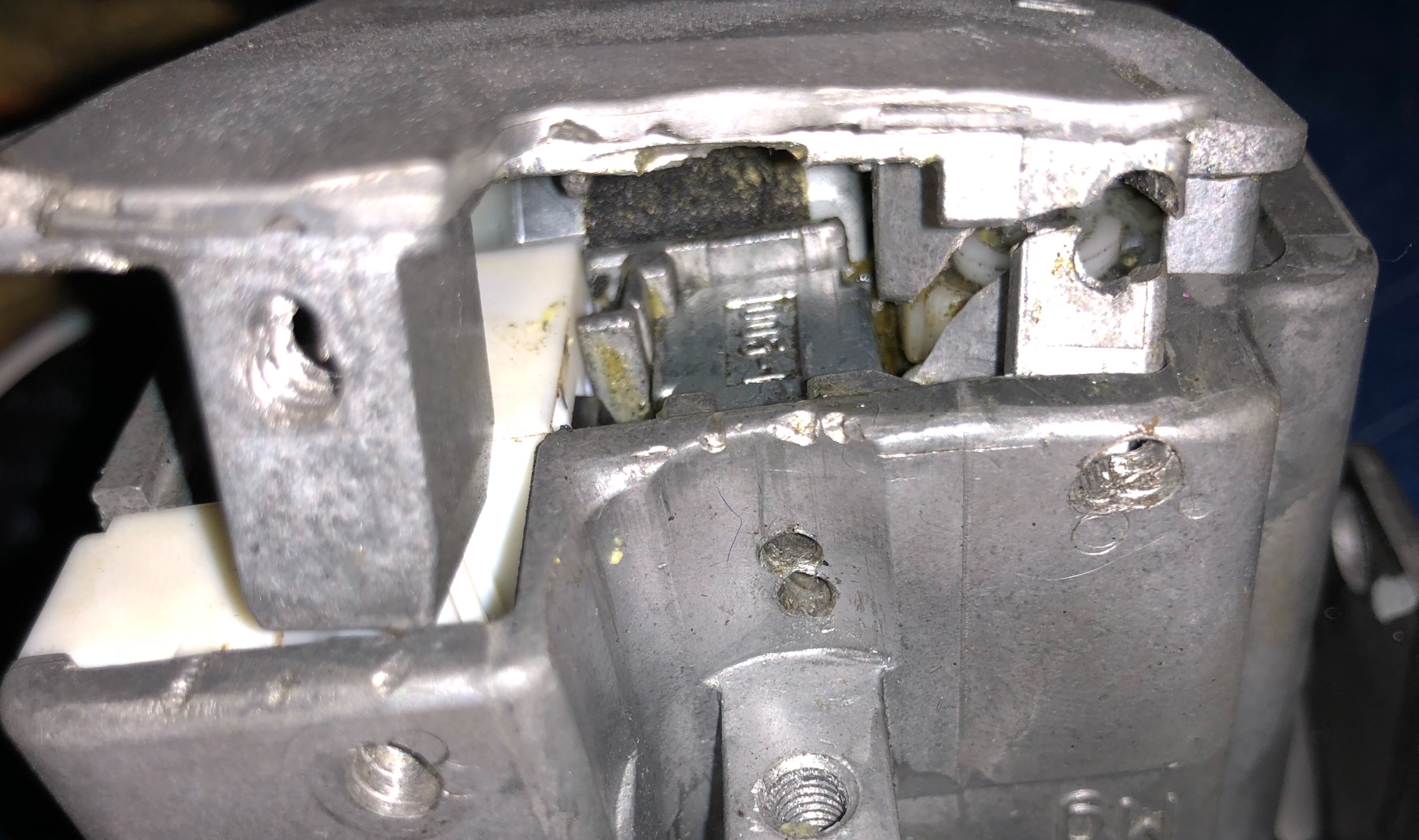

So I did replace the steering lock in my kizashi its all in one unit that’s part of the steering wheel. I bought one from the salvage yard on ebay once it arrived I dismantled it. 1st I took the cover off it has 4 grooved dowels so they were drilled and tapped out, once uncovered I tried my best not to move the gears while I removed the electrical circuit board and replaced it with the one that originally came with my vehicle because the key FOB and this circuit board go together. Once replaced I covered it back up and reinstalled it in the vehicle works great no issues until the switch on the circuit board fails with time.
