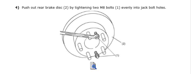

Nope, no screws on the Kizashi rotors. They are only there (when used) to speed assembly during manufacturing. The clamping force of the lugs is what holds the wheel and rotor firmly in place. I know many Honda owners who curse their presence, and cross their fingers that they won't need to drill them out.
I have changed brakes on numerous different vehicles including VWs, Chevys, Mazdas, Subarus, and Suzukis and none have had screws holding rotors to hubs. I think only a few brands have these to possibly prevent rotor warping from when wheels are attached and torqued down incorrectly, causing the rotor to be mounted off-balance.
Many rotors, including the Kizashi's OE rotors, have threaded holes in them for an opposite purpose. These are used with threaded bolts to actually help remove rotors from hubs if they are stuck on from corrosion. It's better than pounding them off which risks damaging the rotor if one plans to reuse them. The use of the threaded holes for rotor removal is actually noted in the Kizashi's service manual and worked for me when I needed to remove the rotors.

I've never owned a vehicle that HAD any screw/bolts holding rotors in place. None of the GMs we've owned had them. All my zuks had/have the M8 threaded holes for removal. Have used them on the Samurai plenty of times. Haven't changed rotors on any new zuks ever (yet) that I can recall.
