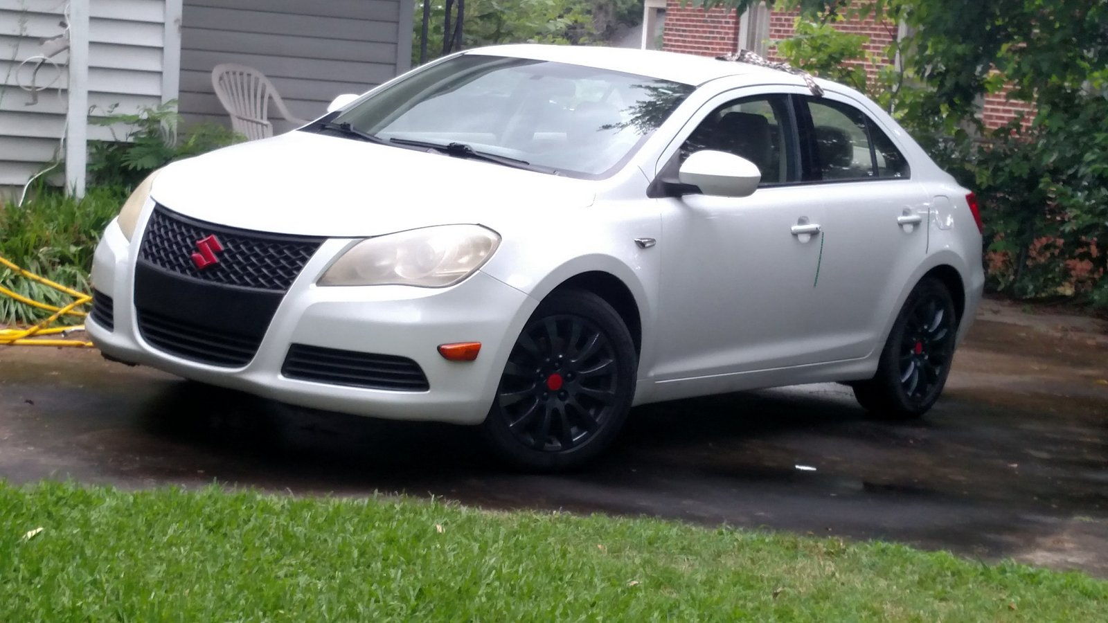

Are those the Stock rims? What'd you do, paint them? I want to do mine, I just don't have the tools to take them off, etc. :(

motosonic wrote:R.I.P.
If you have a spare tire in the trunk, you should have the included tools to remove the wheels from the car. There should be a scissor jack, lug nut wrench, and crank handle in the tray above the spare tire under the trunk. Most people paint wheels themselves with them off of the car but with the tire on, just covering up the tire with tape and newspaper.
They are plastidipped. Didn't take tires off just wrapped brakes and rotors with trash bags and sprayed with tires on. Center caps removed and sprayed as well. Very easy to do..Coated black with metalizer so at night the black is shiny and a deep dark blue.
