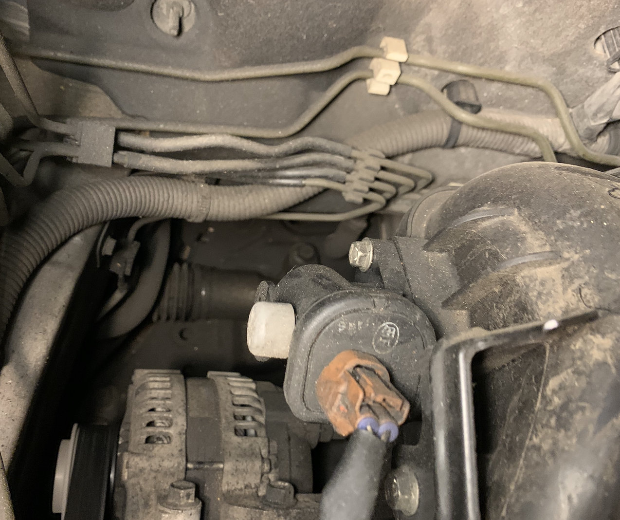

Hi,

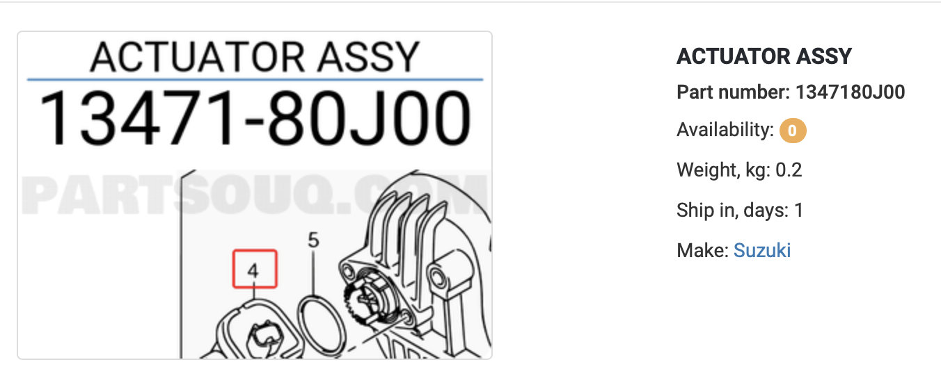

Have you solve this issue on your Kizashi? I'm having the same problem with my Kizashi 2010 - the code P050A is causing me some issues, and my mechanic recommended me to replace it. Here is the part number of the idle air control valve. Hope it helps.
ACTUATOR INTK CONTROLLER VALVE - 13471-80J00
You can look this on Partsouq.com and then type the part number, and there will be a diagram.
Also, you can find it here: https://www.suzukicarparts.com
I live in Dallas, TX and called the dealership a few days ago and they told me it costs around $175.00 and it will take around 1 month to arrive. I also called a dealership in Mexico and they told me it cost $70 dlls / $1,500 pesos w/taxes
This part is located on top of the serpentine belt, on the back of the engine, you need to remove the cover to find it. My mechanic showed it to me, and its easy to remove (the cover and the Idle Air Valve Sensor.)

That is not an idle control valve, since it is not connect to the air intake in front of the throttle body. It appears to be the IMT actuator for the variable length intake manifold system the Kizashi uses. The idle is wholly controlled by the ECU and the electronic throttle body, though could be impacted by other problems with the intake such as obstructions or vacuum leaks.Snook_86 wrote:Hi,
