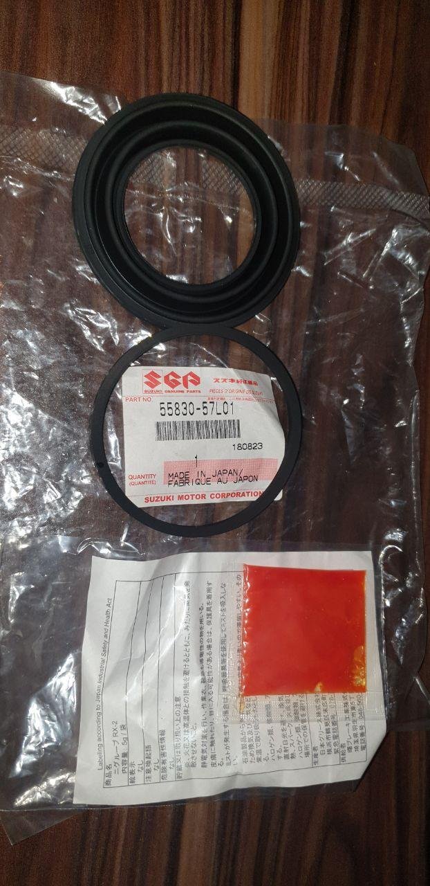

I bought OE from megazip not installed yet also comes with special grease.
kizashi brake piston bearing 55830-57L01

Here in the states we are told that OE part has been discontinued. The Carlson brand is excellent and cheap. Less than $5 us.
