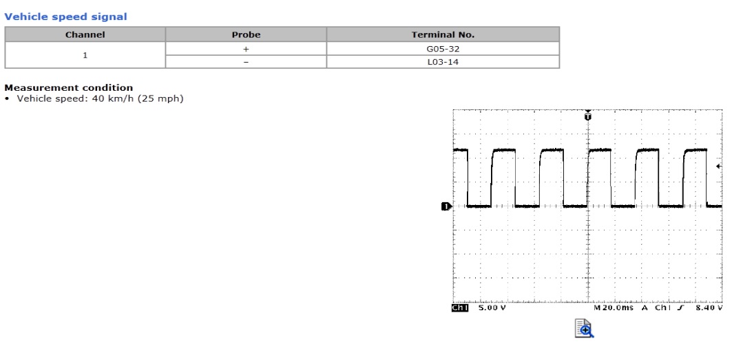

according to the service manual, there is a VSS (Vehicle speed signal) this signal is a square wave signal relative to car speed and its frequency is changed by car speed.
Process this signal by microcontroller then I activate all car lock signal when the car reaches a specified speed.
