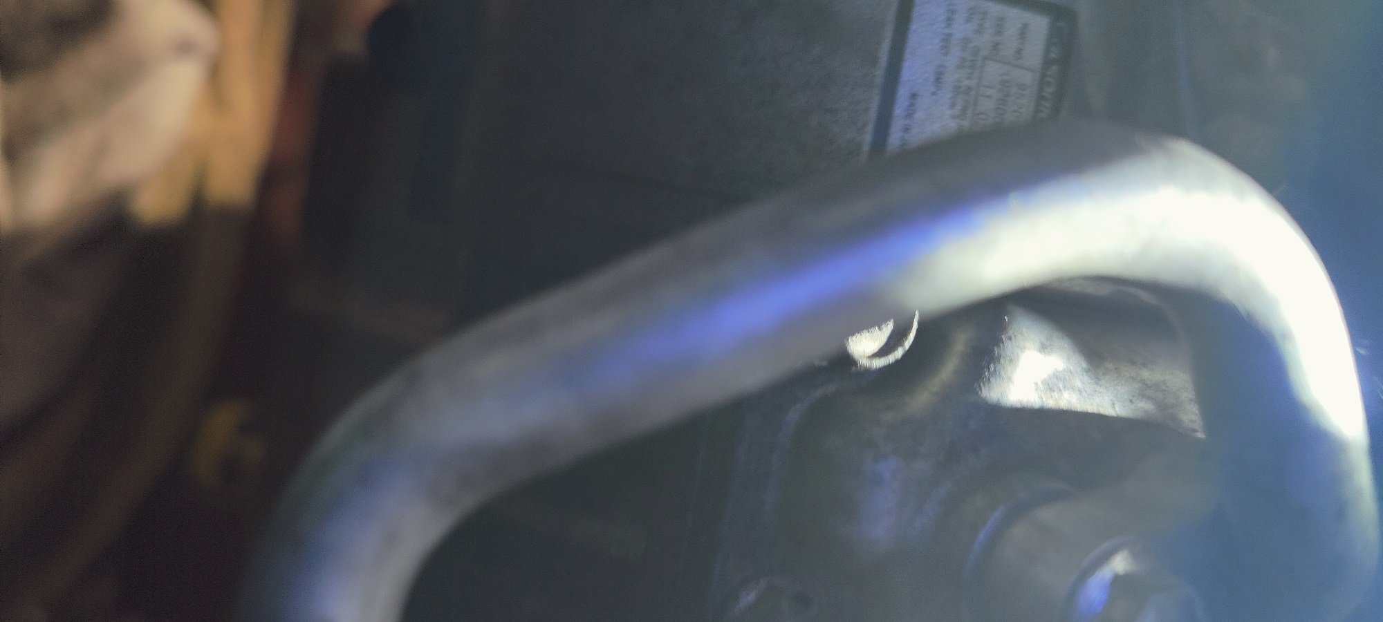

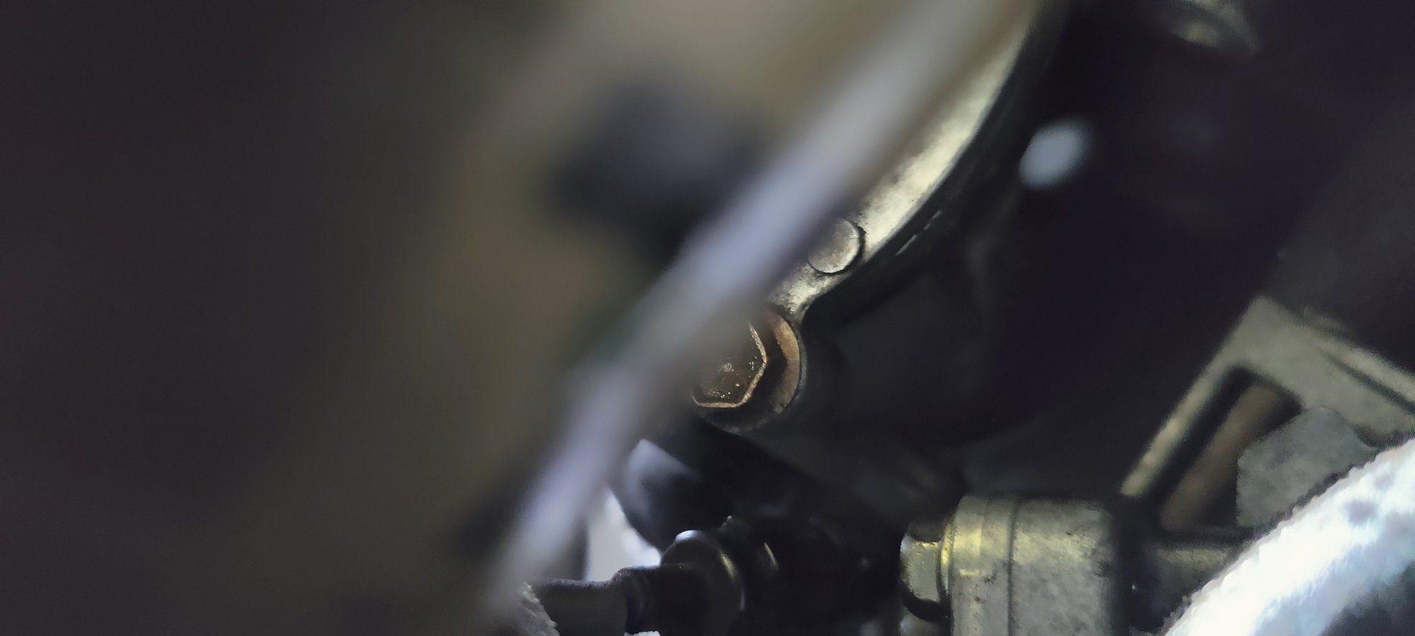

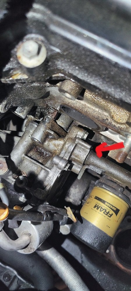

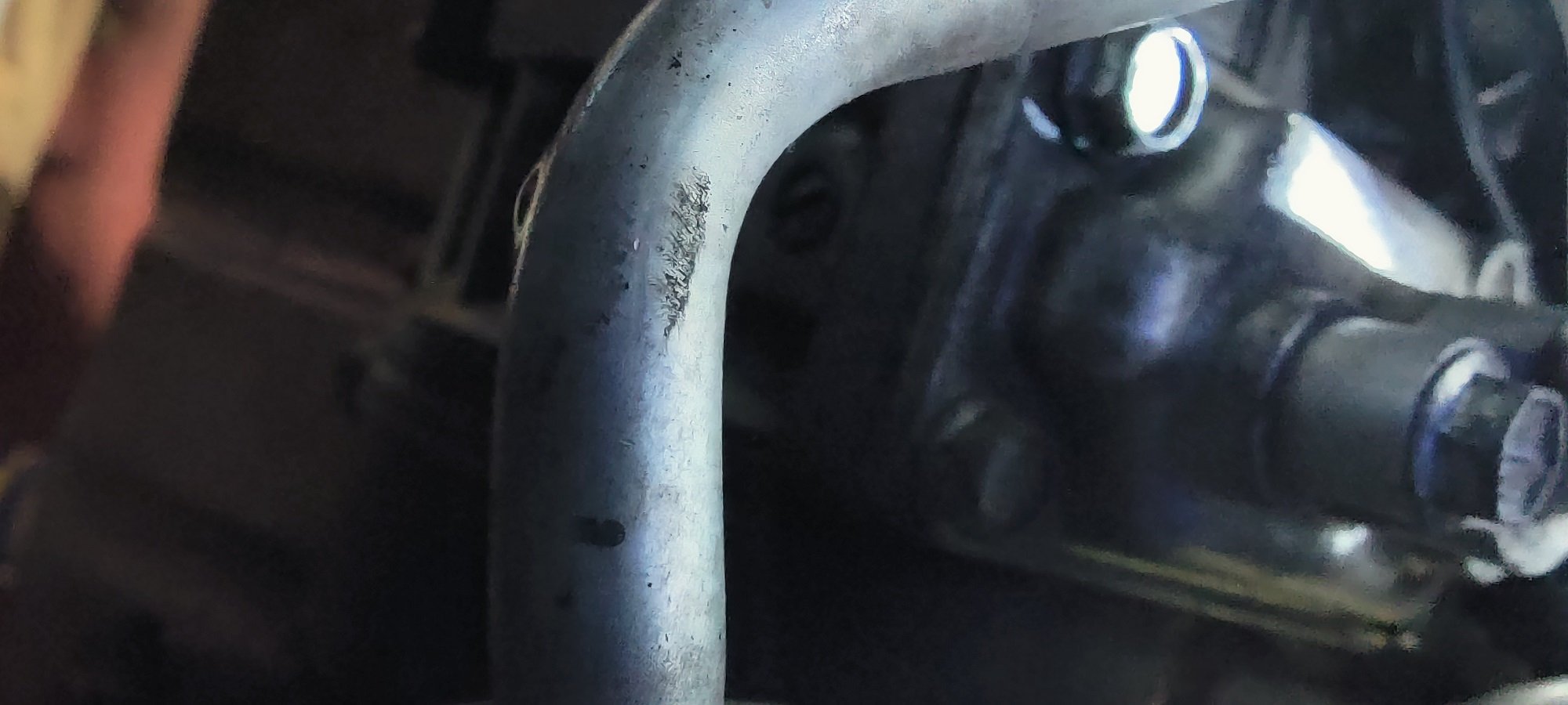

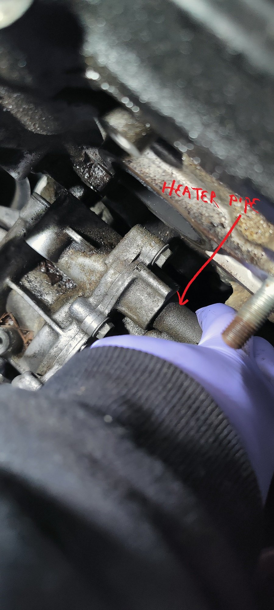

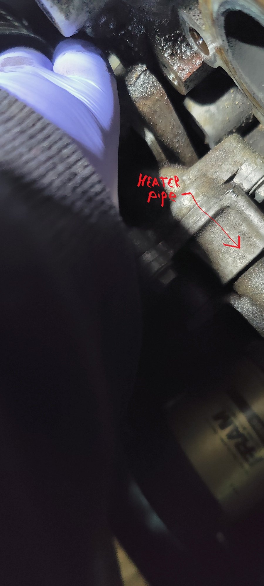

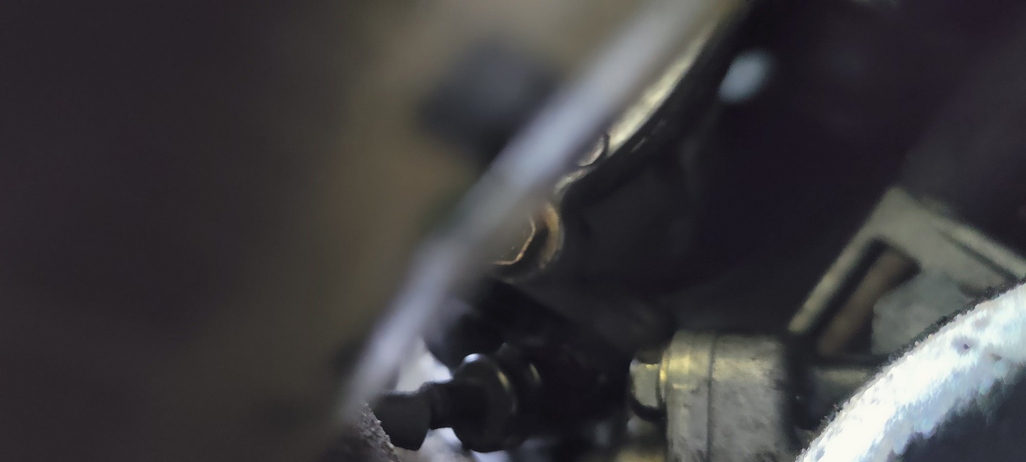

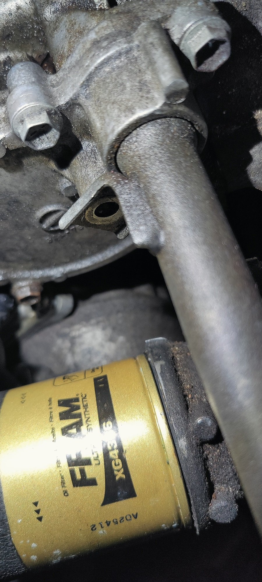

Thanks Woody. Do you know where the bolt is? I still have the thermostat housing on, but everything else is loose. I removed the bolt as seen in the picture, but I'm not aware of where the bolt that holds it in is located. I added photos of me trying to hold the camera below the waterpump. Also, FEAR THE TURTLE!! I went to U. of Md in College Park. HUGE Caps fan and WFT fan also

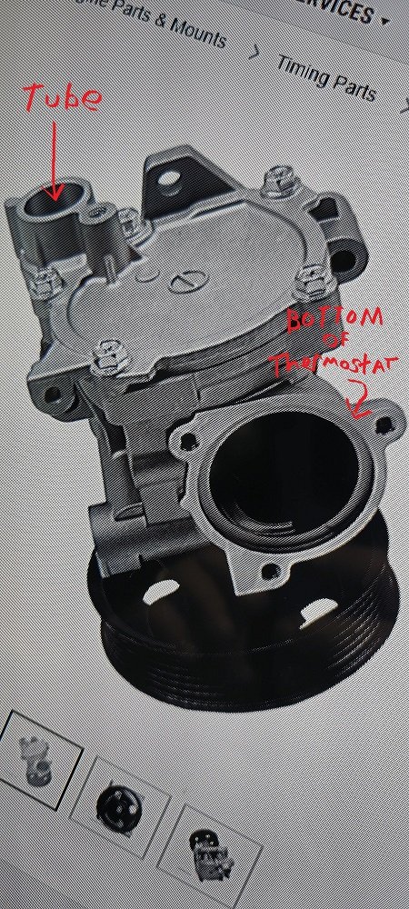

Just went and looked closer, there are three bolts holding it on. You've got the one out of the water pump, there are two more at the other end, over the transmission. Sent you an e-mail, if you reply back I'll send a PDF direct to you. Here's a poor drawing from a parts website. There's a bolt at each end of the pipe and one at the right angle bend where it turns towards the firewall.
