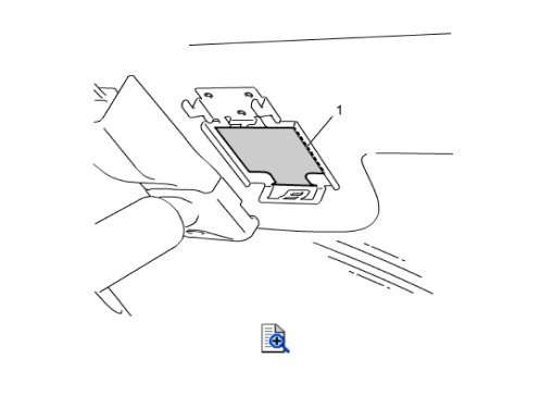

I mean this

I assume that to get to it I grab the mirror by the stem and pull/lift it towards the roof of the car?
Ah, and one more thing - should that silicone pad have been replaced with a new one when they replaced the windshield? Or the new windshield contained a new one? I was there, but didn't know what to look for...
No need to change
