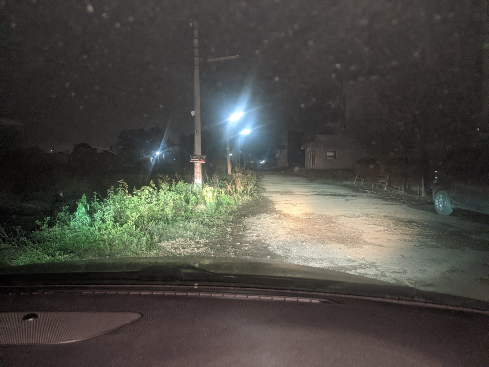

Hello guys, I recently installed HIDs in the projectors. I need help adjusting the focus of the lights.
The screw to move the lights left or right does not do anything, mechanic said the screw is broken. How can I adjust the low beams? The light points too far leftward.
Also, how can I adjust the high beams? The up down adjustment screw only moves the low beams. My high beams also point very down. I'd like to move their focus upward.
Thanks.

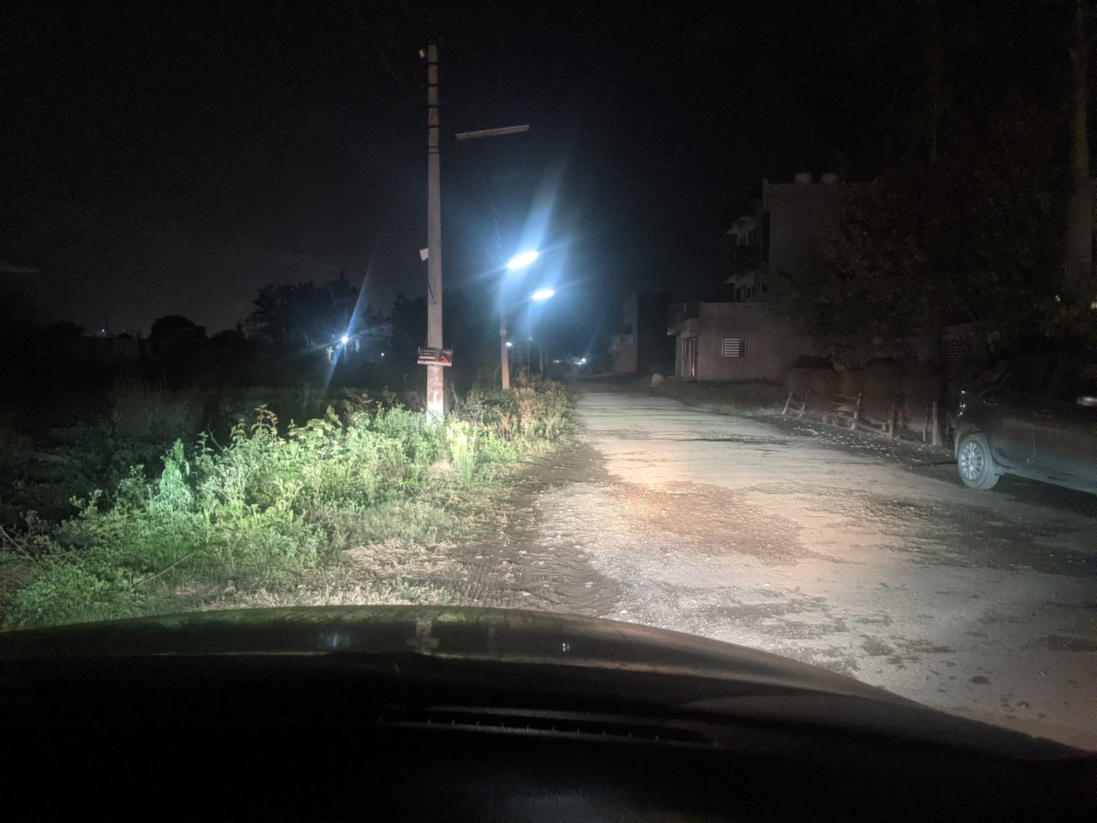

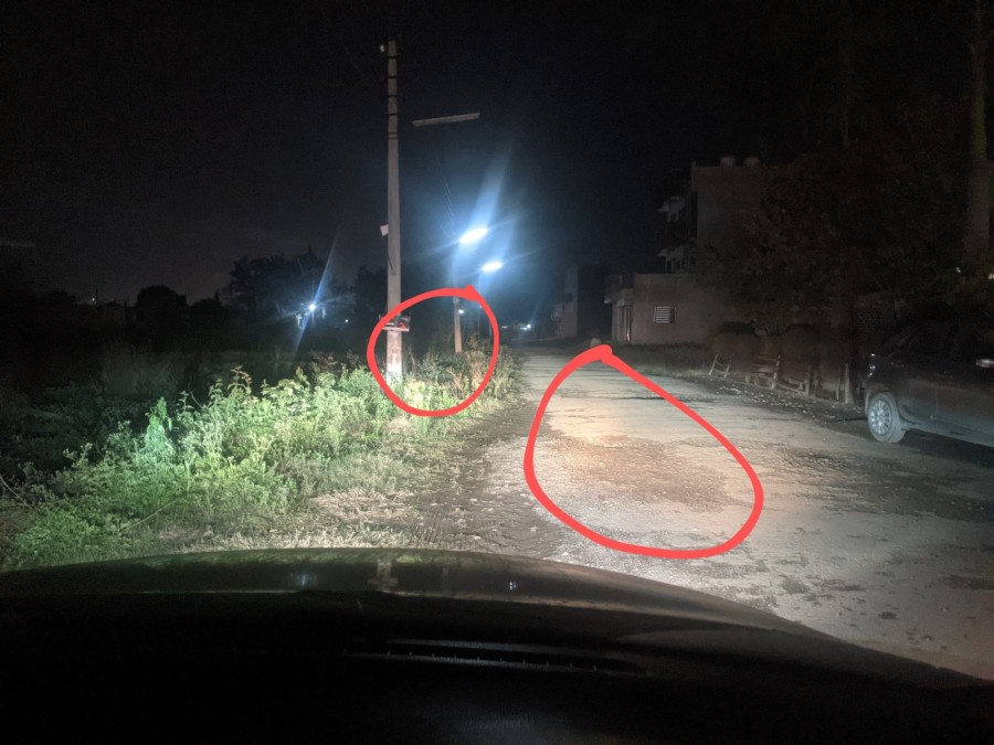

The right hand side high beam points too far rightward and down, check attached picture.
Notice the right (yellow) high beam.
Removed headlight and made sure bulb is seated properly. Any fixes?
