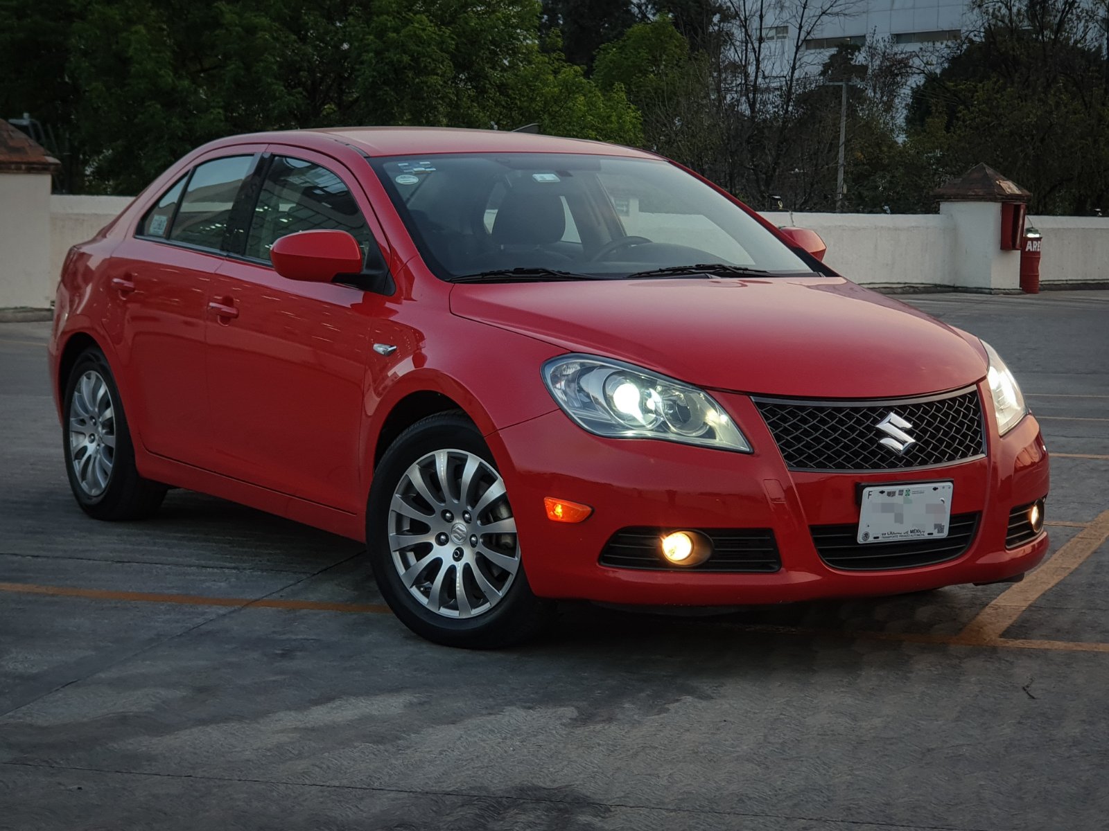

(I tried to upload a picture of my Zashi, dont know if it worked lol) Thanks again.

Nice car. Was your thermostat stuck open? That would seem to explain poor fuel efficiency. As for the Jetta and Camry, what model years are they? I ask because the Kizashi is really a vehicle running mid-2000s powertrain technology thus would be significantly less efficient than newer models with direct injection and such.
