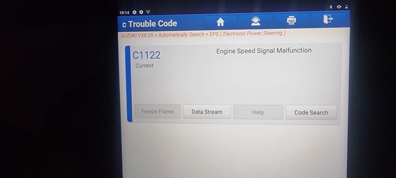

I am facing this issue since i changed the Spark.
RPM fluctuating when i go over 60 km. Also when cruser on.
After scanning codes are c1122 c1161.
And from my account on alldata attached this is the sloution i founded

hello,
according to the service manual if your engine is not running during DTC check you might read this code and after starting the engine code disappear then you do not need to worry about it it is normal.
