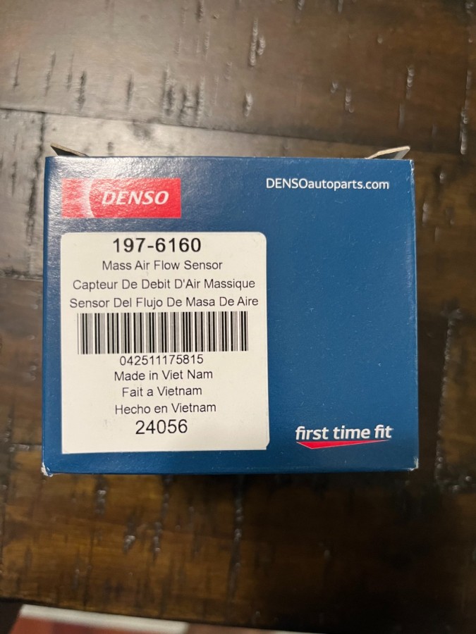

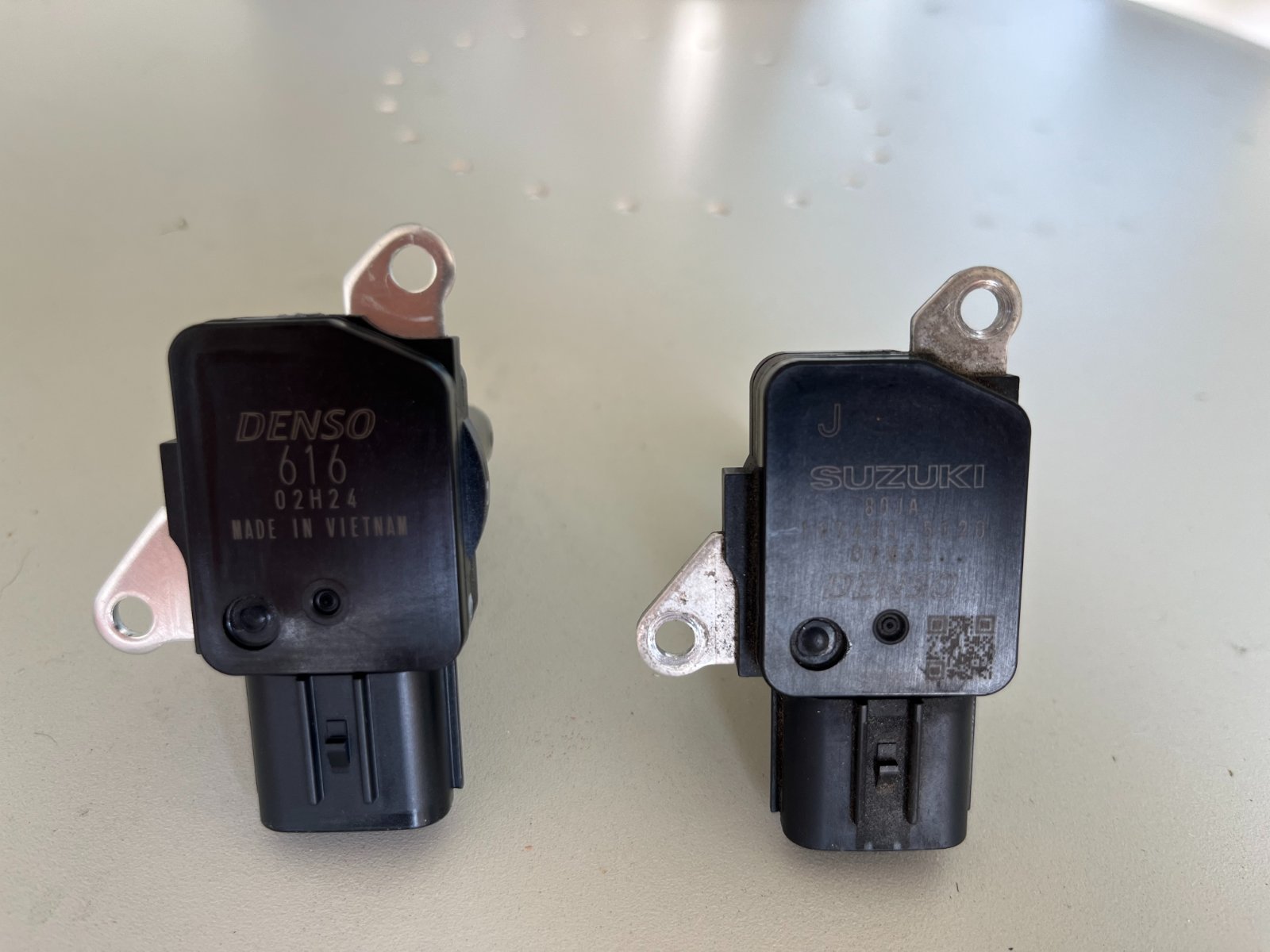

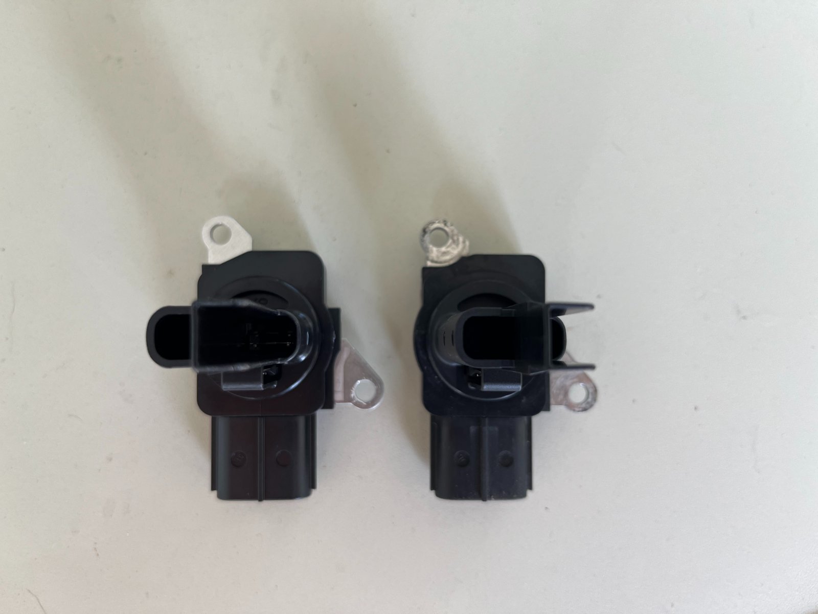

I received the Denso MAF sensor #197-6160 I ordered on Amazon. It looks like an authentic Denso aftermarket part with the only difference in expectation being it was made in Vietnam instead of Japan. Perhaps some Denso aftermarket parts are made outside Japan to keep costs lower. Regardless, the part and packaging looked legit and the product matched the design and materials of the OE Suzuki part made by Denso.
The fit of the new part was even better than the original part as perhaps the O-ring of the old one had shrunk over time. This would perhaps explain the MAF issues with moisture just about every time I washed my engine, even if the sensor itself was not directly covered with water. The new sensor had a much better seal onto the intake tube. I also used new and bigger screws for the sensor given the plastic base for the screws stripped out over time.

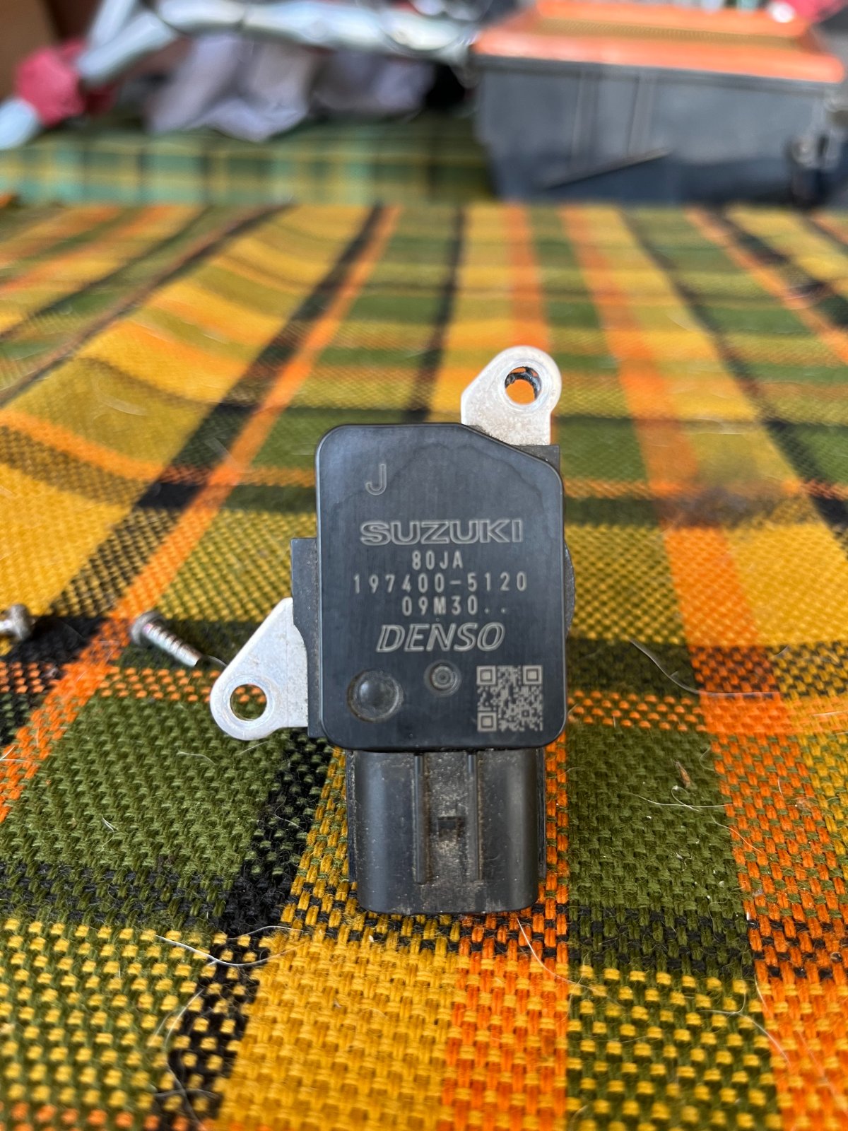

Original part:
Denso aftermarket:

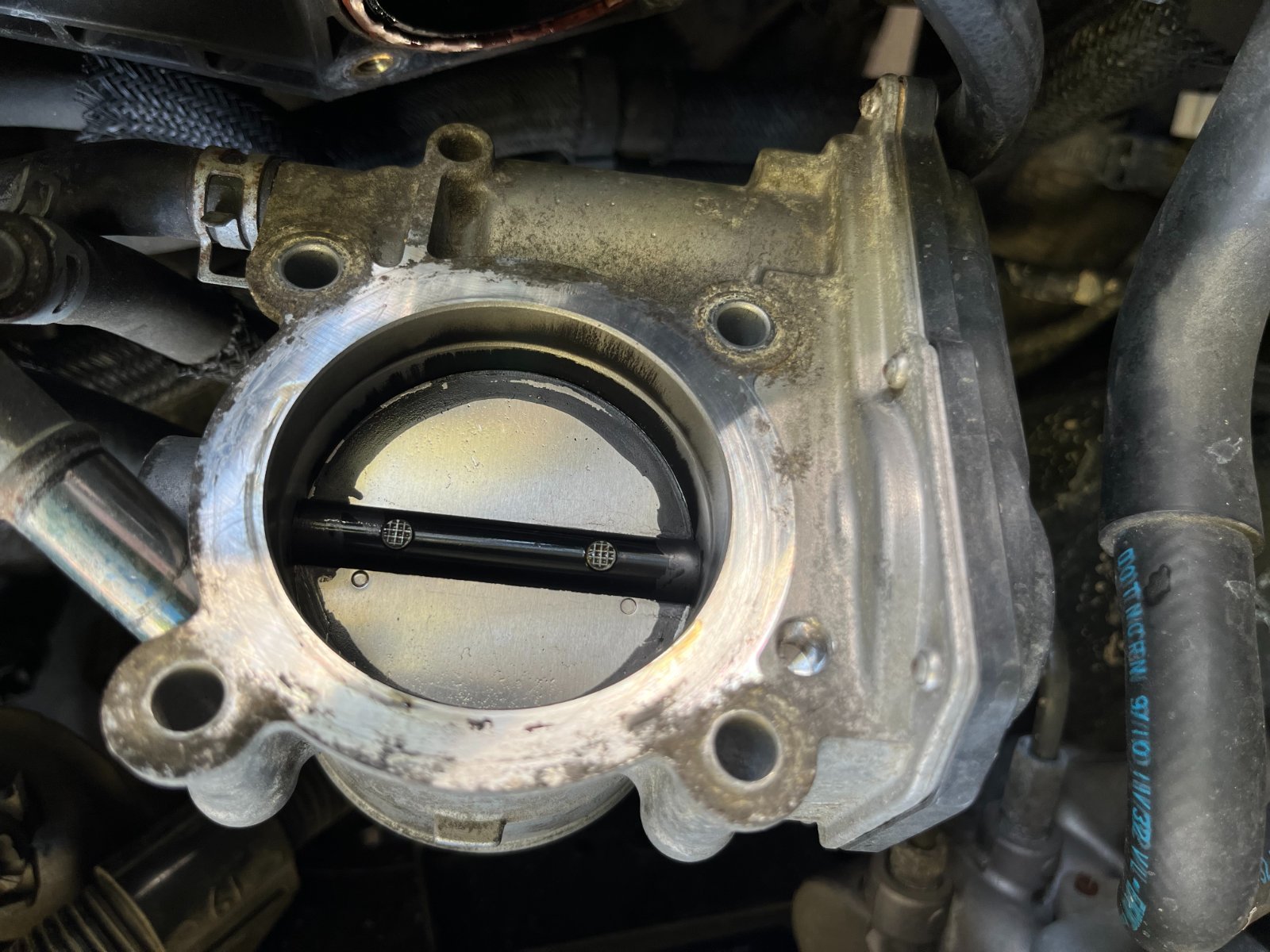

After disconnecting the battery, did you completely remove the throttle and clean it? Then do you need adaptation with a program?
2012 Suzuki Kizashi Sport GTS 6MT FWD (Silver)
BatNasko wrote: Tue Jul 16, 2024 12:13 pm After disconnecting the battery, did you completely remove the throttle and clean it? Then do you need adaptation with a program?

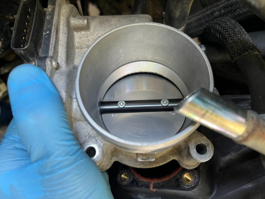

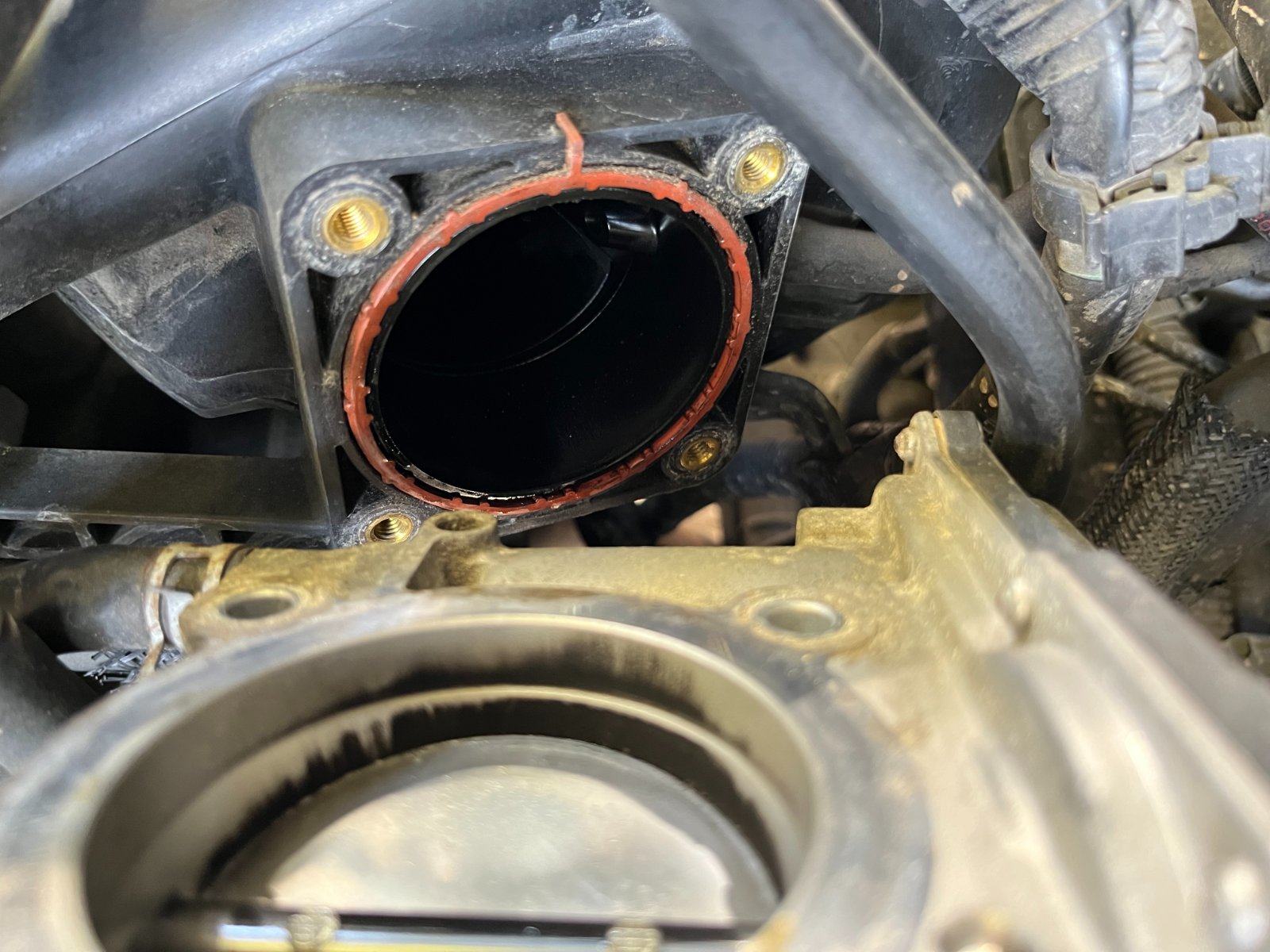

I don't completely remove the throttle body when I clean it because it appears there is a coolant hose that runs through the throttle body, probably to keep it from freezing up in very cold weather. While it can be easily removed, I rather not deal with coolant leakage and introducing air into the cooling system. The throttle body can actually be serviced on both the front and back with the coolant hoses attached.
The throttle body does not need programming. I once made the mistake of not disconnecting the battery before cleaning the TB and the vehicle idle was irregular afterwards. I disconnected the battery for a while which resolved the issue. This time around, I disconnected the battery before TB cleaning and everything has been running perfectly since.
As for cleaning, I used a carb and throttle body cleaner which works a lot like brake cleaner but might be less harsh. I used a microfiber towel for most of the cleaning but for the ring of deposits where the closed TB blade contacts the housing, I used a plastic scraper after soaking with cleaner. It takes some effort but you can get it clean. I would say completely removing the TB would be easier for cleaning but it's not necessary.
I took some related photos when I removed it so I'll post them below. All photos were taken before cleaning.
Front of TB:
Rear of TB:
