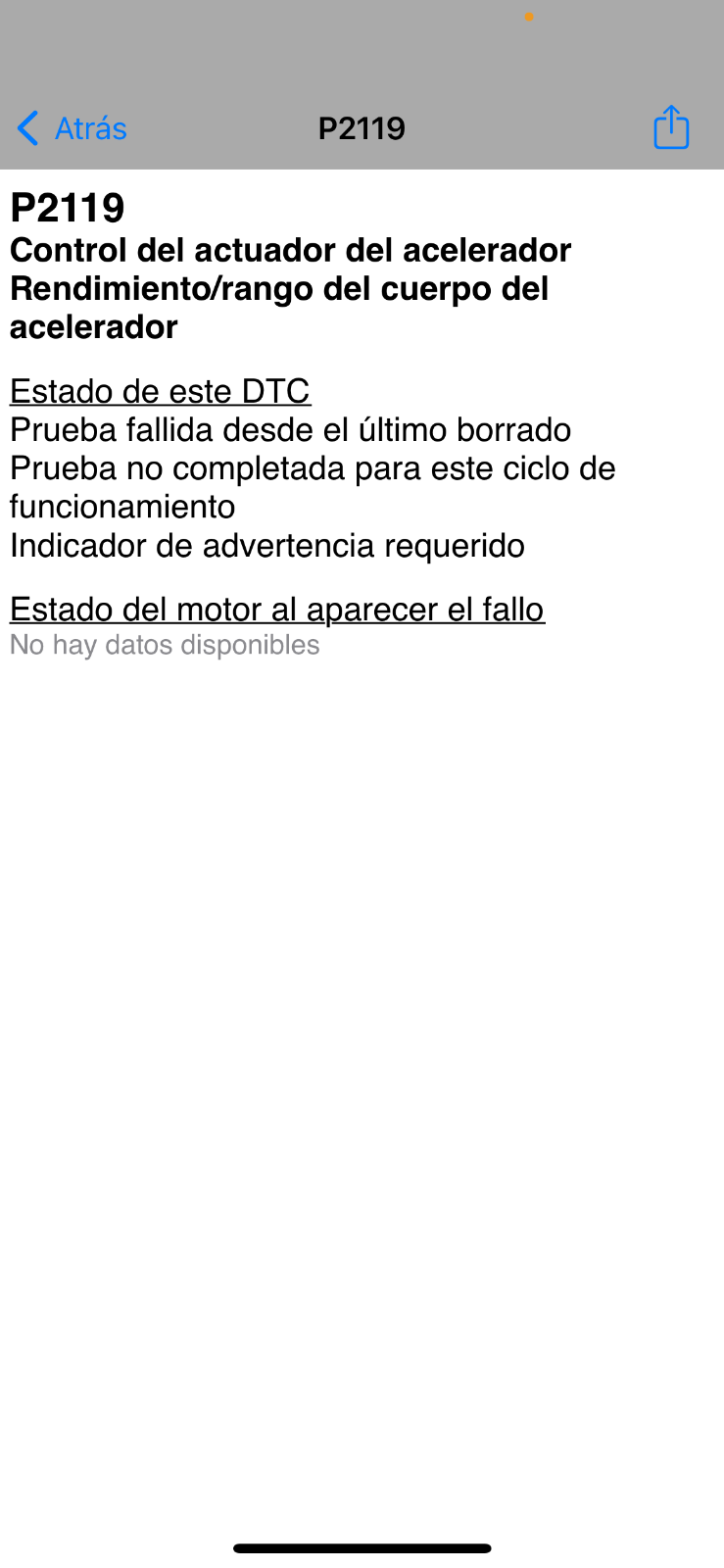

One day, with the car idling, it started to accelerate by itself and showed the Check Engine light. After scanning it, it gave me the code P2119 related to the throttle body butterfly valve.
I couldn't use the vehicle because the butterfly valve didn't work well, as if it was out of calibration. I hired 2 people with a professional scanner to calibrate the butterfly valve (thinking that was the problem) but they couldn't. Apparently it can't be calibrated via scanner.

P2119 - Throttle Actuator Control - throttle valve - range/performance problem.

Y el escaner que tengo solo me arrojó P2119 y P0456.
