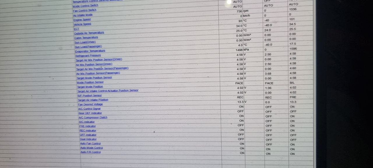

After the trip, I connected scanTool to my car and saw AC parameters, everything checked OK but I noticed something when the car is at idle fans turn on, but not at high speed, only when the refrigerant high side pressure is above 1600kPa fans goes to high speed mode by doing that pressure gos down to 1500kPa and it goes to low speed. When the fans go high cooling on the AC degrades; that's why on the highway AC's cooling performance is worse because it always cools air coming into the AC radiator and cools it down. It's all about pressure.

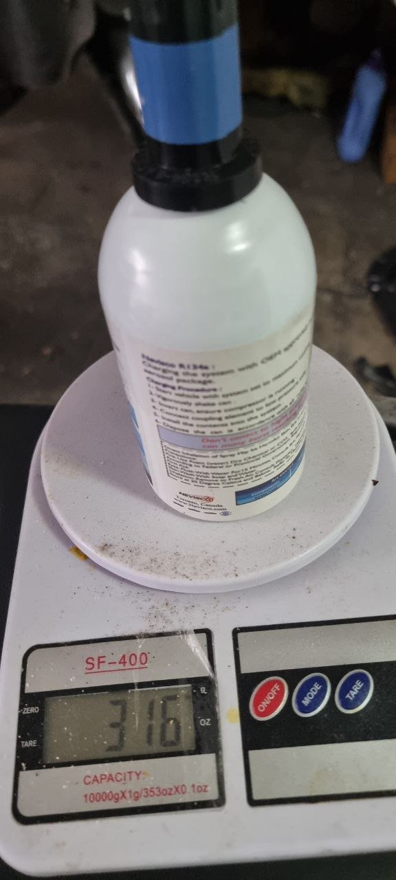

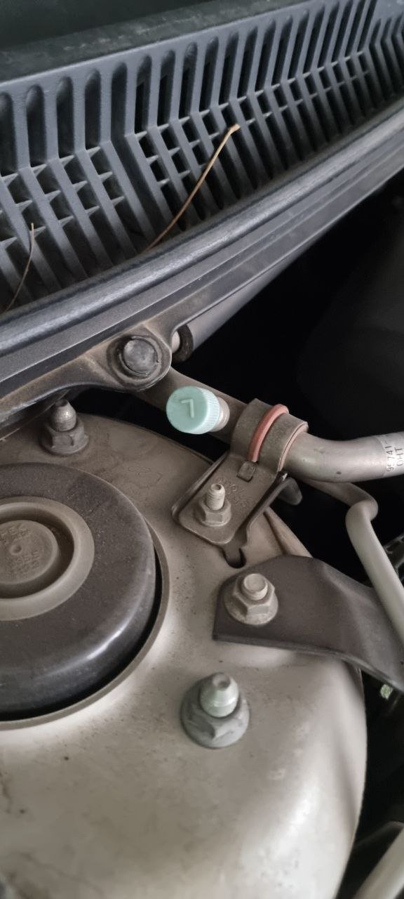

I don't want to go to the shop to fix the AC performance, so I decided to buy a cheap AC refrigerant recharge kit.

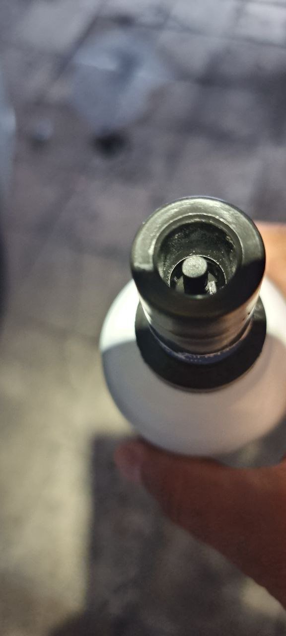

simple instruction to use, but I forgot to read it :facepalm:

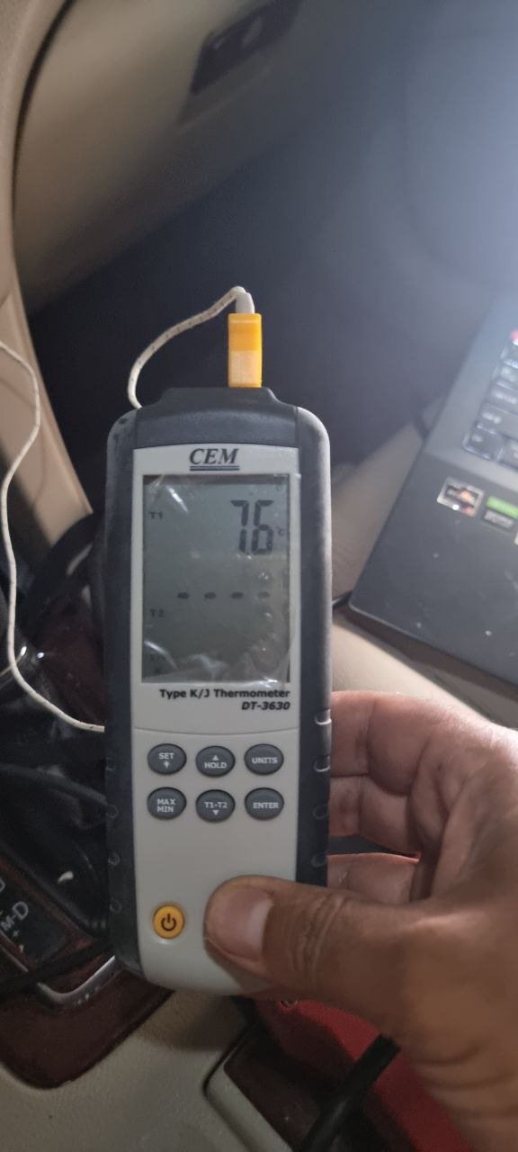

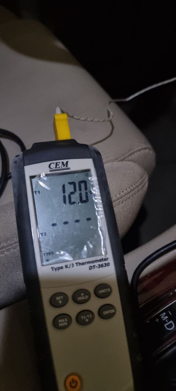

So I wasted a lot of it, but some of this refrigerant went to the system, and it worked, temperature in full blast and lowest temp setting went from 12C to 7C :D
before:
after:

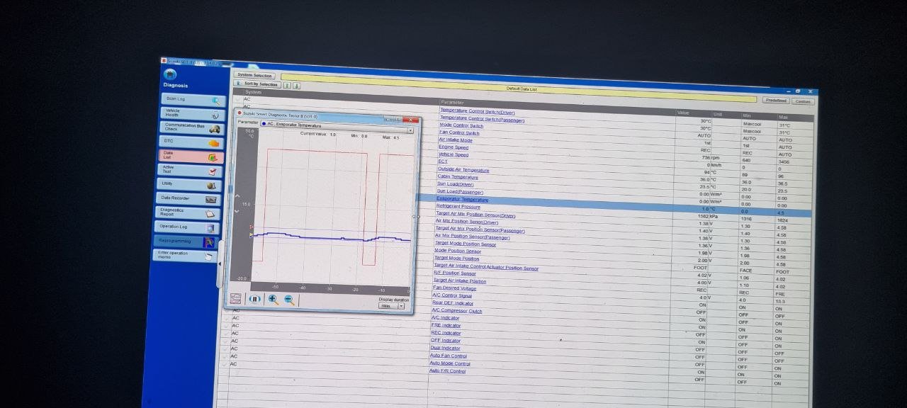

Not much change in refrigerant pressure, but cooler air is coming out of the vents. Interesting, but how?

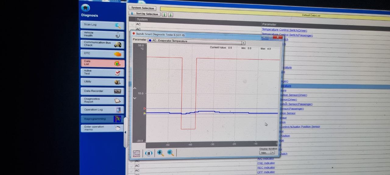

Another observation is "Evaporator temperature." This parameter, at first, was 4C always after charging, but it became somewhere between 0~4C. Turns out this temperature is the parameter that controls the AC clutch. When below 1 °C compressor clutch is disengaged, and when it goes above 1°C, the clutch turns on again.
I am not an expert in the AC car system, but in my car 95% of times compresure clutch is engaged (when AC on) I do not know this is normal operation of car or not but by adding some refrigent to my car I get 5C better cooling and that's enough for now. This was my experience with the Kizashi AC system.
