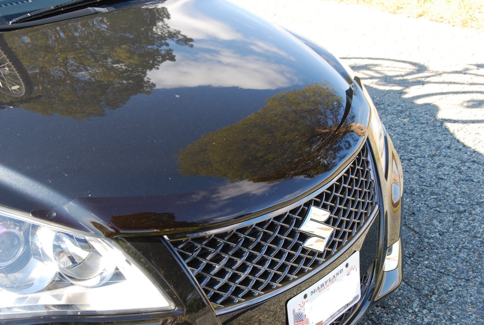

The Hood deflector appears to be of good quality and is a dark tinted plastic. It installed with some difficulty in aligning the screw plugs to the holes under the hood. It also required two large bumpons to be stuck on the hood under the deflector on each side. The deflector came with them. The instructions state to remove 4 of the plastic rivets holding the front rubber seal under the hood. It says to remove them and keep them, but they did not come off easily unless broken off. All but one were broken in the removal. It does not concern me because the plastic rivets are replaced by screws that screw the deflector to the underside of the hood. The hood deflector was made in Australia.

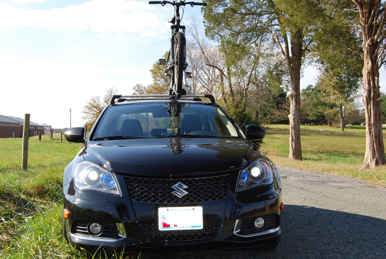

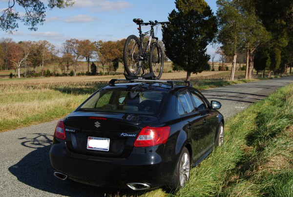

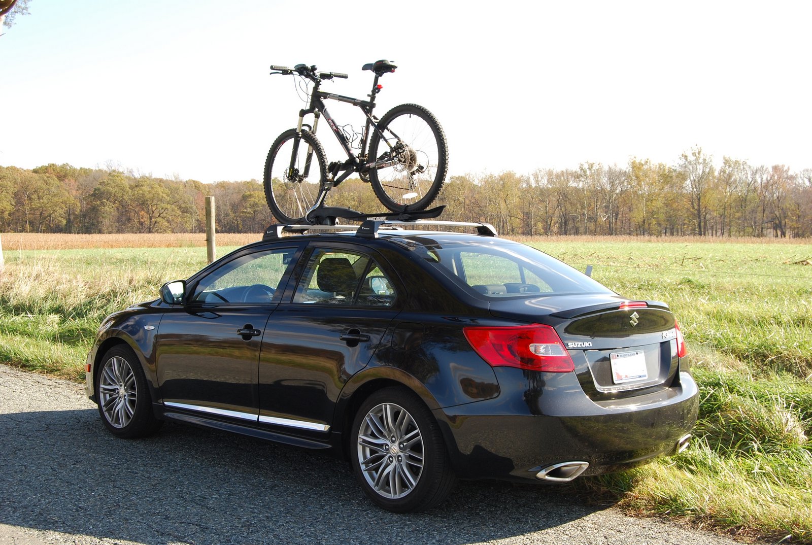

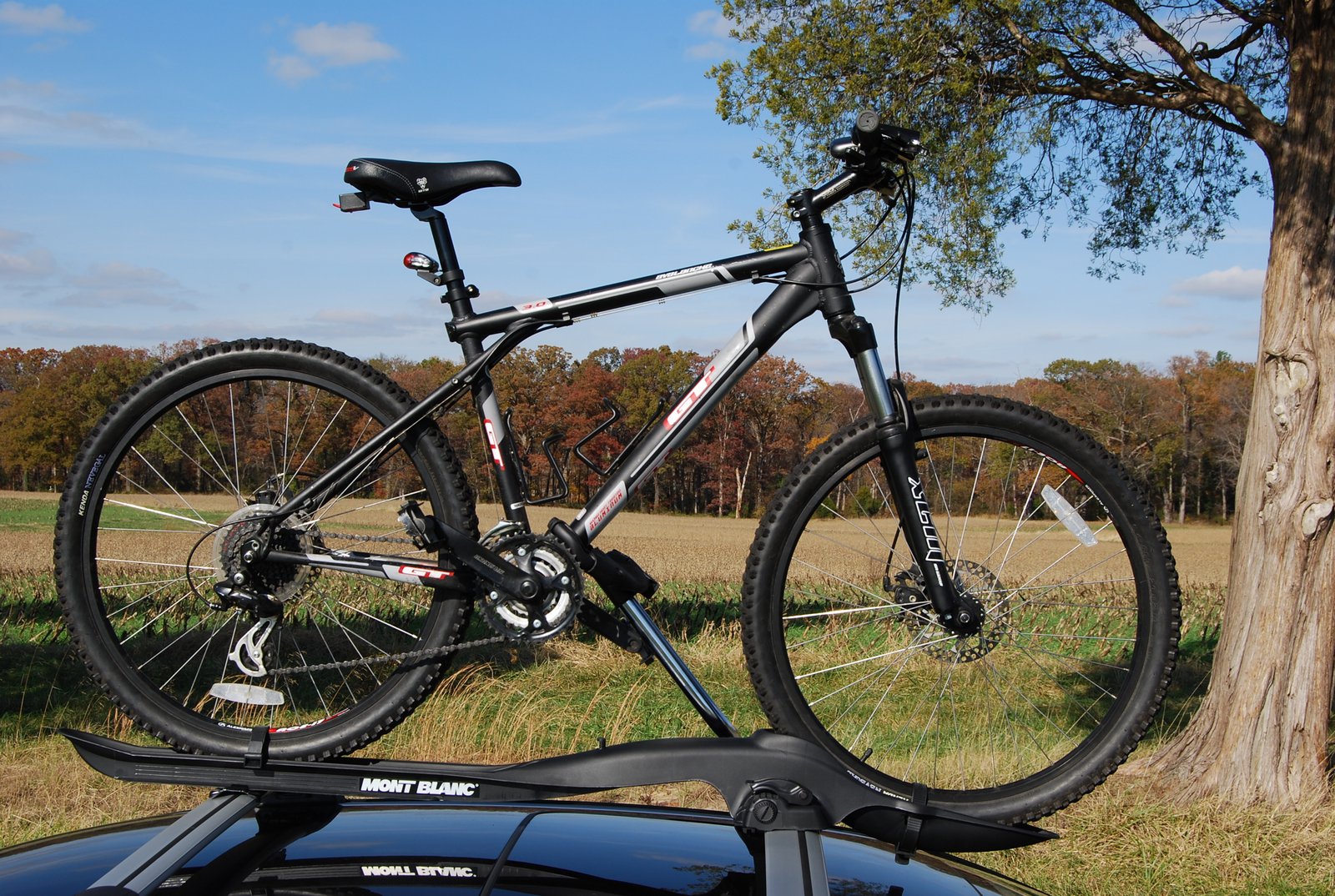

I finally got everything installed to test out and I also took pictures. I must say the Mont Blanc bike rack is very nice and keeps the bicycle pretty stable. It is rated to 75 mph. The installation of the bike module is quite easy as you just slide the ends of the mounting bolts into the slot in the roof racks. 2 bolts up front, one in rear. You then clamp down the levers.
Installing the bike onto the bike module was easier than I thought it would be. The front wheel cradle of the bike module is rather deep and will stabilize the bike nicely while you get everything clamped and strapped down. Once the locking arm lever is in place and locked, the bike was held nice and snug. Overall, I must say it's a really nice set up. The Mont Blanc bike rack system can allow multiple bikes to be mounted side by side (one bike module needed per bike).
I drove out to the country side to test the stability of the bike module with the bike on it. I also listened for excessive noise. It is definitely noisy with the wind resistance on the bike and bike rack, but only if you have the moon roof completely open. Otherwise, the noise isn't that intrusive, especially over music.
There is also enough clearance to fully use the moon roof with the bike module installed. I am not sure, but I think a moon roof deflector may not be compatible with the roof rack bars as the front one runs right across the front of the moon roof.
The pictures include all three Suzuki accessories installed: the hood deflector, the roof rack, and the bike module. I did not get a chance to clean the car before the photos so it's a little dirty.

The hood deflector on a black car is rather subtle. The spots on my hood are not paint chips. My car is just dirty. You can also see the clear bumpons under the corners of the hood deflector. They keep the deflector from touching the hood under wind resistance.

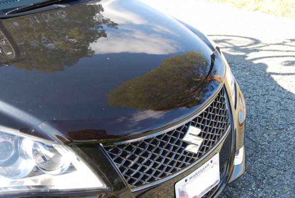

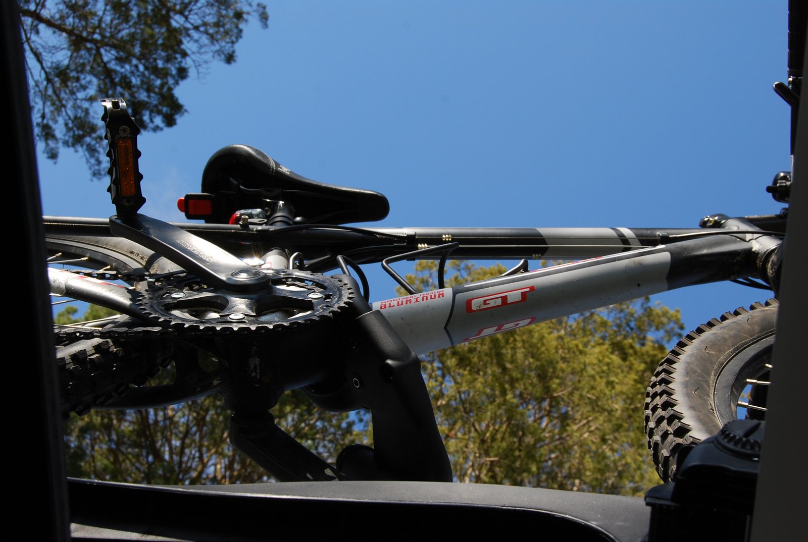

This is a view from inside of the car through the open moon roof. The grey thing in the right of the photo is the front roof rack bar.

Hey KuroNekko, great photos. I think the whole package looks pretty nice. Thanks for the insight.

Quick question for you KuroNekko, did you replace your high beam or DRL bulb??
It looks blueish.....
Posts: 5277
Northernstar wrote:Quick question for you KuroNekko, did you replace your high beam or DRL bulb??
I bought the car used with 7500 miles on it. The previous owner installed HID lows, HID fogs, and had these blue bulbs installed for the high beams. The high beams are used as DRLs at a low wattage. The tiny bulbs in the headlight housing are the parking lights, but not DRLs.
So, yes, there are blue aftermarket bulbs for the high beams, but I did not install them.
In fact, I dislike them. I was never a fan of overly blue bulbs and the color they emit. It's like a darkened white trying to match HID color temp but nowhere near the output. Light emitted is way lower than stock bulbs. In fact, the high beam performance from these bulbs is pathetic. Nearly useless over my HIDs which are 6000k.
