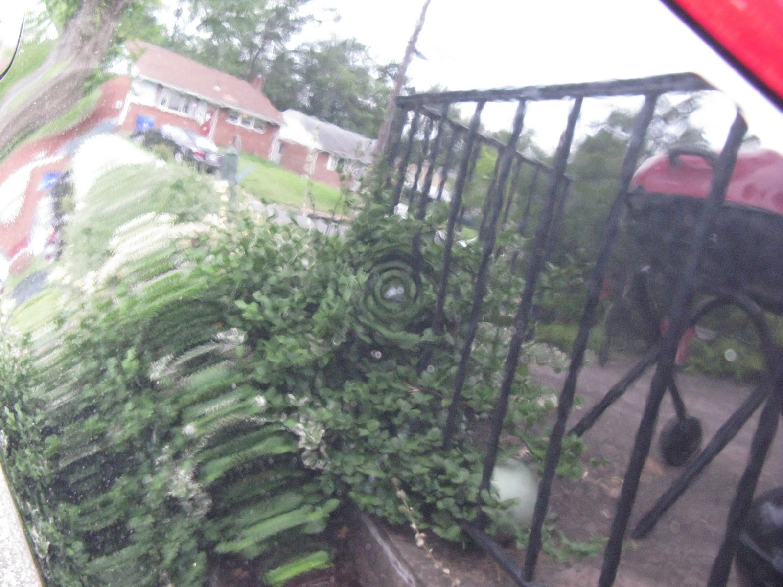

Dent on rear driver side fender: Can be easily removed by paint-less dent removal. I was quoted $75 to 100 depending on how hard it is to remove and whether the tech has to remove tail light.

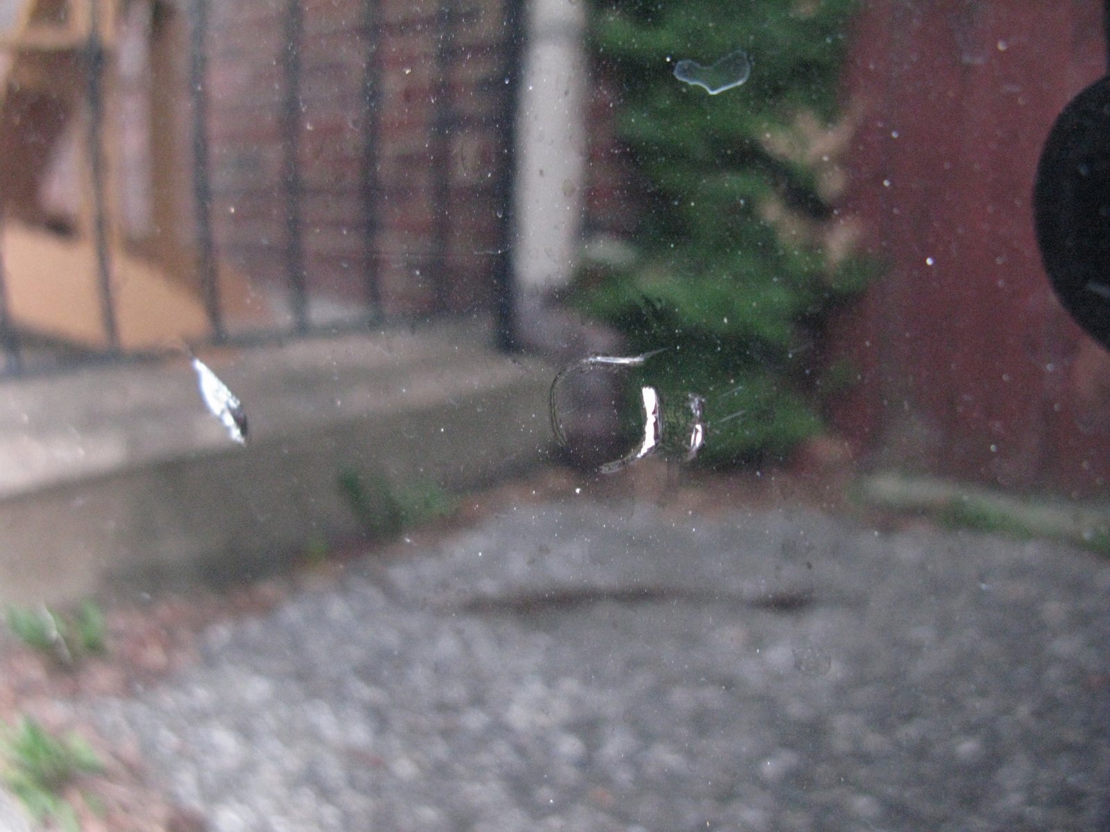

Scratches on bumper: Best to just use touch up paint. Pros can't do easy patch work because to make it look good, the paint on entire bumper needs to match therefore the whole bumper needs to be removed and repainted. Roughly $350 to cover up small nicks that are bound to happen again. Not a good deal. Best to just cover up with touch-up paint.
Note: I find that the Kizashi's bumper is extra bad at parking nicks. These are caused by the license plate mounting bolts of other cars that contact your bumper as they are the foremost objects mounted on the front of most cars. They basically dig into your bumper and cause these nicks when the other car's bumper taps yours during parallel parking. The Kizashi appears to have some white-colored paint undercoat on the bumper that makes these nicks very noticeable. Far worse than other cars I have owned.

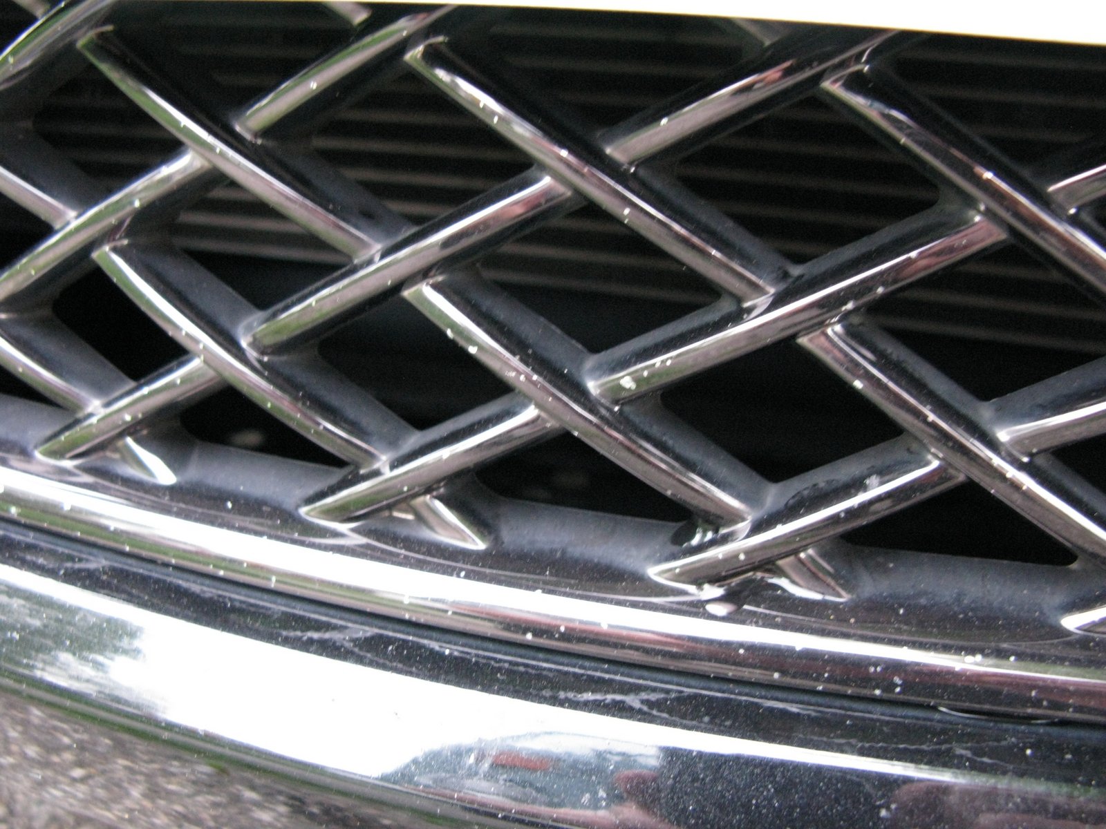

Nicks on front lower grill: Repaint once it gets bad. This one is unavoidable and is probably caused from road debris, bugs, etc. I just wonder how easy it's going to be to get this blacken chrome kind of paint to match the upper grill.

Paintless dent repair is great unless it's on a body line, such as over the rear wheel, like the one I have. It's very irritating to look at all the time. It's right there to admire while I fill it with fuel.
