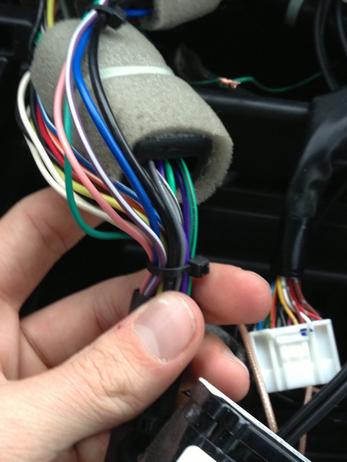

Is this the green wire?

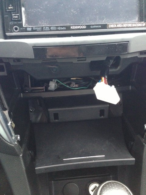

or 1 of these?

Not sure by looking at your pic's but the green wire should go nowhere. You can ground it to any body part or tie it into the black ground wire.Your green wire should say park brake ( tag) somewhere on it.
